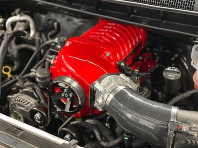

"The tune provided with the kit will work for stock or catback only applications, other modifications such as larger throttle bodies, headers, off-road midpipes, etc. will require custom dyno tuning done locally."
What is this fuck3ry....how is this possible with GM locking the computer?

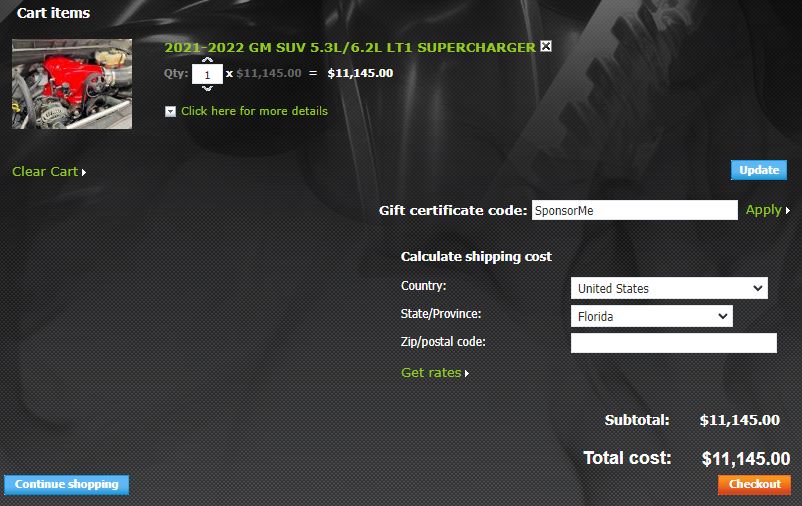

11k for 150hp....and with the possible lifter issue...seems risky imo.
CMoore711
Jul 18, 2017
1,586
1,525
$3,000 to crack the ECU?!?! $11K is a lot of coin for only 150 HP.
