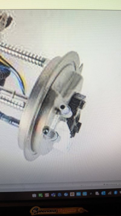

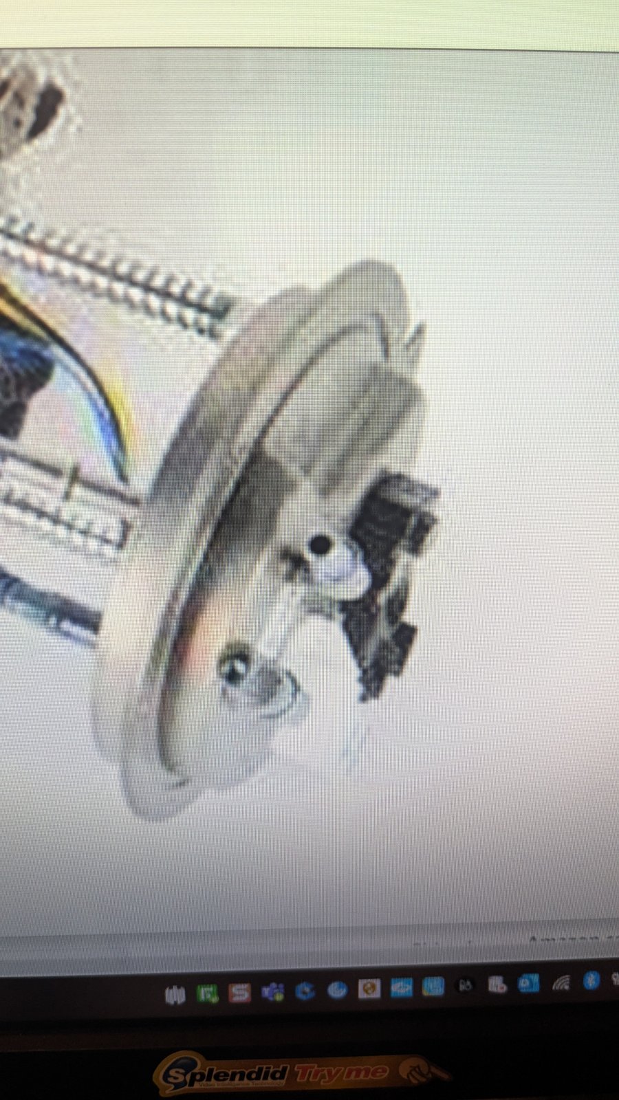

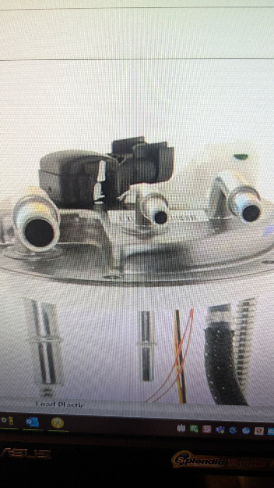

I have a 2008 5.3 Flex and need to replace the fuel pump assembly. When looking up the AC Delco part for my engine I get 2 different parts depending on where I look(Autozone, Napa, Advance, RockAuto, etc). One has 3 lines(MU2159) coming out and the other has 2 (MU1711). I'd like to figure out exactly which one I need before actually dropping the tank. Any help would be appreciated.

Would be good to confirm on the ACDelco catalog and a GM parts website, but what I see on Rock Auto is that the 'gas' pump has three lines but the Flex Fuel one has only two. I would think you need the MU1711.
You could also try using an inspection camera (endoscope) to look at your current pump.
