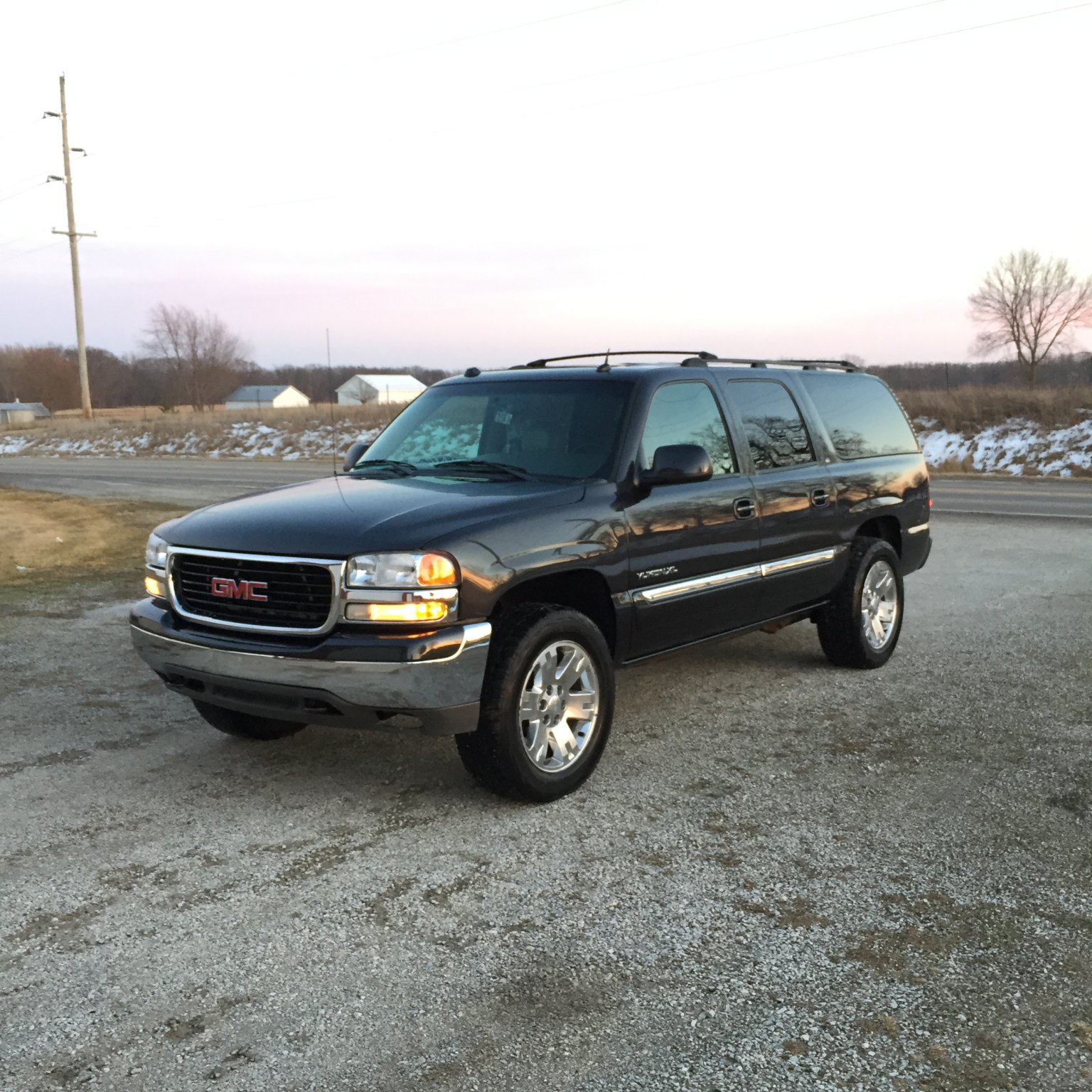

I'm running 1.5" spacers on my Yukon and did not have to trim the studs. My wheels have little pockets on the back of the wheel for the protruding studs to stick into. I know not all wheels have this though. 1.5" sit perfect IMO

Countryboy07 that's deadly!!! What you are doing is allowing the weight of the truck to sit on the studs not the hub. Eventually the stud will break off and the wheel will fly off! Pull your wheels off now and you may notice the studs break while removing them. You don't want even a sheet of paper to slide between the hub and the wheel. Imo from my experience its mandatory to grind the studs for 1.5. You will be sorry if not.

He is fine. His alum wheels have recessed pockets between the holes. So it will allow the stud so sit in those pockets and the wheel is flush withe the spacer.

Actually it's not... The spacer bolts to the studs on the vehicle and has its own studs that the wheel bolts to. The spacer is both hub centric and wheel centric, the weight of the vehicle is still on the vehicles hub. And you are correct, in most cases with a 1.5" spacer you'll need to trim the studs. But on my particular wheels, there is space for them to sit in thus no need to trim.
