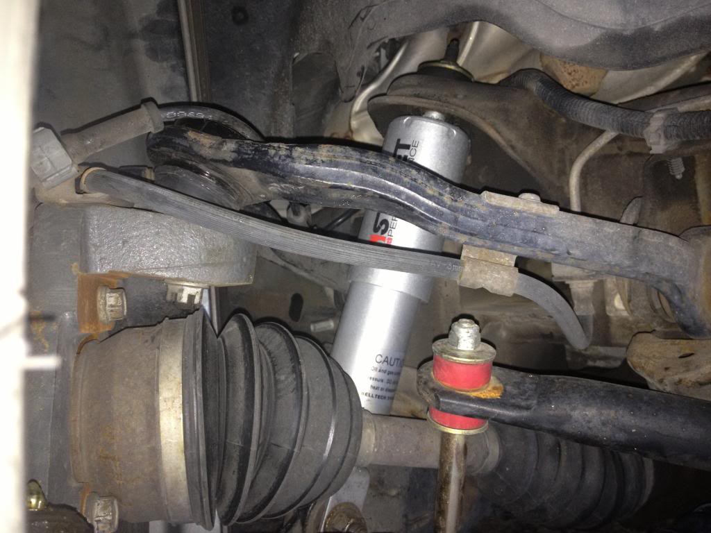

My new mod got decided for me today when I tried to have it aligned after changing ball joints and tie rods. It's pretty much maxed out so looks like I'm gonna have to try to get the djm control arms. $70 turned into $320 real fast.

You should try the alignment bushings. I got a set and they worked great for my 5" drop up front.

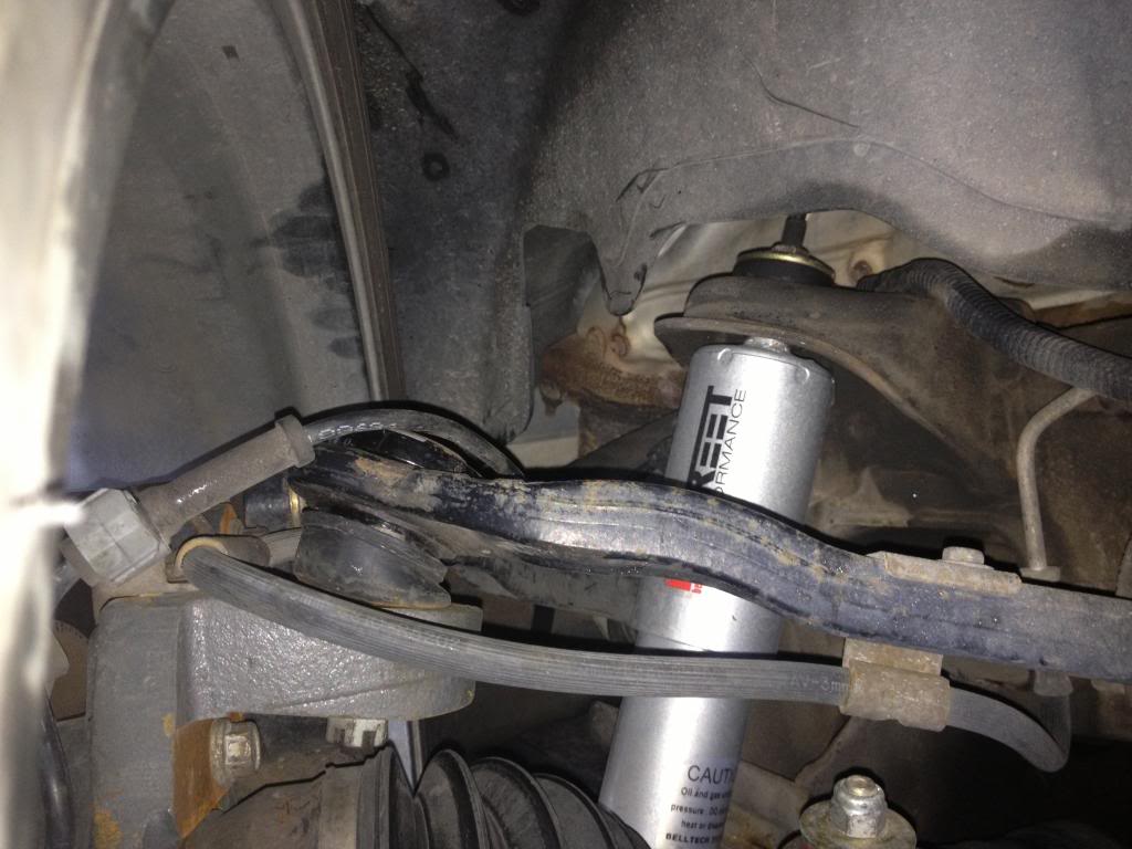

photobucket.com/user/boozers1/media/image_zpse358e694.jpg.html]
[/URL]. photobucket.com/user/boozers1/media/image_zps5137a081.jpg.html]
[/URL]
Pretty good angle, any help would be appreciated!

The offset bushings will decrease that angle a lot! Not bad for $40ish and the cost of pressing them in.

Thanks Alex I will get them ASAP and hope it helps. They are over 2 degrees off each side

It could decrease that angle depending on how you pressed them in.

Can you explain that a little please
He's saying that because they are offset you can press them in to increase or decrease the angle.
