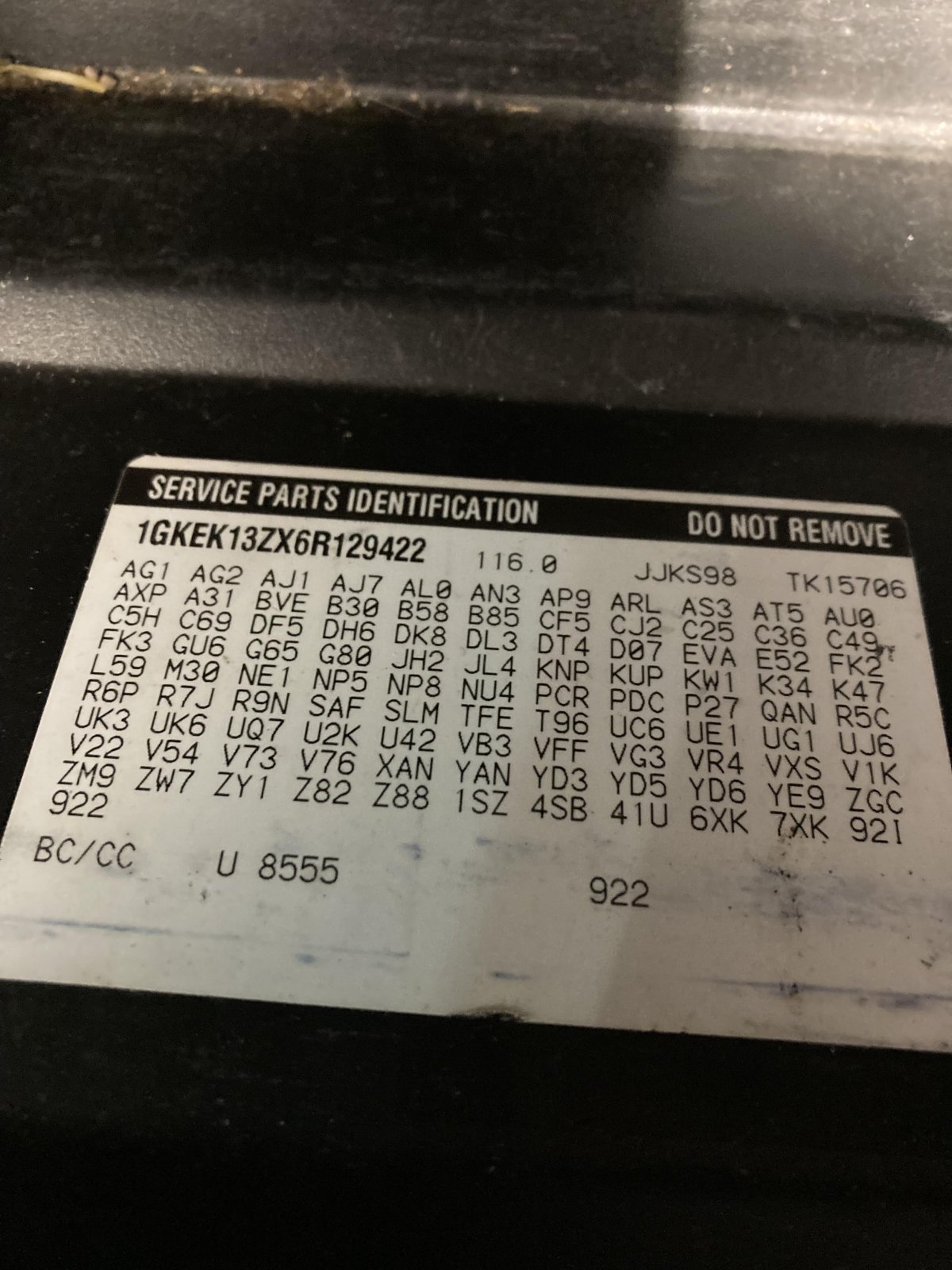

You will need to compare your RPO codes in the glove box to the actuator you need. There are at least 2 different climate controls in this generation and actuators for each (I assume).

ive googled how to choose the correct one and im not getting much info....heres my rpo codes how do you tell which model number i need to order
