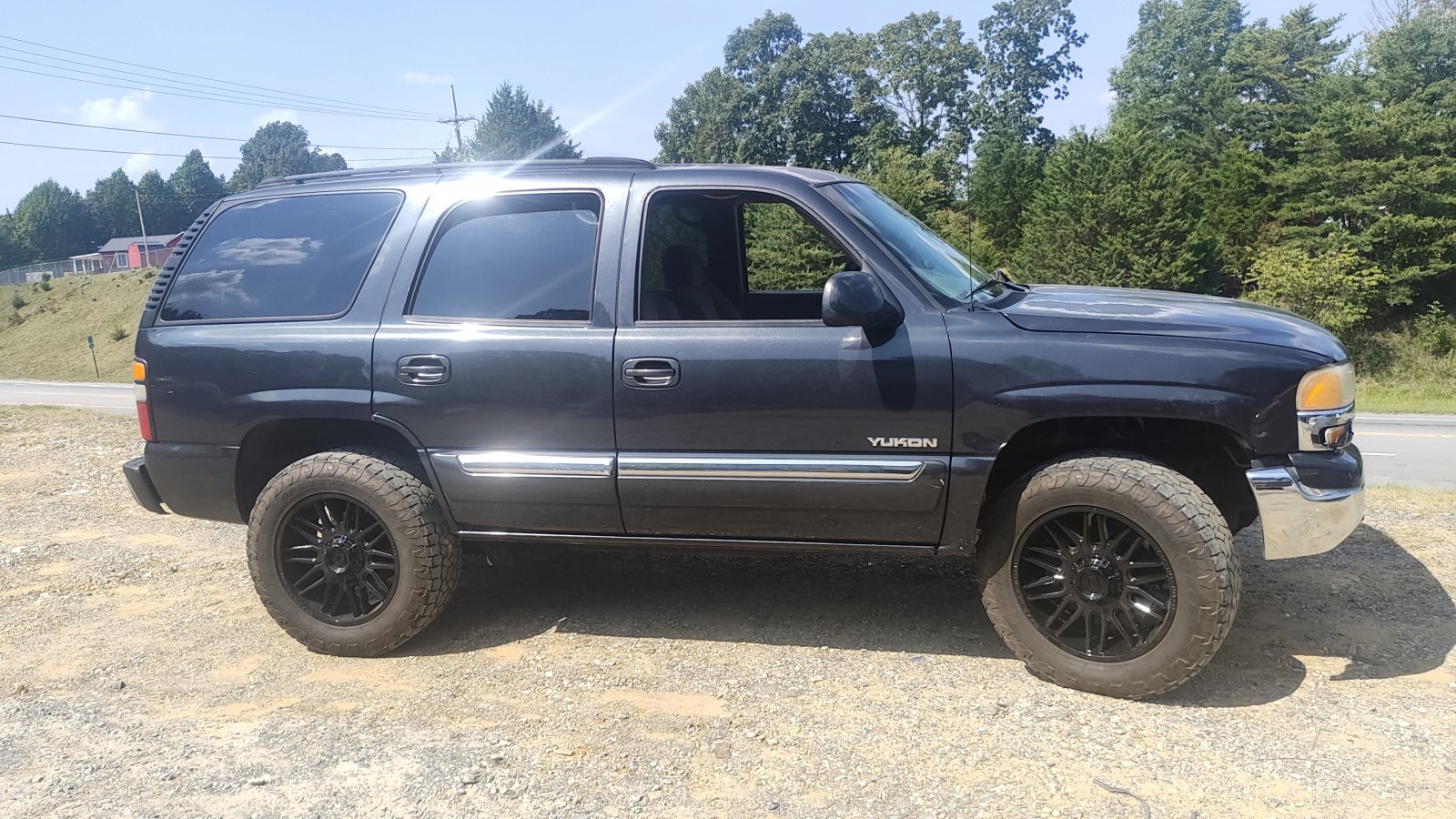

Somebody please help me figure out exactly what size tire I'm running I understand I'm running a 265 70 20 but measuring it with the tape measure from the ground to the top of the tire is apparently not the correct way to find tire size so somebody could please enlighten me on whether I have a 32 33 or 34 in tire I would greatly appreciate it! If I can't figure it out I'm going to sell these bad boys for some stocks LOL

Does this look familiar?
If you prefer a comparison:
265/70R17 is your OE tire size, which is 31.61" tall.
265/70R20 is 3 inches taller than that = 34.61" tall.
Wow... Okay, I get it now. I didn't realize the truck had 31s on it to begin with. Thank you for the info though man really I'm new to the whole lifted trucks and big tires sorta thing. Im definitely loving it though.
