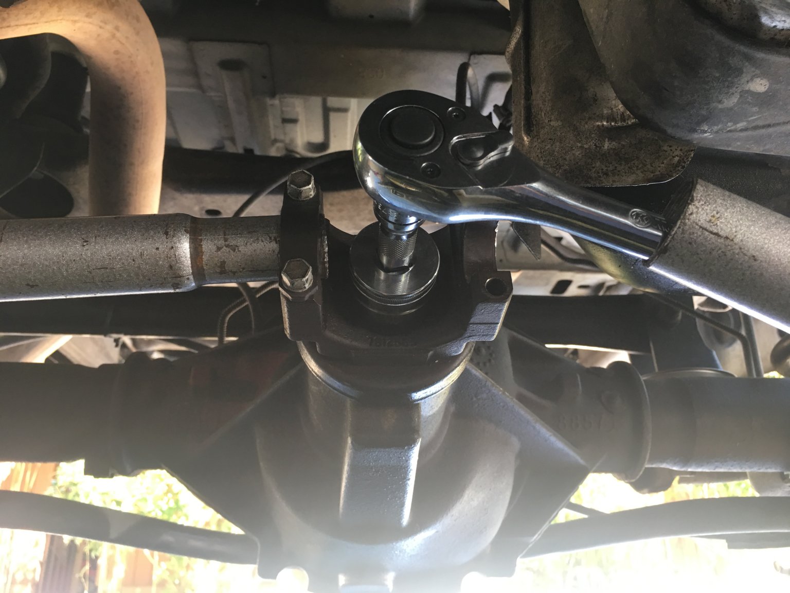

I found 4.30s on car Id that I think would be good with 33s. I'm going to try to do it myself this fall
Yeah you should be plenty good with that set up. It's not a difficult task to do. The hardest part is getting the old bearing off the pinion and differential carrier but all that is is just a lil work with a cuttin and a tap with a chisel. Pops them right off.
Once you do it, you'll be kickin yourself for not doin it sooner! Ha.

The only thing stopping me is backlash and pinion depth since special tools are needed and I don't want to buy them for a one time use. Reason I want to wait till the fall is because I graduate from highschool this year and I'm going to a 2 year technical college for diesel technology and I figure the school has the special tools. I'll also be learning more about this stuff obviously so it should be easier for me, and I could get help from my teacher if I need it
Completely understand man. The pinion shims on your stock pinion will be the shims you want to match new shims to. The shims on the pinion are for that specific differential housing not the actual pinion. Example, if we were to swap pinions, the shims that are with my setup have to stay with my setup. I would put my current pinion shims on the pinion I was getting from you. Same with the differential carrier shims. So technically, in theory, you can regear your rear end without a pinion depth gauge or dial indicator but it's good practice to double check and reverify that everything is still within the specs. I hope I wrote that in a way that makes sense.

Yeah did it in my driveway. Not only does it save you a ton of money but its more gratifying when it's all said and done doing the work yourself.

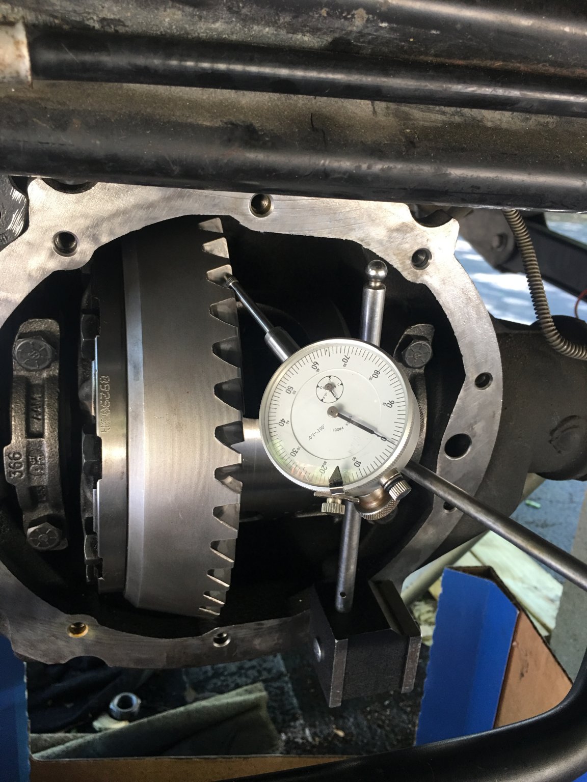

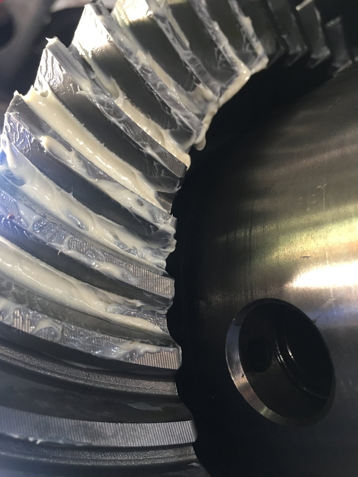

When you used the same shims, was the backlash the same or did you have to adjust it
I didn't measure the backlash before I removed anything but the specifications for backlash falls between .003-.010 (preferred is .005-.007). After the new crush sleeve was preloaded and the diff carrier was shimmed and torqued down my backlash reading was .0056 which you really can't get anymore perfect than that. Once I got those readings I verified the gear teeth contact with marking compound and it was perfectly centered on the convex and concave sides of the ring gear. The factory shim measurements held true and I haven't had any issues.
