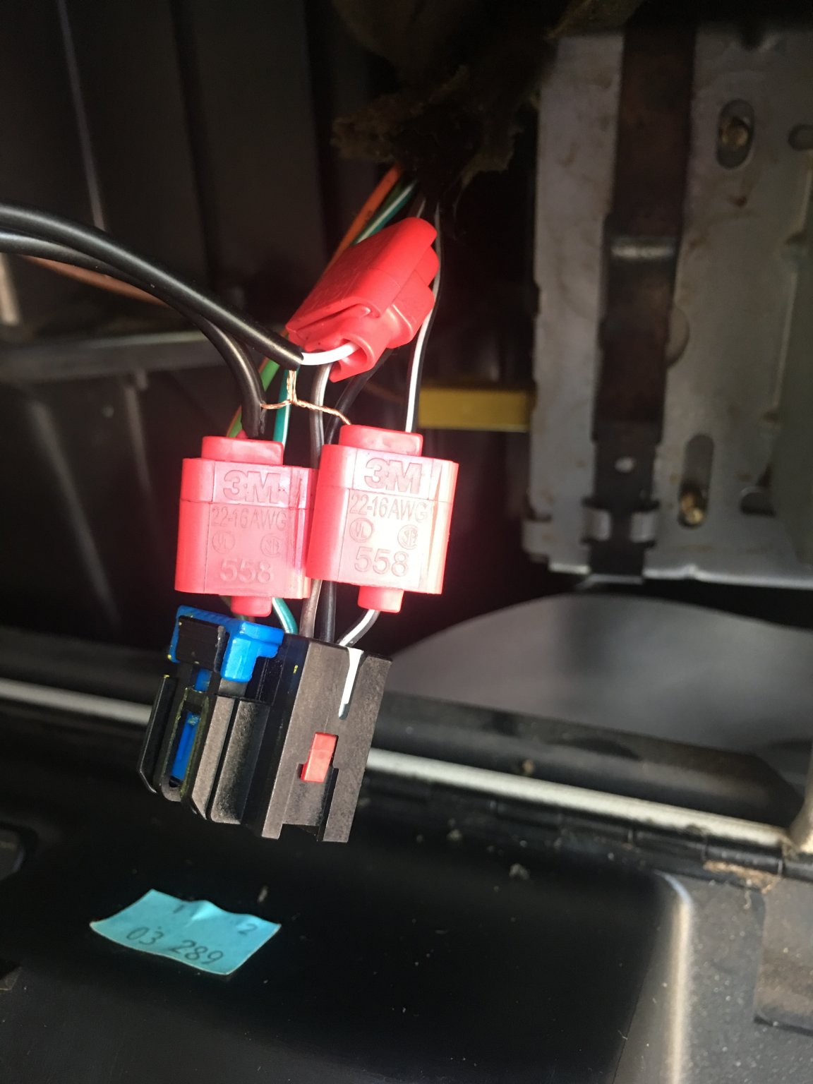

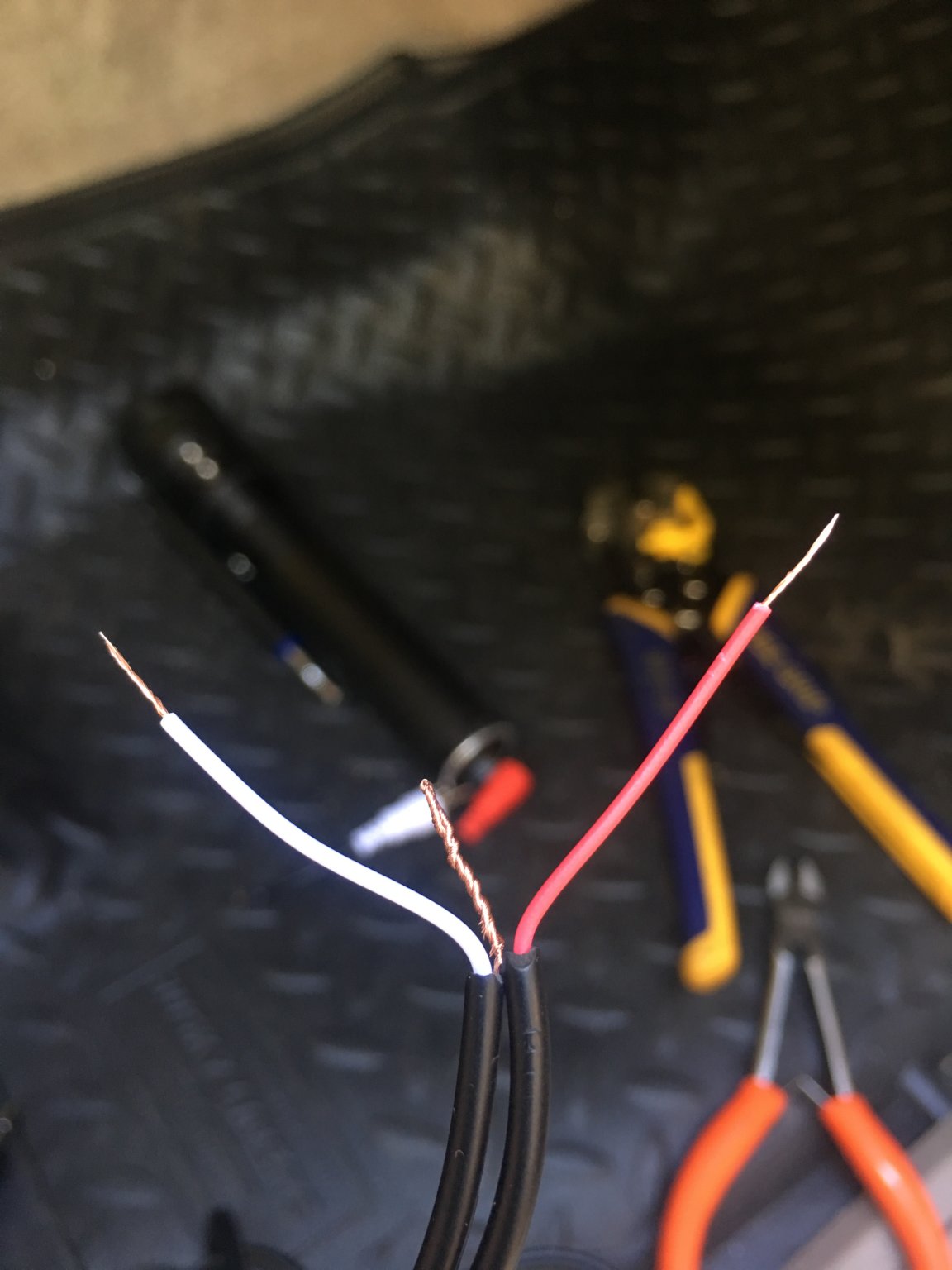

This isn't anything new but I went with a different approach today...
XM auxiliary jack mod.
Instead of using a head phone jack and then having to use a intermediate cable with two male ends I cut out the middle man.
Here's the route I chose to take...
This is the ONLY material I needed minus the tap connectors.
Cut each end connector off and then twisted both of the ground wires together for a common ground.
Use the same ol tap connectors for the speaker wires and the ground
Plugged it back in and dunzo funzo.
I know the mod is a century old but just threw my own twist on it.

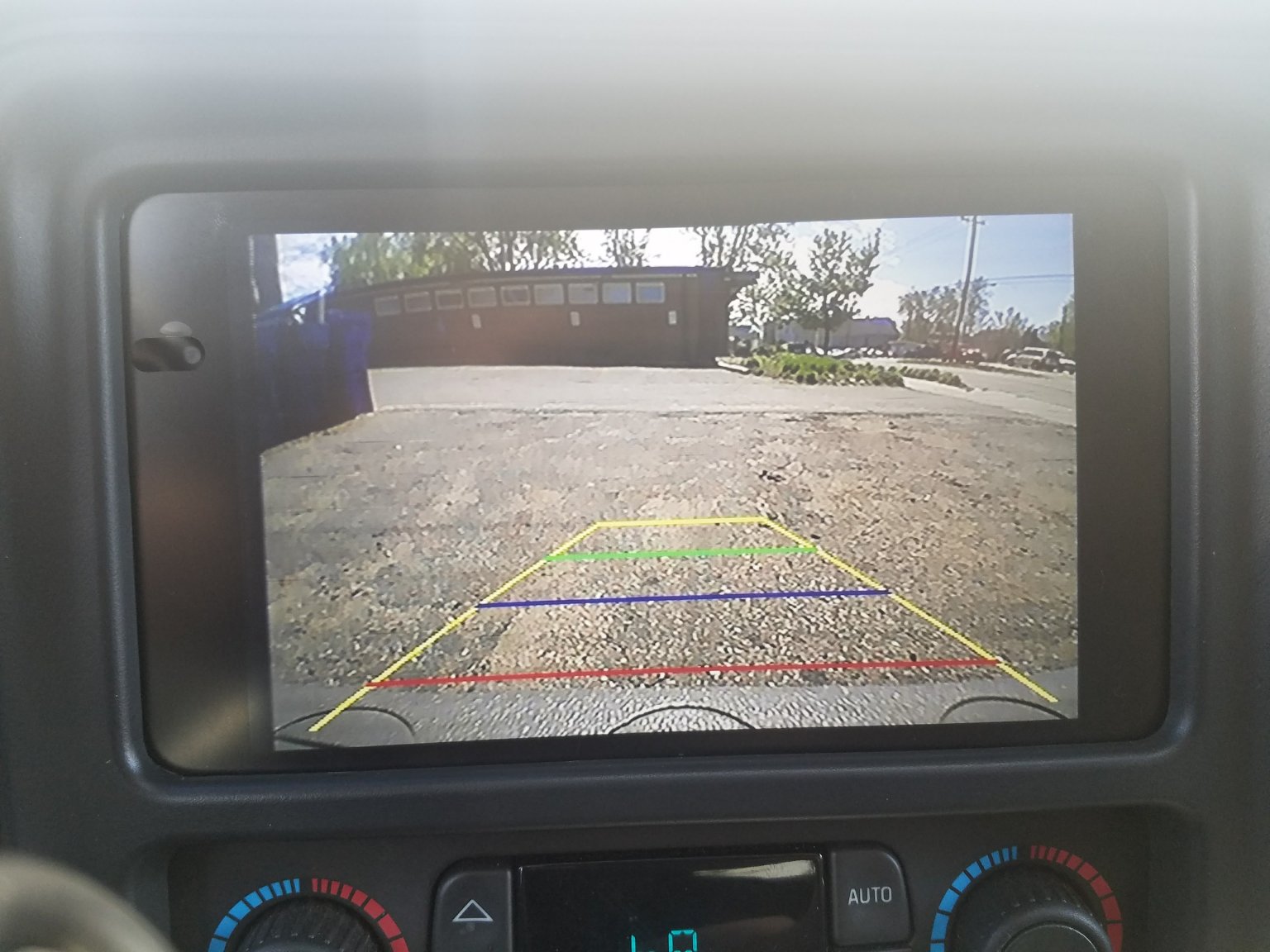

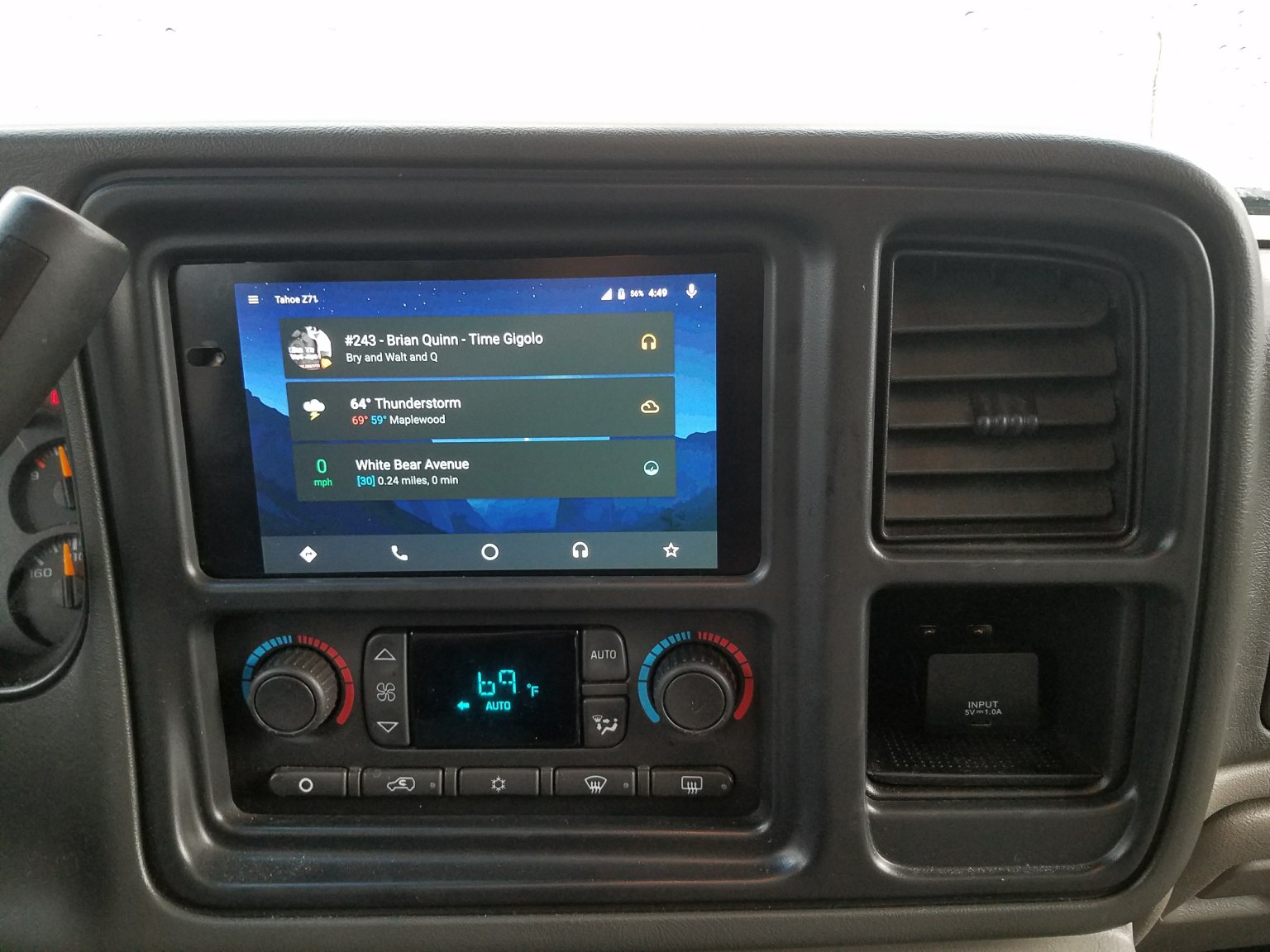

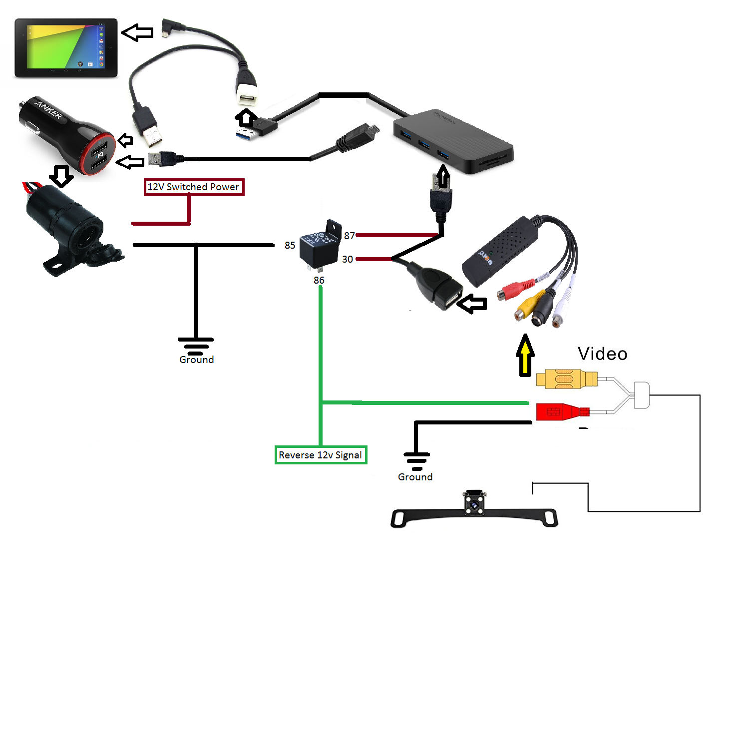

Which tablet ?
It is a Nexus 7 2013 LTE. I am using a modified kernel called "Timurs Kernel" which is designed for fixed installations in cars/trucks. The tablet will automatically power on with ignition power and go into a low power sleep mode when it loses acc power. other benefits of this kernel is you can charge and use usb host mode (otg) at the same time and otg devices will not draw power from the tablet while in sleep mode. I am using a backup camera connected to a USB capture card which is powered by a relay that turns on when i put it into reverse.

A write up of this would be great! If you have the time....I for one would appreciate it.
I will try to grab pictures of the way i secured it but i wanted to make sure it could be easily removed so i just used velcro on the back of the tablet and attached to the old double din mounting brackets and it keeps it very sturdy. The dash bezel holds it in place and the velcro is just for getting it centered.
Other than the tablet itself and a few micro usb cables here are the parts needed and a half assed paint diagram of how everything is connected.
OTG Y Cable - Allows Charging and USB Host mode. - https://www.amazon.com/gp/product/B00NSBVNCM/ref=oh_aui_detailpage_o04_s00?ie=UTF8&psc=1
USB Hub / SD Card Reader - https://www.amazon.com/gp/product/B01HMD70WS/ref=oh_aui_detailpage_o00_s02?ie=UTF8&psc=1
Capture Card for backup camera - https://www.amazon.com/gp/product/B00WSAWZ1M/ref=oh_aui_detailpage_o00_s01?ie=UTF8&psc=1
Extra Cig lighter socket powered by switched power - https://www.amazon.com/gp/product/B003EET3XY/ref=oh_aui_detailpage_o04_s00?ie=UTF8&psc=1
Dual port charger to power tablet and hub - https://www.amazon.com/gp/product/B00VH84L5E/ref=oh_aui_detailpage_o04_s01?ie=UTF8&psc=1
I also used this to replace one of the factory cigarette lighters so i can have an easy access usb port - https://www.amazon.com/gp/product/B01LX1FT1N/ref=oh_aui_detailpage_o00_s00?ie=UTF8&psc=1
