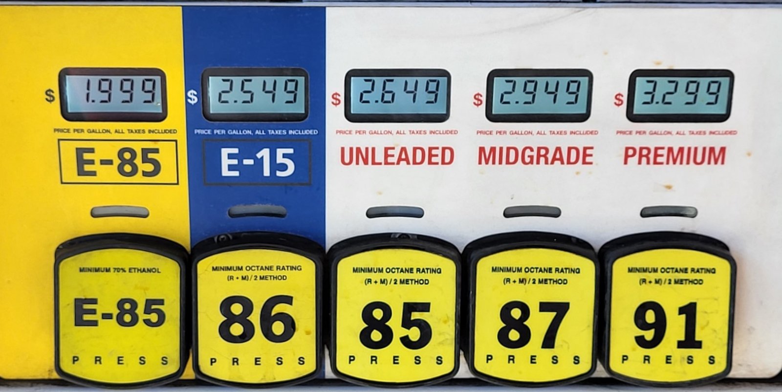

Drove it. Had to swing by the orifice to do some yearend work, then got my ears lowered and ran some other errands. Topped off with E85 on the way home 'cause it's close to work. Last time it got mostly gas so the alcohol content was down to 51%, but this should bring it up a bit. The station I use is very consistent at 70% alcohol at the pump. Nice price differential:
Man, do I miss my corn gas.. I filled up in Dallas while picking up my J / Y trans for the Civic, but wasn’t enough to make much difference. And it was still $2.69 / gal here.. premium (93 octane) is usually $3.29.. ridiculous.

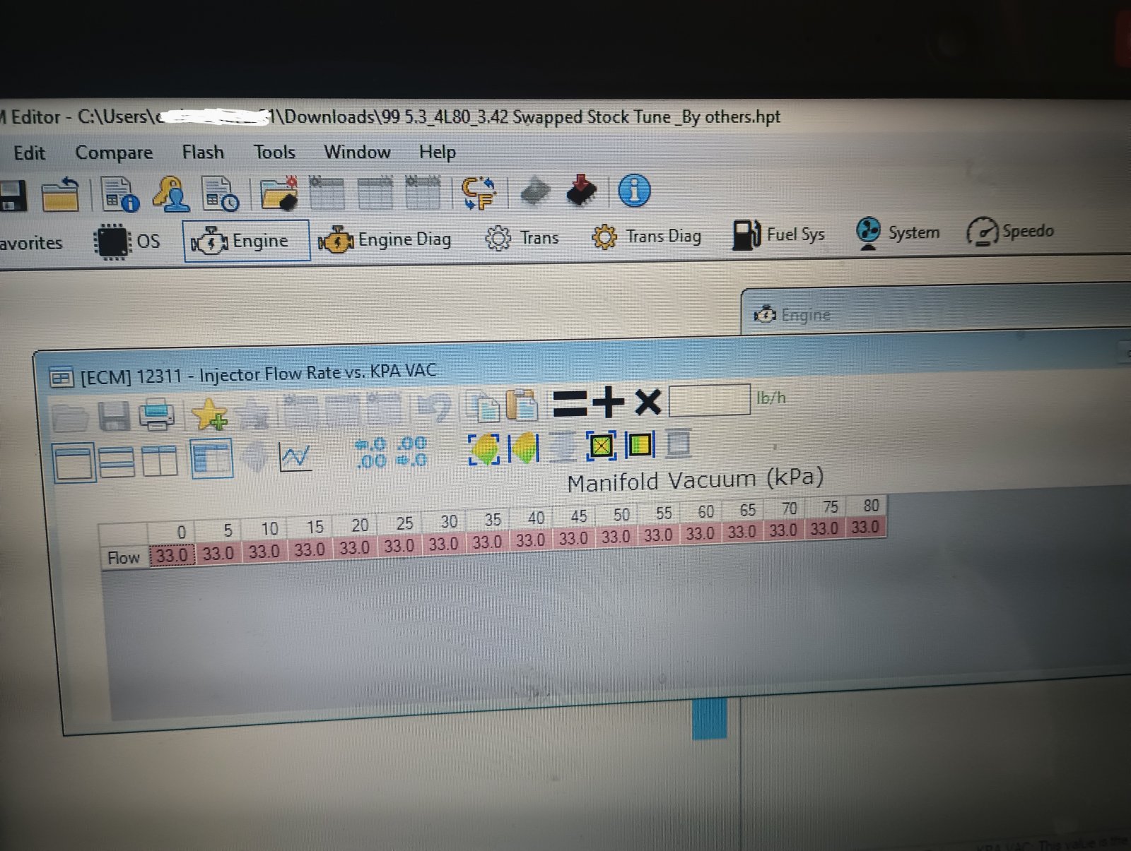

Today I was messing with HP Tuners on my 99 Silverado NBS. I did a V6 to L59 swap like 3 years ago. My ECU came from a 2000 Silverado from the junkyard and was reflashed for my Vin and a 4L80e I also swapped from some guy I found on OfferUp.
Anyways, the truck always ran a bit lean (edit: meant "rich") because the L59 has those flex fuel injectors and have a higher flow rate, but truck still ran okay at like -10% LTFT, within ECU control.
Today I finally decided to tackle it myself. Just changed the flow rate from 24 lb/hr to 33 lb/hr. It was rather easy. Took it for a spin and fuel trims look pretty normal.
Side note: it appears that the tunes with return style setups have a constant flow rate vs MAP values, whereas the later tunes (still GMT 800 Gen III) vary the flow-rate vs MAP values in a somewhat linear relationship.
You can see on this video on the GTO he adjusted.

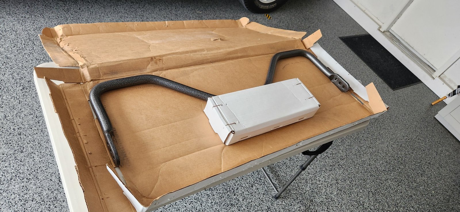

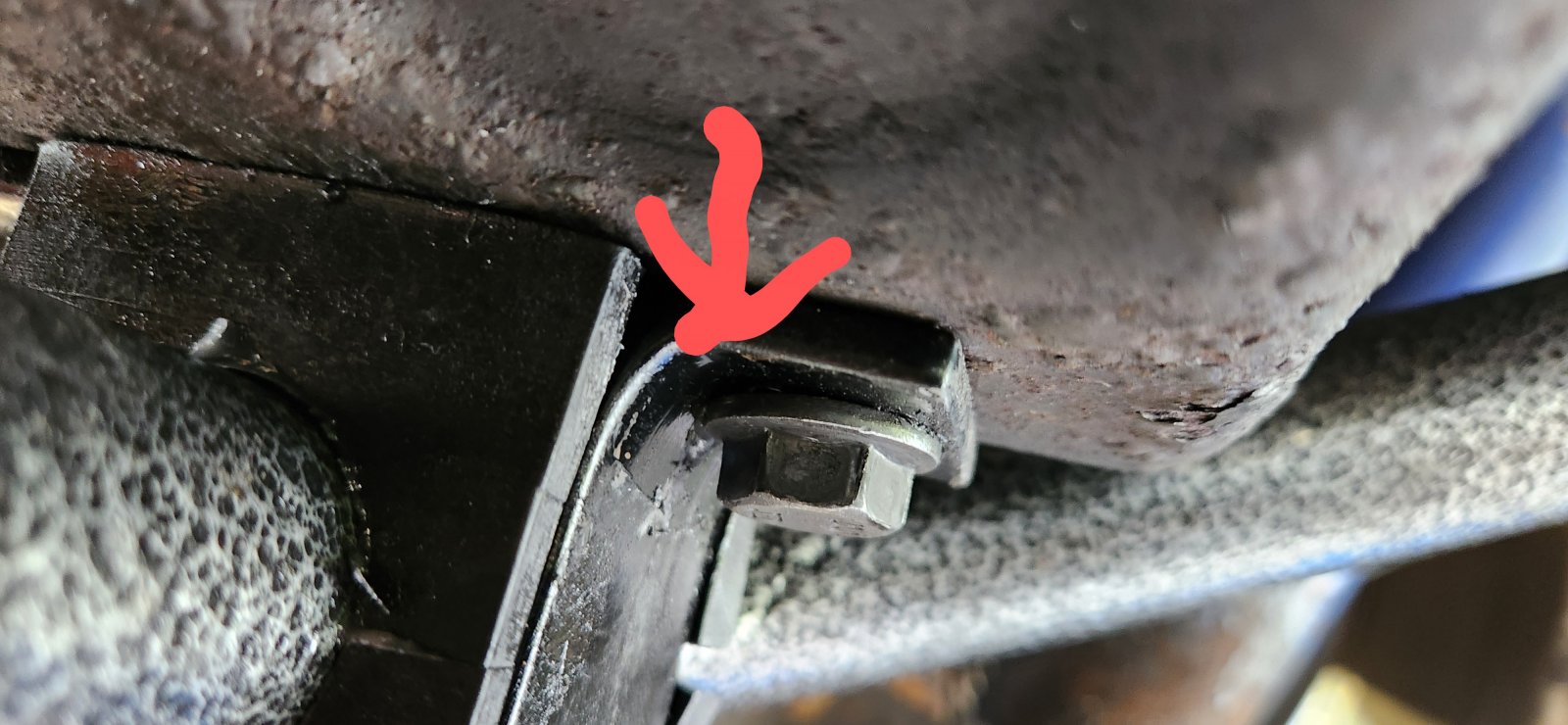

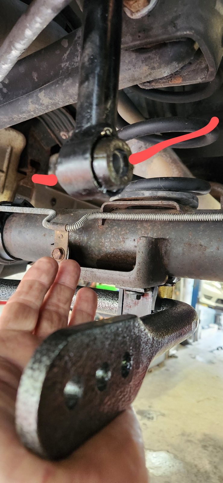

The 'U' plate bolt holes a tad too close, to mount onto the axle, and the bolt head was a tad close to the 'bend'.

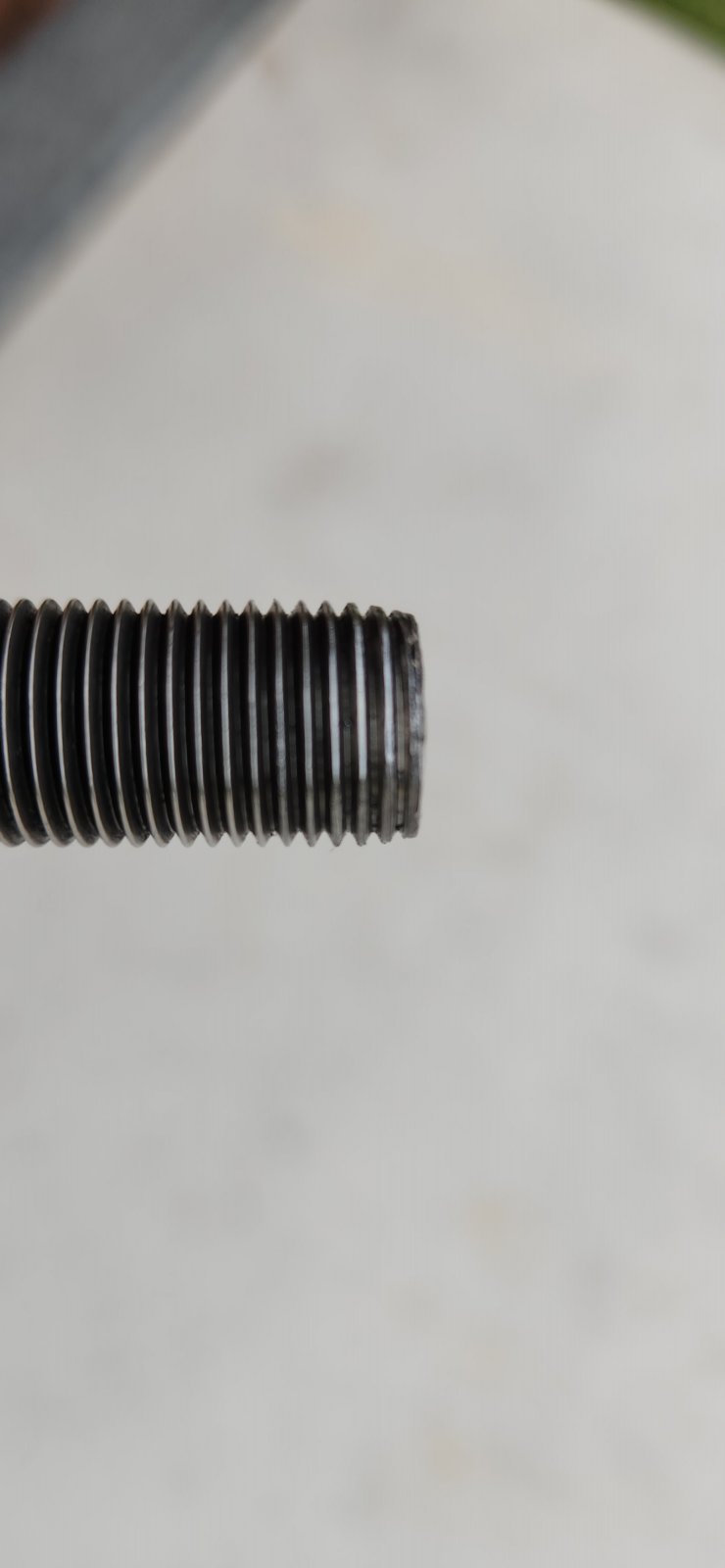

Also, the grade 8 - fine thread bolt, that attaches to the sway bar end, was missing the lock nuts. ( I used temporary bolts, until Hellwig ships the nuts.
Hellwig manufacturers the sway bar, but 'farms-out' the rest of the hardware.

Nope... new bolts a bit larger..also, ..... The axle mount, ( where you install the new 'U' bracket & new bushing for the sway bar ),...... The Hellwig 'U' bracket's 2 holes are a smigin too wide, to easily bolt in. ( I had to use a hammer to reduce the 'spread' of the bolt holes )
But... Hellwig is fast & helpful to send the parts I need.
