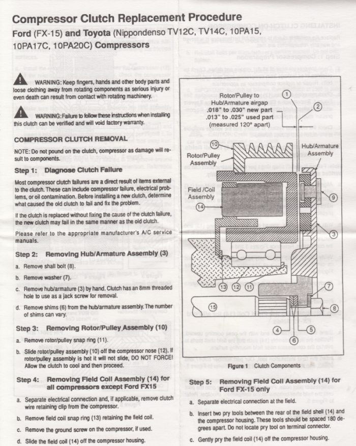

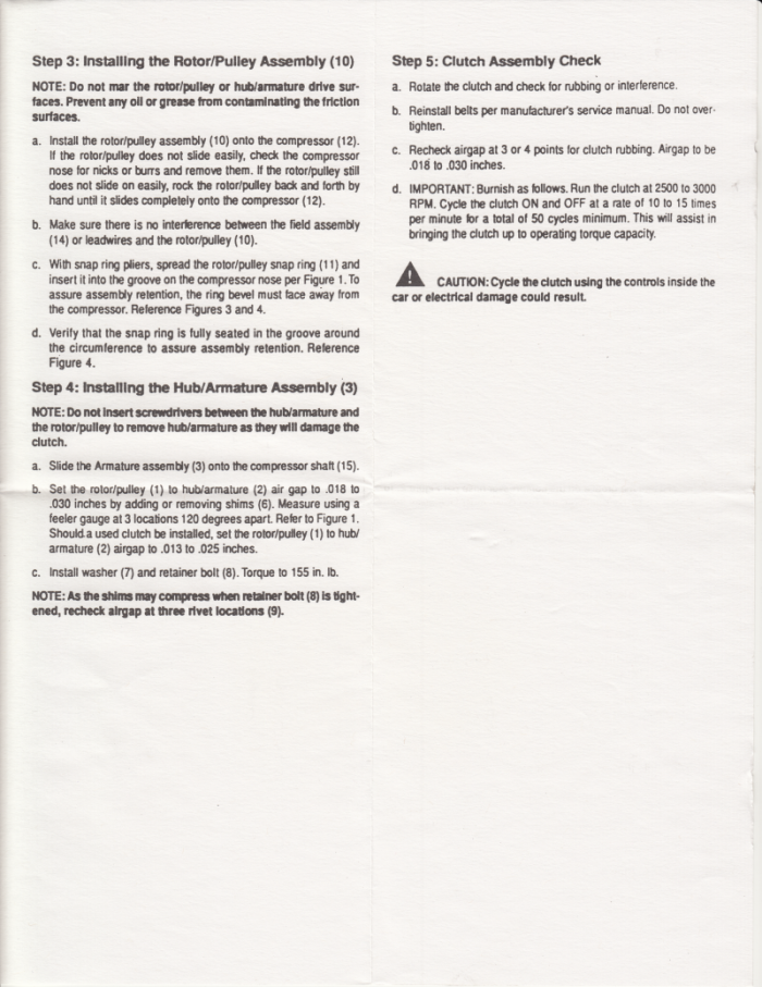

I used two different sized snap ring pliers, no puller required. Here's the replacement instructions:
Thanks again Mike!

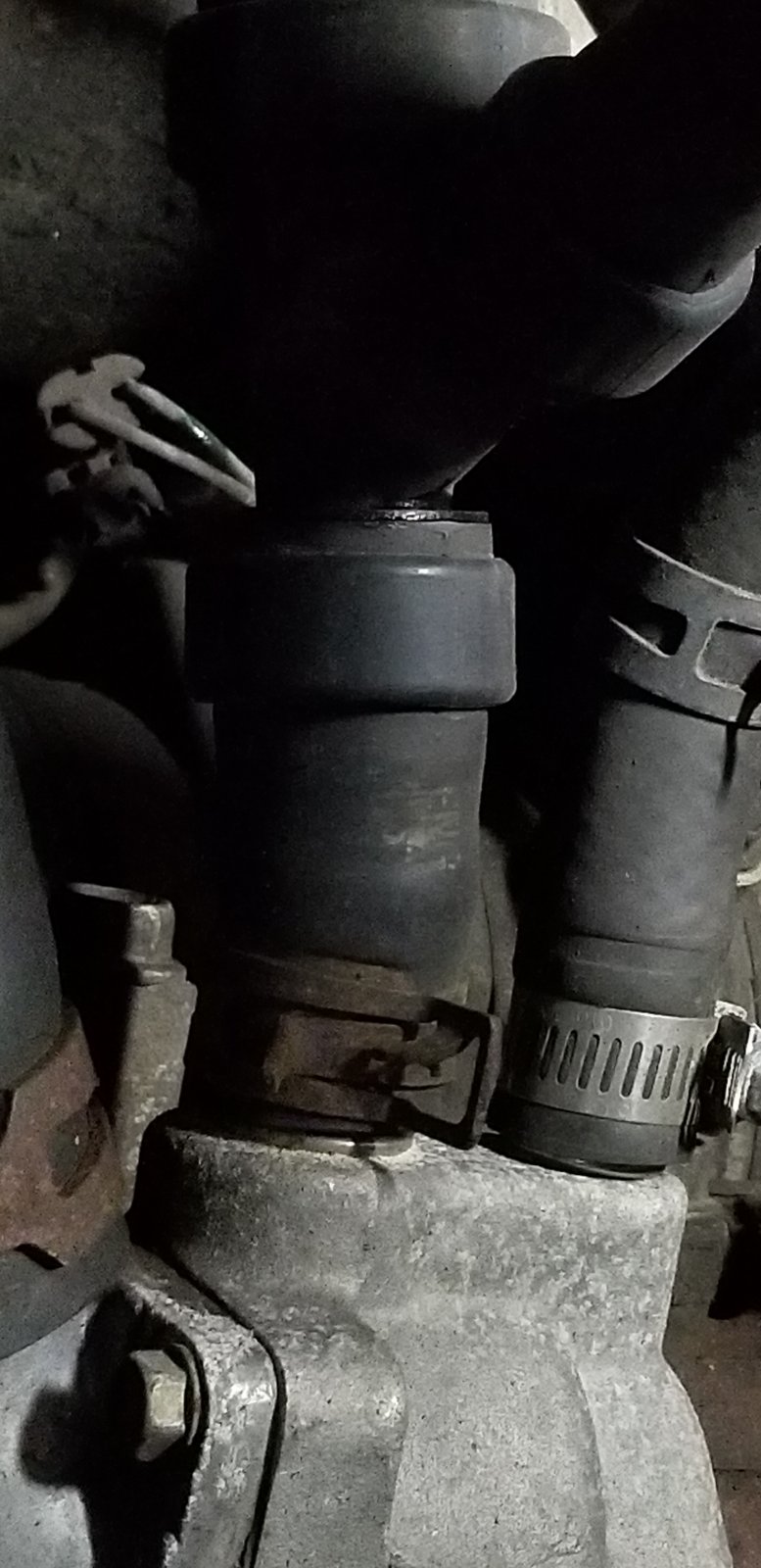

Oh My!Not happy.

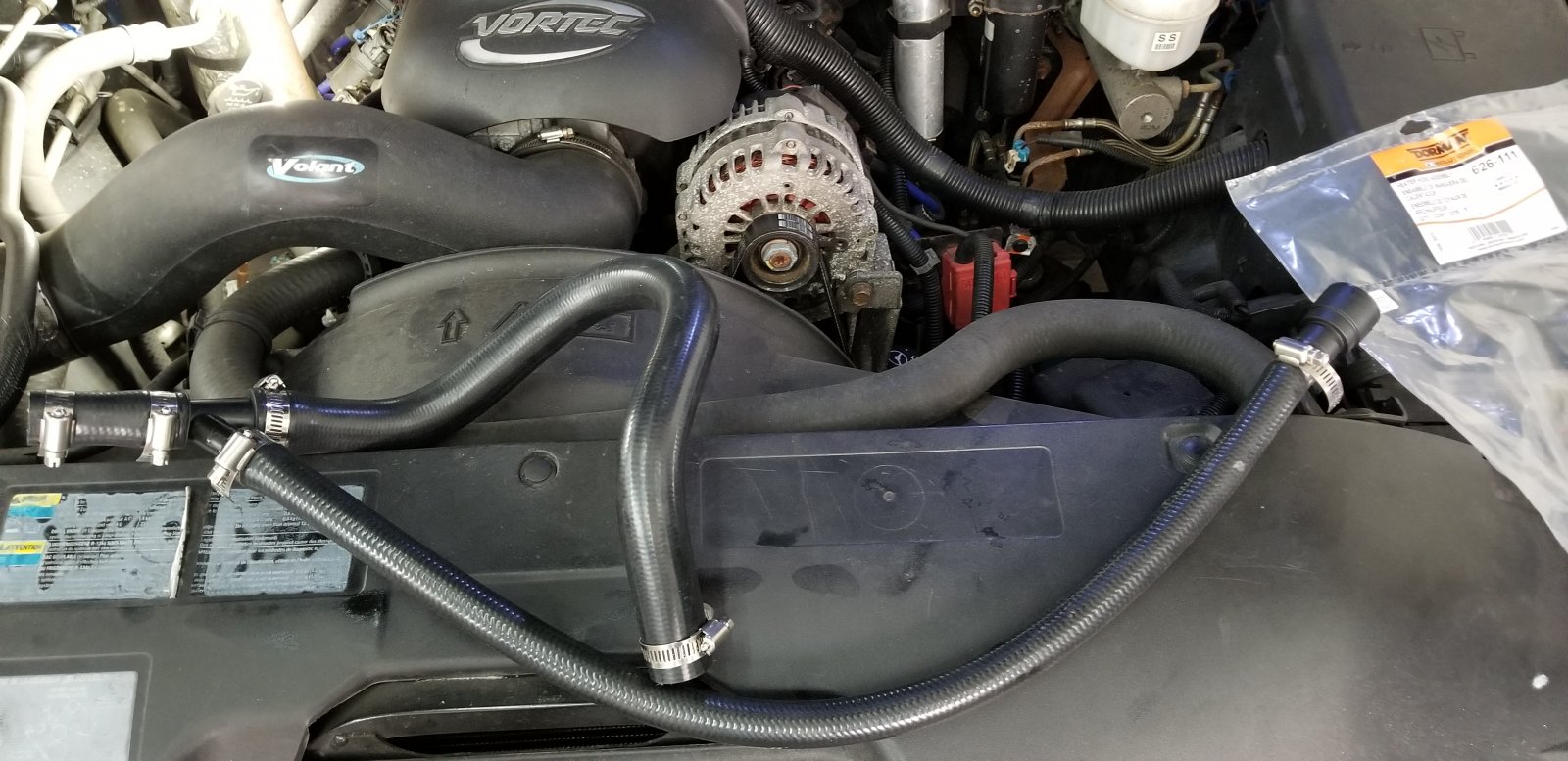

Should go with AC Delco or Gates hoses. Not much more money.Last used compressor lasted 2-3 yrs. Hoping I'll get lucky again.

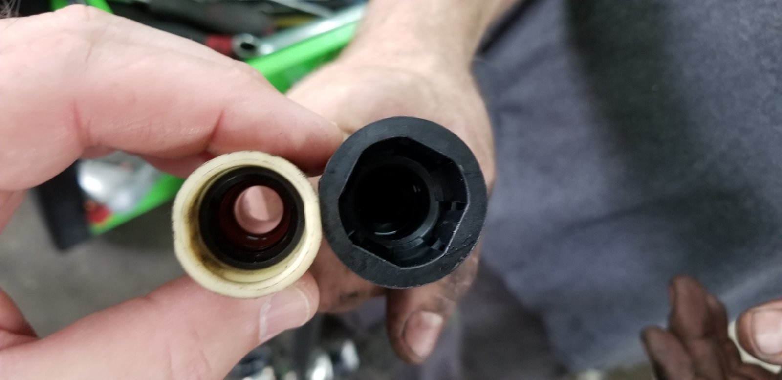

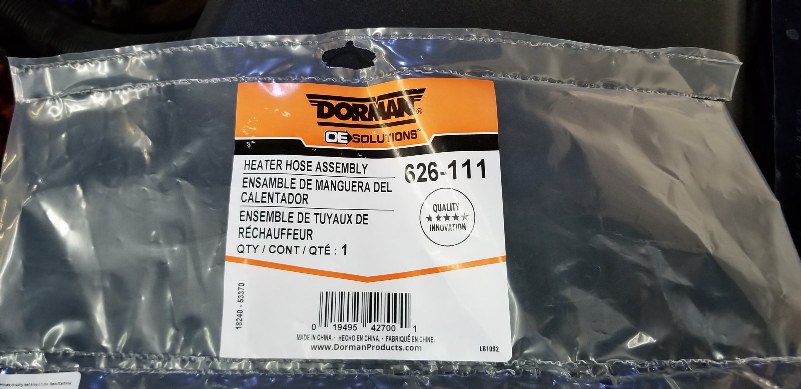

Dorman--View attachment 224428 View attachment 224429
Not happy.
agree, the connectors never seal properly and are very loose. have lots of customers come in to get the tee connectors and straight connectors cause they buy aftermarket and learn from there mistake.Should go with AC Delco or Gates hoses. Not much more money.
Installed and working great.hey @Jeff Groves how did the panel work out for you
that's great, as soon as i saw it i couldn't believe they mad these.Installed and working great.
Had to use the old firewall connector, new one didn't fit.agree, the connectors never seal properly and are very loose. have lots of customers come in to get the tee connectors and straight connectors cause they buy aftermarket and learn from there mistake.
