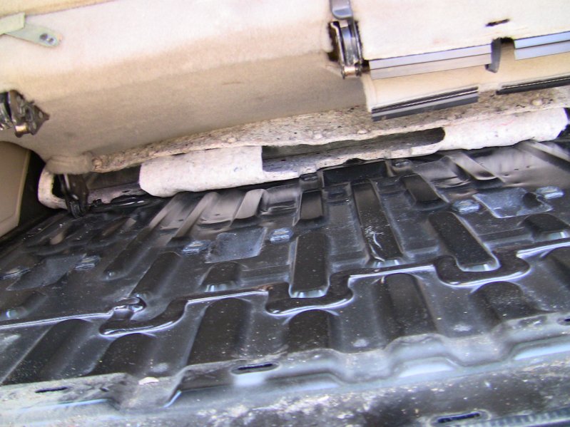

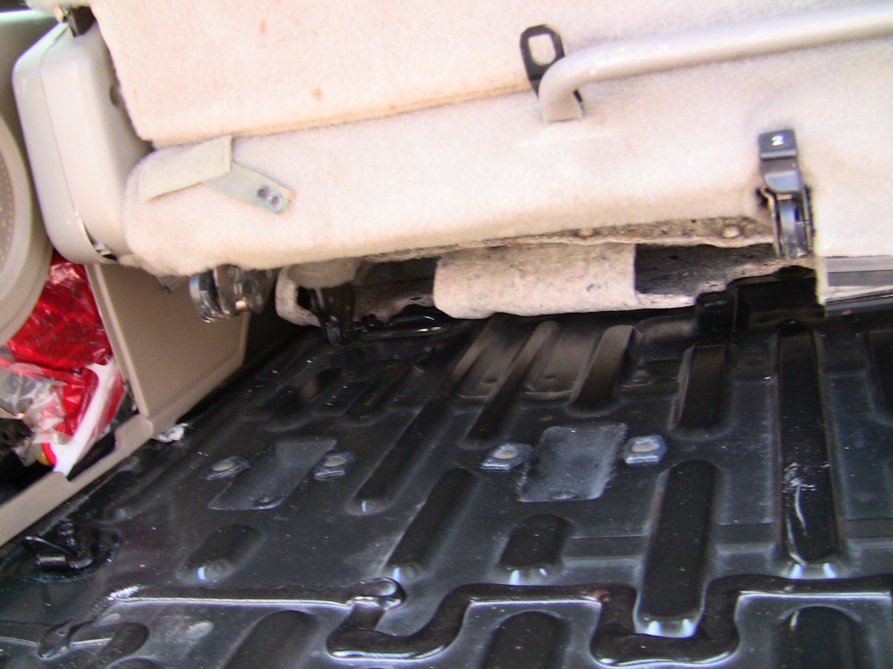

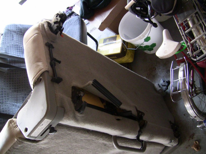

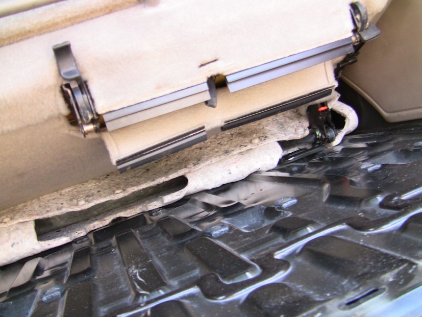

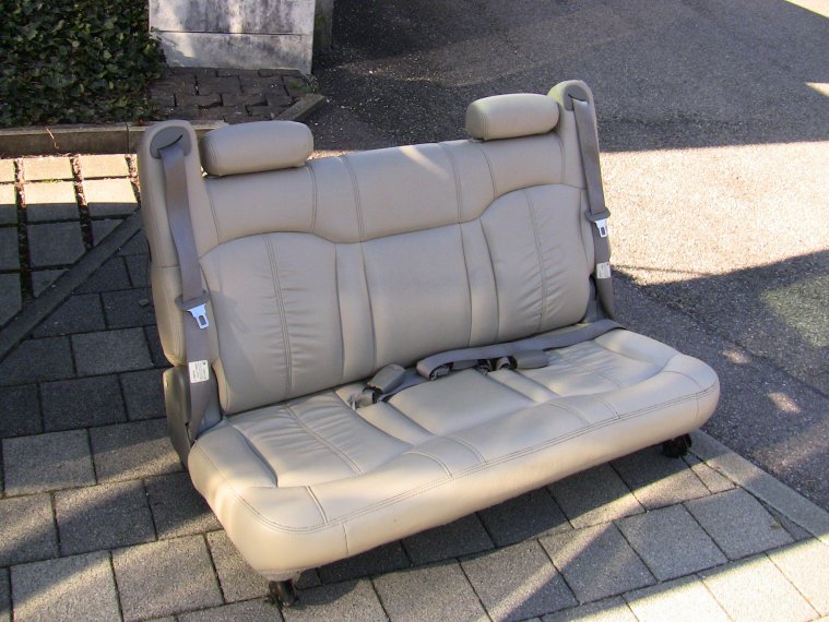

Hello!
I have this 3rd row seat (I hope it is a third row...) and tried to install it in my 2005 Tahoe like here:
https://www.youtube.com/watch?v=2rek18Y3qmk
unfortunately it came out that this seat has only 3 Point where to install the brackets (see pics). Can anyone tell me if there was different mounting Points? Or is this seat from a suburban or other year??? the design Looks like the seats in my 2005 tahoe....
What can I do?

That's a suburban or Yukon XL seat (long wheel base).
Won't work in a Tahoe or Yukon (short wheel base)

These look like the seats out of an 00-02 tahoe. I know the changed the seat material and sew lines in 03-06 maybe that's why it won't fit they may have changed the mounting brackets too.

I "think" the mounting points are the same in 00-02 and 03-06, but the pattern in the leather changed.

Yes this seat is From a long wheel base. The seat from the short wheel base is a split bench so the mounting brackets and and mounting points in the floor are different from where they are for the non split bench from the longer wheel base.

These seats can be used in any tahoe, I installed an suburban non split seat In an tahoe I had few years back, you will have to move rear bracket an bit and only put on bolt in, if you tap two holes you will drill into your coolent line for rear heater core, but its more of in pain to install, there are some write ups online I found on this, worth the look if you cant find split seats!

I put these exact same seats in my 03 Z71. Couldn't find split seats so i moved the release bracket to the right side and took the original right side bracket off.
