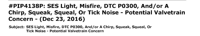

You usually nail down that kind of ticking to manifold gasket leaks, lifters or spark plugs that are loose. Someone else on here might have another idea about your ticking.
For manifold gaskets: While it is running see if the ticking is same/different on each side. That could help determine if it is that or which side may be leaking.
You already tightened the spark plugs and reseated the boots, so most likely not that.
There is also a common service bulletin:
