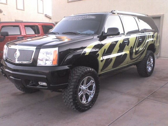

This might sound dumb but I may even swap a HD silverado front clip on it and I believe I may even be able to still use the Esky cladding / fender flare!
There really are not many pics of lifted Esky's out there but here is one that I believe will be the closest thing to what I envision! Also....who likes a thread without eye candy!

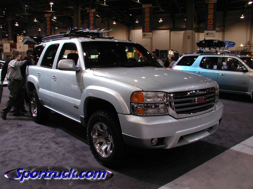

To be honest....the main reason for considering a HD silvy front clip swap is because of the core support needed for all of the ancillaries up front. Rad, coolers and such. I won't be able to bolt up the Esky clip to it. I still may even do a hd sierra clip primarily because I was inspired by this truck:
Problem is that I really love the HD hood but just can't seem to convince myself to like it on a GMC front clip. I truly applaud all that have swapped them on correctly......I just don't like the look. I want to use the Esky because of all the goodies that come with them. Considering the price for them and what burbs and kons go for in price....they will all be pretty much equal so why not start off with the base that comes with all of the stuff that would cost me $1000-$2000 more to swap in.
