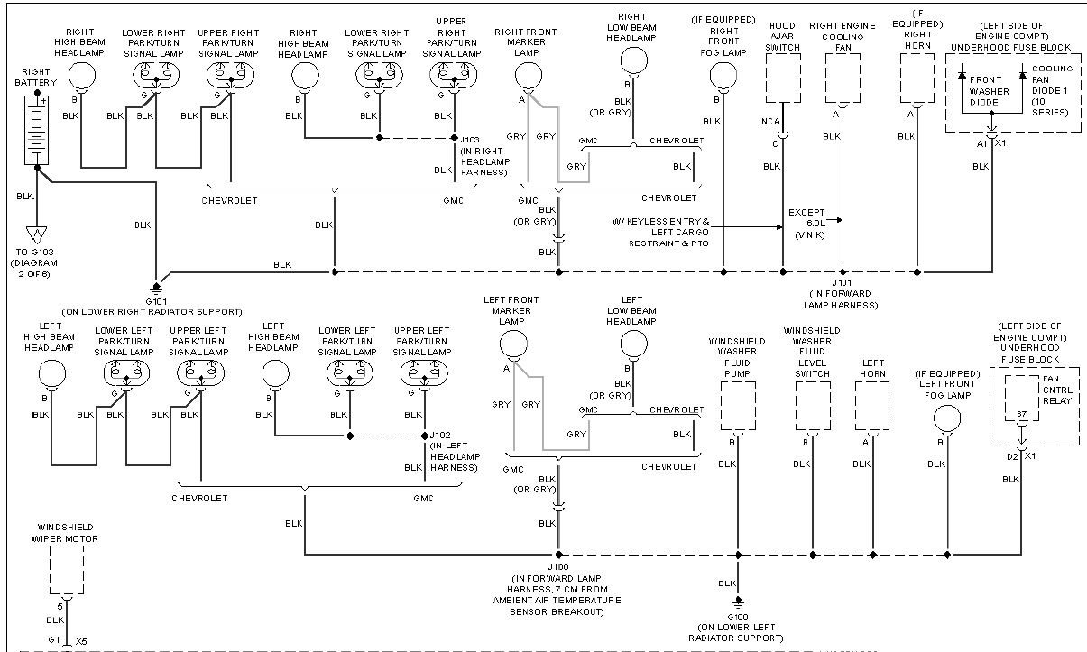

seriously, i think you have a bad ground. As steven stated above, Start at the battery and alt check all cables, motor grounds, frame grounds.. etc. there are many. If i find a pic i have ill post all ground locations. You’re in jersey i see, salt eats these things. The unde hood fuse box becomes corroded between two haves also. How is your battery? Weak? Easy test with a dvom, check charging system, etc.
Edit: my ‘13 tahoe has no problem with manual mode showing gears. Honestly, this is the first im hearing of it, that doesn’t mean it doesn’t happen, im just saying I personally never heard that.
It just leads me to believe you definitely have a bad ground somewhere.
