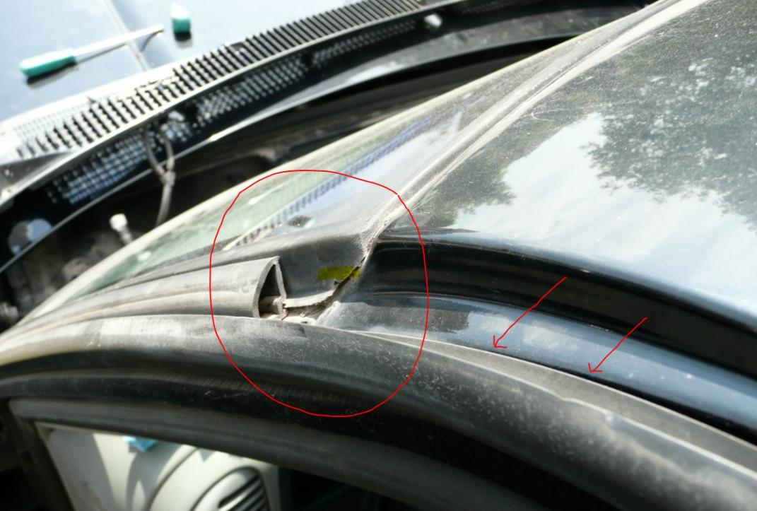

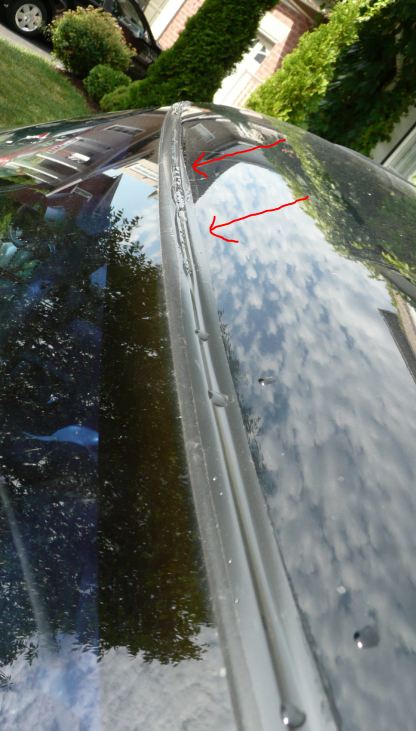

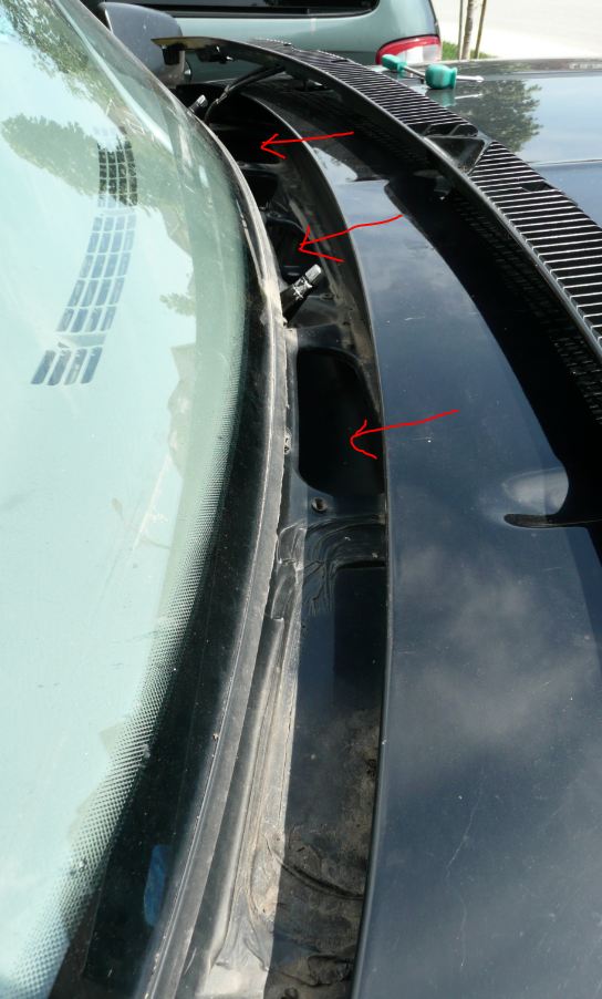

I am having water coming from somewhere into the driver side. I pulled the cowling and find no sign of it entering the cab from there. In any case water goes thru the cowling into where the arrows point to in PIC1, so how could the screws have anything to do with the leak. Obviously i am missing something. Please help ...
I also looked at the beading at the top of the door. Could water get in from where i have pointed out in the 2nd pic.
thanks for your help, this is really bugging me, not to mention the smell in the vehicle.

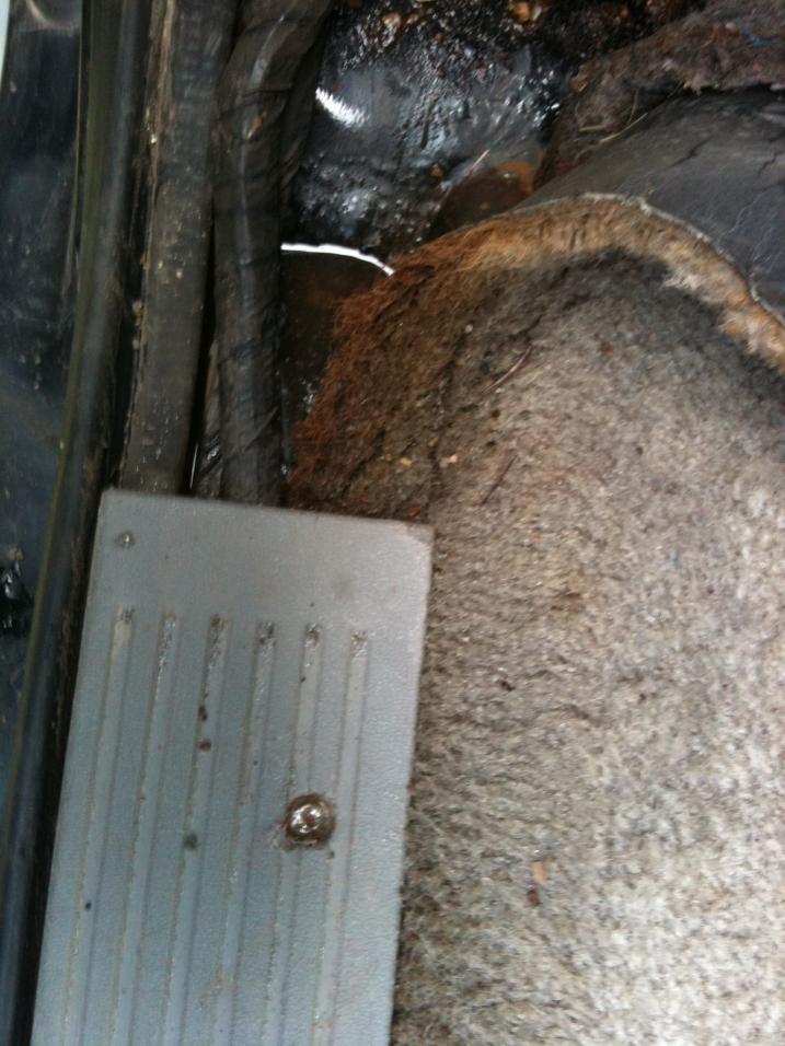

struggling to get the floor panel out as the screws are rusted, tried dremeling them out without success. do not want to damage the plastic panel, Any ideas that you folks would have getting this out.
The carpet underlay is soaked and i am trying to remove and dry same before tracking the leak.

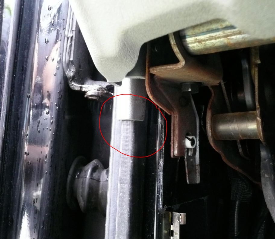

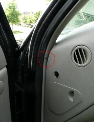

Got the screws out with little plastic damage when drilling. Pulled the carpet back to find it completly soaked and helping the rust form. Got a buddy to come over to pour water and watched the leak. As it happens the leak was from the top of the windshield beading (not the sides but the horizontal section at the top) as shown in the first pic. We taped it and the leak stopped. The water was leaking into the cab from the inside of the side pillar plastic (as shown in pic2).
Reference last pic

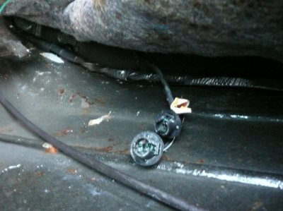

I also found 2 connectors lying under the carpet and wonder if u folks would know what these are for?

Those specific 194-type bulb sockets are for the floor mounted manual T-case shifter if installed. One should still light up with interior instrument lights the other would have lit up when the front axle engages but is not connected to rest of 4x4 system anymore if you do not have 4x4 or do have the nv243 or np8 installed.
