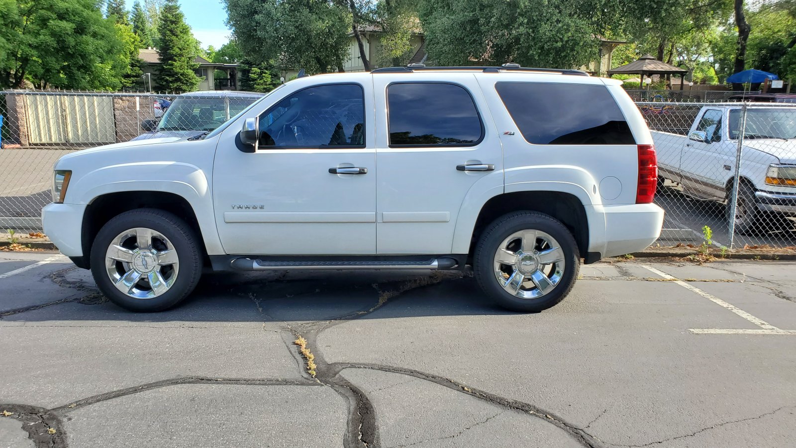

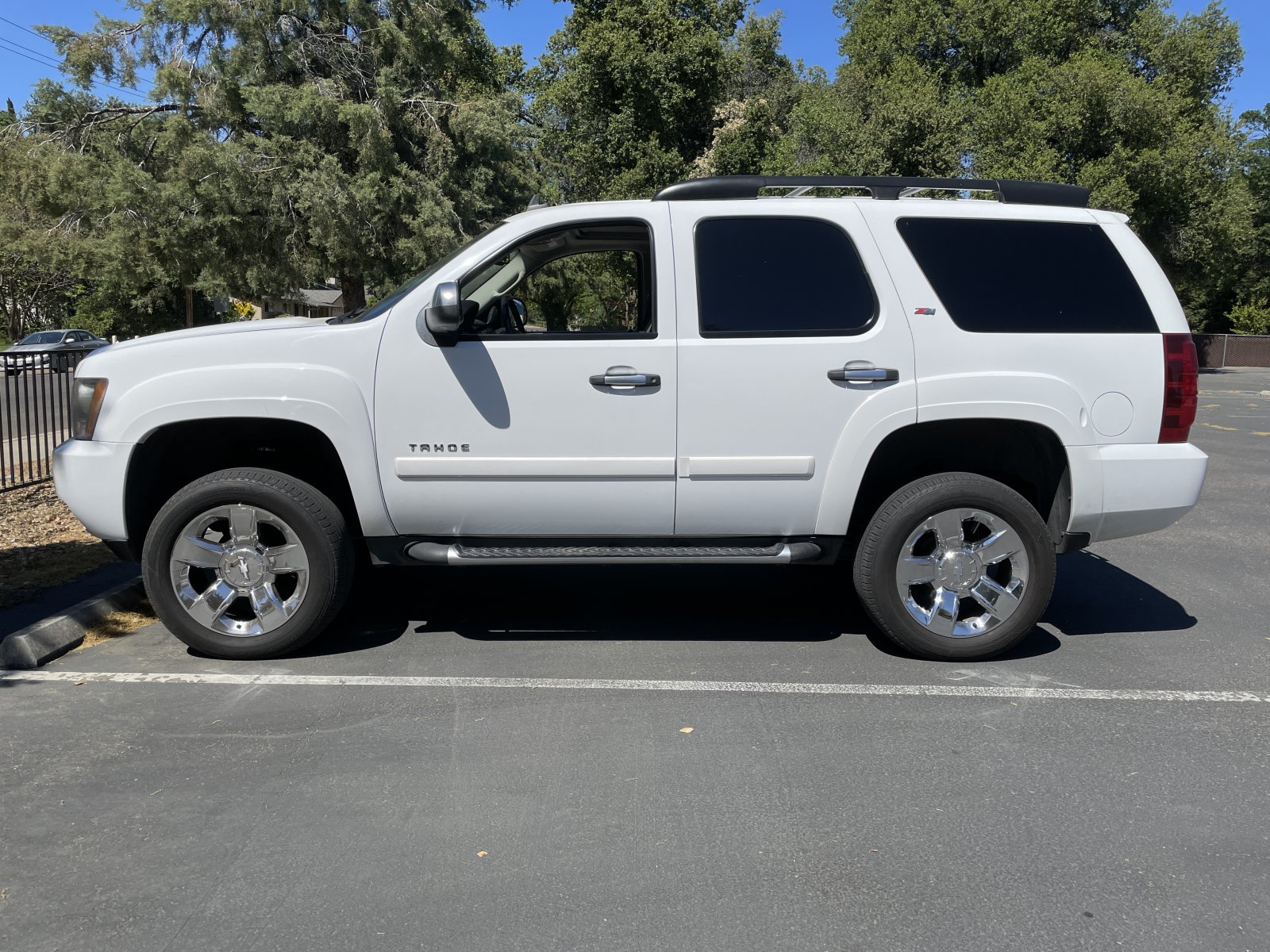

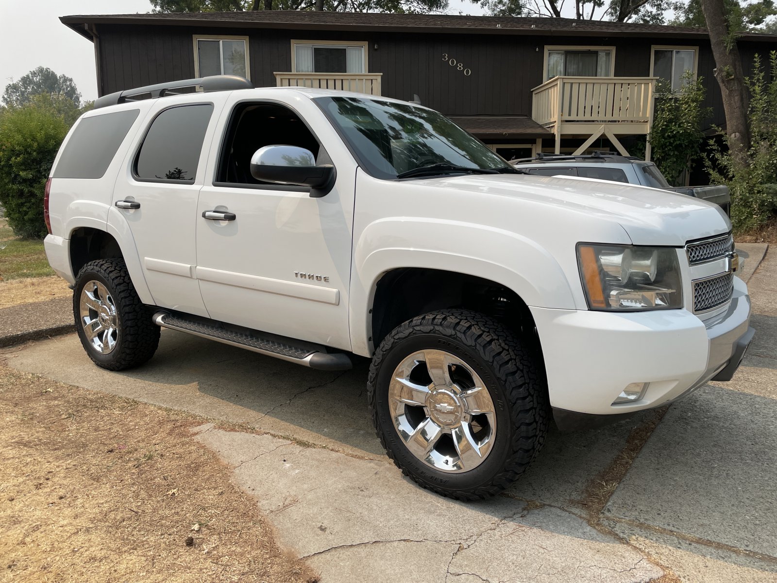

@noobsquared The first 3 pictures my Tahoe has 5100's and the MOOG springs front and rear. The last 2 pictures are after adding 2.5 inch spacers front and back. I don't tow
That last picture is $$$$
Love those aggressive tires with that lift!
