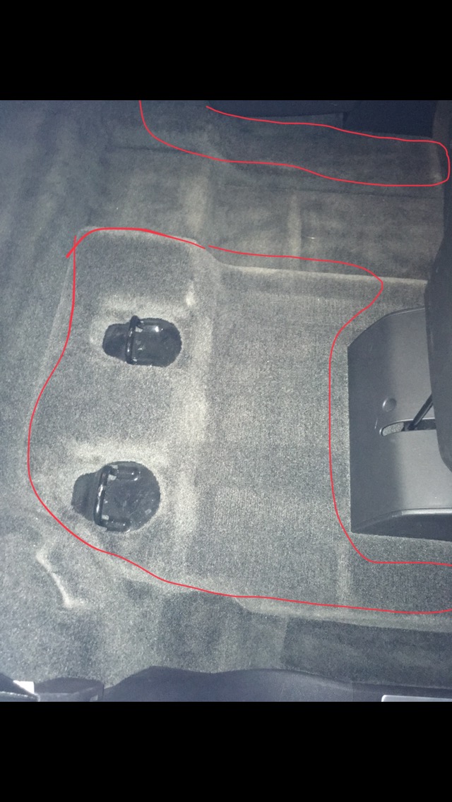

Hello - I have an 07 Yukon short wheel base with buckets and I cannot seem to figure out how the floor pieces that cover brackets/bolts come off. I do not want to break them. They appear to be carpet covered fiberglass or plastic. I'm afraid to just yank them if there is some sort of hidden bolt somewhere. I am in eastern PA looking to replace them with a black leather bench.
Thank you in advance.

I just took these out yesterday. You just have to get your fingers under it and pull up. They are just clipped in.

I have a 2007 yukon slt with captains and purchased a 2019 bench seat and it bolted right in. From what I've learned there are 2 bolt patterns on these SUVs. One is the bolts on the floor of your SUV make a perfect square and the second pattern does not. You'll notice when you prop them up and take the carpet off.
