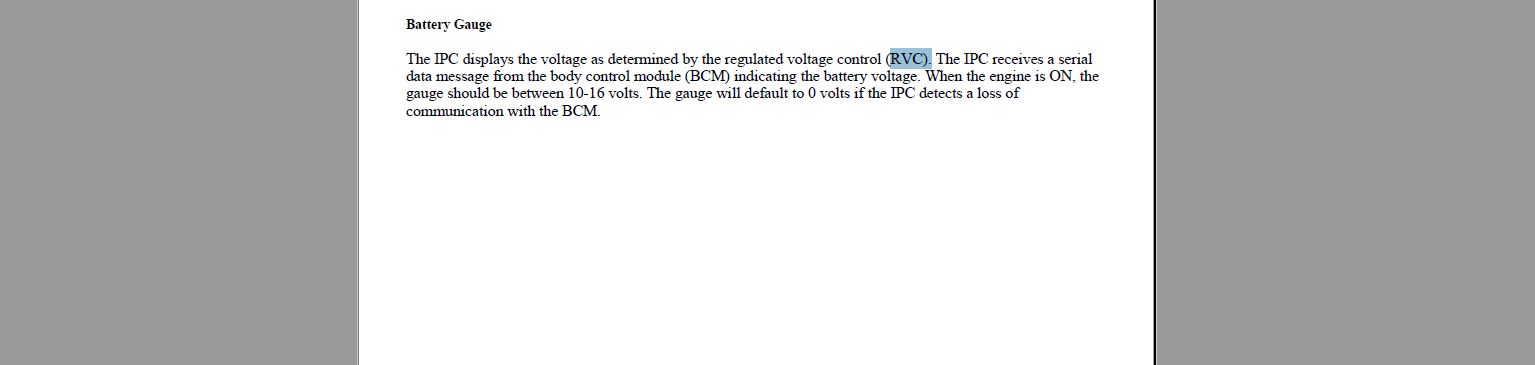

sounds like normal operation, these trucks have a voltage regulation system (rvc), you may notice the round voltage sensor attached on the ground cable to the right of the battery

welcome to gm's version of saving energy, the RVC system regulates the alternator output to better manage the battery and supposedly saves on fuel economy (I don't see how) but that's what they claim. Me, you and many others were initially perplexed by this same system
