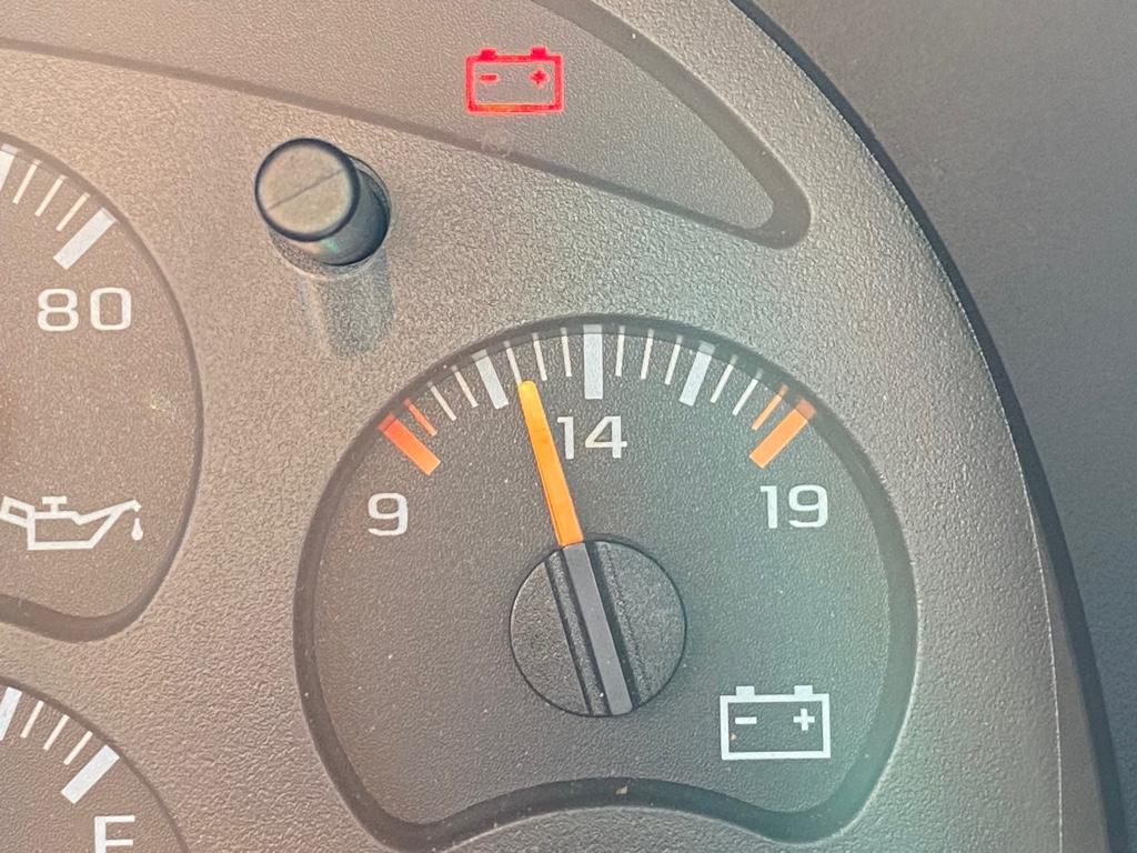

Voltage reads 13.5 with acc. on (a/c and lights) just running voltage reads 14.6 (pic)
Thanks all for the replies it really helps as I’m trying to learn as I go. Autozone hopefully tomorrow to check alternator.
As far as checking grounds; can you point me towards a good video? Thanks again.

This is the reading just after I turned the car on. No acc. on.
