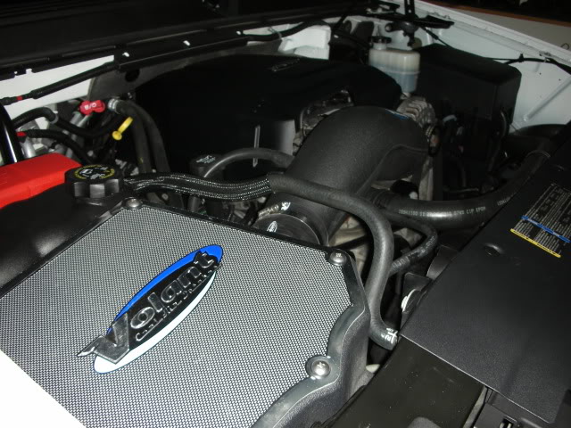

I just installed the VOLANT CAI it was pretty much self Explanatory.
However Im having difficulty trying to locate where and how im supposed to mount the air scoop!. people are saying its near the tow hooks but i cannot seem to figure out how to attach it. PLEASE HELP! Im one of those that learn better with popup pictures but since thats unlikely can you provide a picture of your present truck?
I Have a Yukon SLT 07. THank you in advance

I was able to install it .
The end piece had to be installed snug where the tow hook was.
The guys at volant told me remove the plastic part surrounding the tow hook at the passenger side. My problem was that the plastic part was one piece for my under grill. I noticed after installing it the end part was actually pushing my grill out. I had to make some custom adjustments in order to make it work but now that im done with it Im totally satisfied. It did take some patience and effort.

Here is a picture of my outcome
