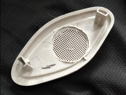

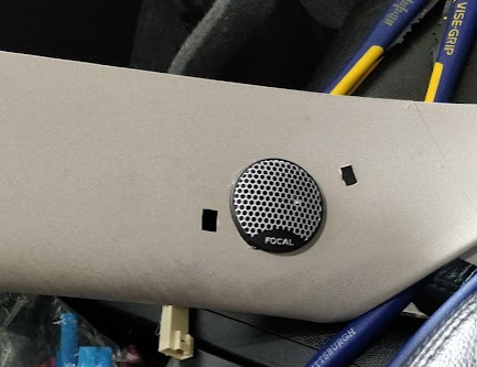

So the tweeters are probably going to be the hardest part about your whole upgrade. You have 2 options for the front. You can take the A-Pillar tweeters out and then either cut or dremel a hole big enough to fit your new tweeters. The factory hole is not circular so be careful with how much you cut. The other option is to drill in the sail panels on the door. You'll need a hole saw that is the exact size of your tweeter, lets say 1 inch. This makes wiring them in easier, but its also going to be a permanent hole and it wont look as factory.
Your also going to need to mount an external crossover if your speakers came with it. I'm currently doing that right now and I don't have much input but I'll be installing them within the next day or two so I may have suggestions and pictures then.
The tweeters in the A-Pillar are run in parallel with the door woofers so do not cut the connector off and terminate the wires. You'll also need to cut or dremel the plastic "Bose" clip that covers up the A-Pillar tweeter. I'll post some pics below so you can get a reference as to what I'm talking about. Note, the tweeters in the picture are 1.25" and I used a dremel.
Thanks a lot for the info! I’m def torn between the mod you did to the pillar or just putting them in the door panel itself. Makes Me wish i was good at fiberglass work to patch the 2 holes left over in the pillars. That’s probably the route I’ll end up going! Thanks again.
