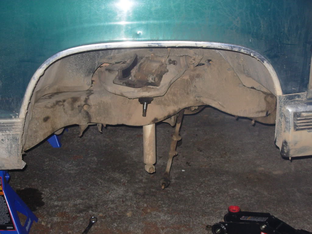

Putting ball joints and control arm bushings on my wifes right now. Just to lazy to touch it today.

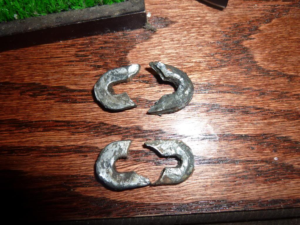

The knockouts. When you take the bolts out of the upper control arm the frame should have an oval hole. If it is just a round hole, you need to knock out the knock outs.
Kinda like perforated paper but a hammer and punch work much better for this.
Oval hole is already their just need to pop the inserts out.
---------- Post added at 01:32 AM ---------- Previous post was at 01:21 AM ----------
This is the knock outs. Go figure only on the pass side on mine.

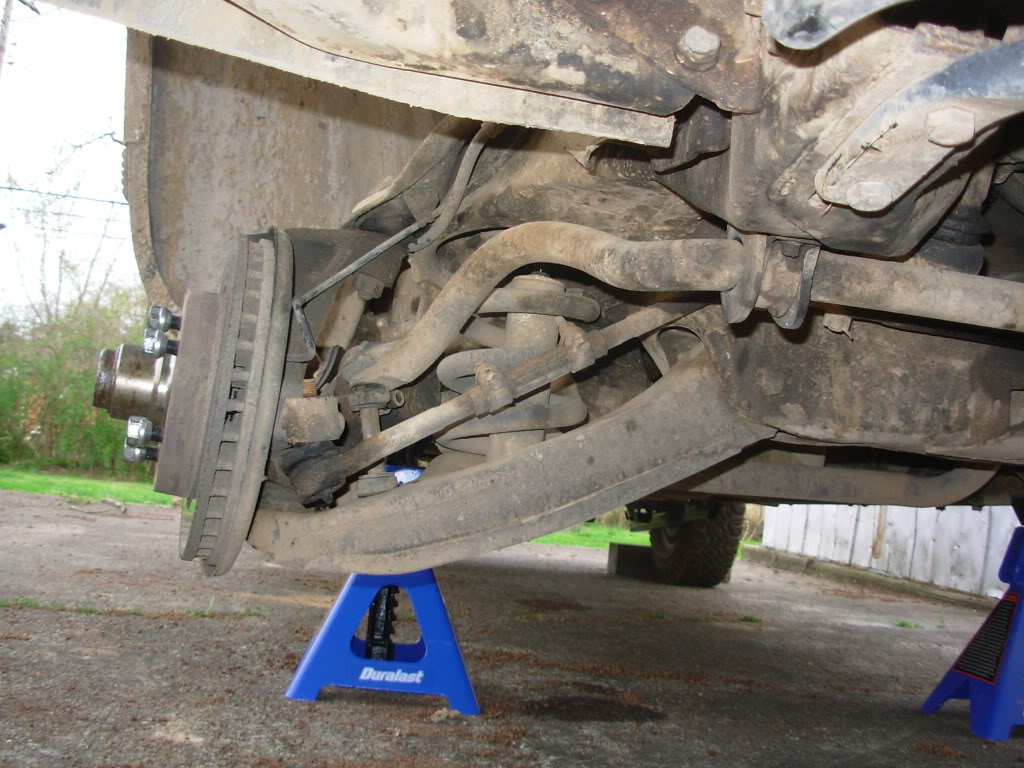

Will take a pic of the frame/attachement point if I remember when I run out in a bit.
---------- Post added at 01:39 AM ---------- Previous post was at 01:32 AM ----------
Here's your other pic.
May look different as this one is 4wd, however the knockouts will be the same. You can see the knock the center Both outers are gone.
