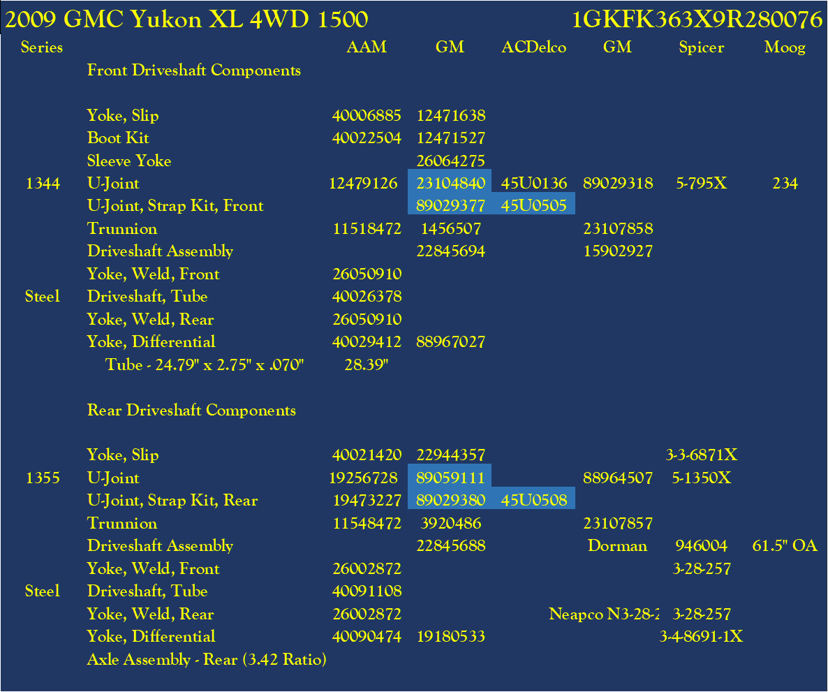

In my opinion, the factory universal joints are tops. They are solid and very long-lasting. I bought new AAM (the OE supplier for our differentials and driveshafts) u-joints and still haven't needed to replace them on any of our three trucks. The '09 is approaching 220K. Even the lifted Sierra with the 6.2 still has tight joints.
Here are my notes:
As always, trust but verify!
