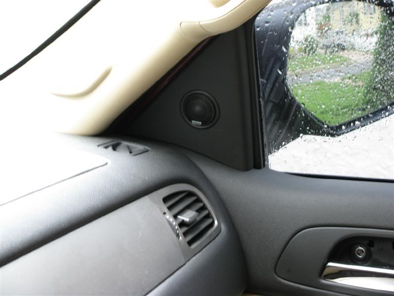

I've heard a lot of discussion about placing it in the original place (within the speaker grill) for the front speakers, but I've also seen discussions about putting them in the A pillar or up near the dashboard, as the new Tahoes have them up there. You would think that since the newer models have them on the A pillar that it is a better place to have them?
I've also seen people install them here:

I meant to say sail panels, I don't why I said the pillars. The sail panel is that little triangle panel inside of the mirror, the location shown in that picture in your OP. My tweets are installed in the uppermost location inside the speaker grill on the front doors (about at me knees), and with placement and tuning, my stage height is pretty decent. I would have put them in the sails, but my tweets with the tweet cups wouldn't fit in the sails without smacking the dash when I shut the door.
