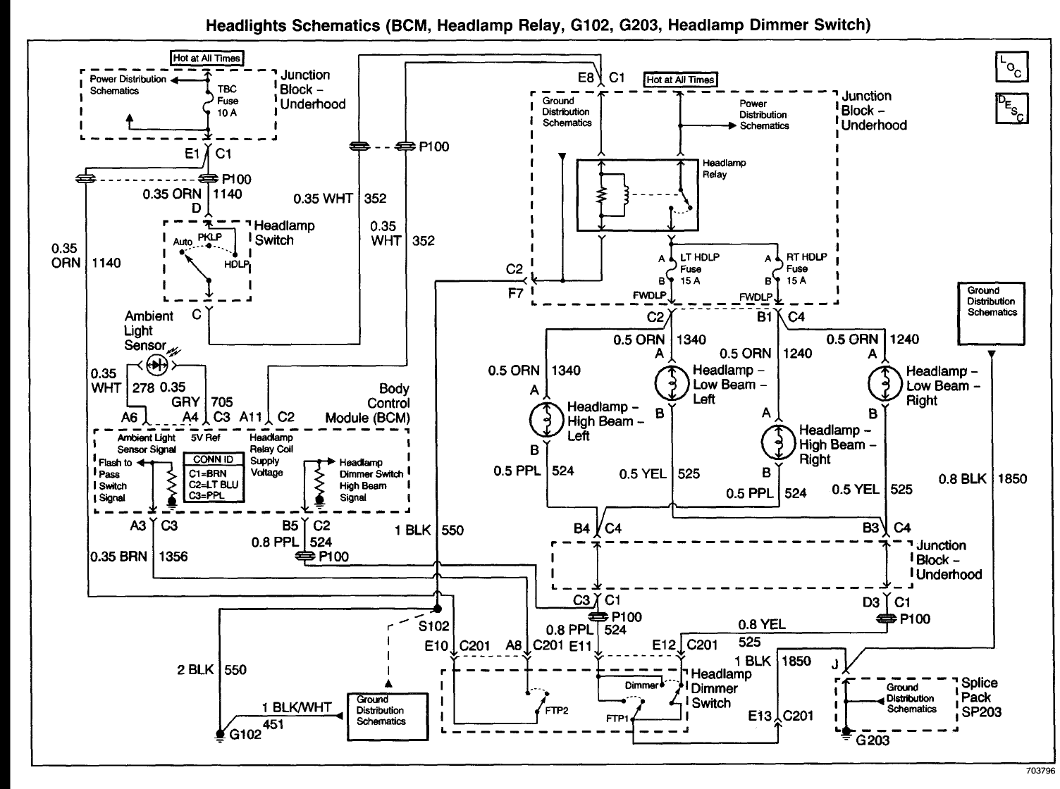

UPDATE I'M STUPID you got a new Multifunction switch and didn't help. Maybe the diagram will still be of help though. Sounds like you have a wiring issue. You'll need to trace the lines in the diagram below. I'd use a power probe makes quick work of this sort of thing.
OLD POST: This happened with my 2006 Buick Lucerne. I was able to isolate it to the multifunction switch as if I applied pressure the switch in certain positions it would behave correctly. If memory serves right it was almost exactly as you explained. I bought a new multifunction switch and problem was resolved.
That said, best to diagnose with a handheld DMM and or power probe. I think there's a connector for the multifunction switch under the molding for the steering column or the knee bolster.
If yours is same as my 2001 Tahoe... Then looks like need pinout for C201. Having a hard time finding it in FSM. Some of the wiring colors are in the diagram below where you see switches towards bottom.

Thank you for the diagram. I should clarify on the multi function switch. It's new... but only to me haha it's a used one from the yard. I guess it's possible it had the same issue I did but identical symptoms just seemed unlikely to me.. though crazier things have happened..
