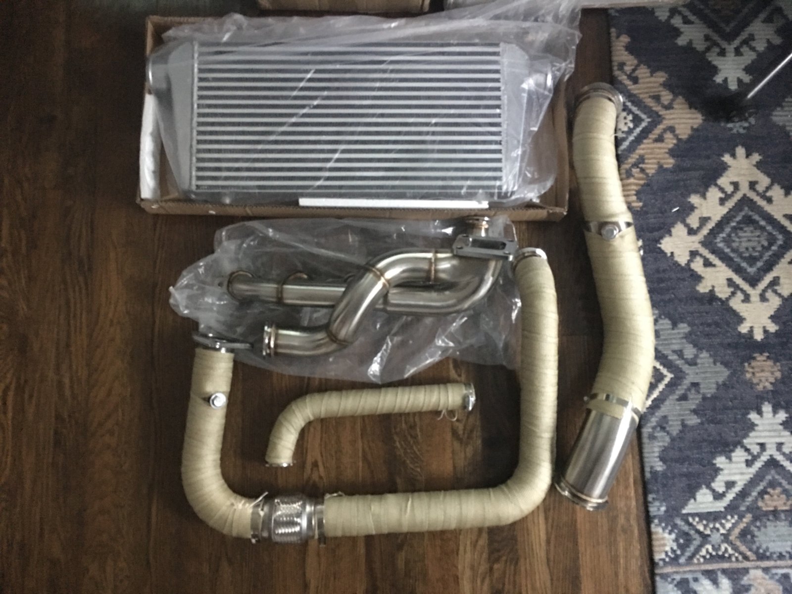

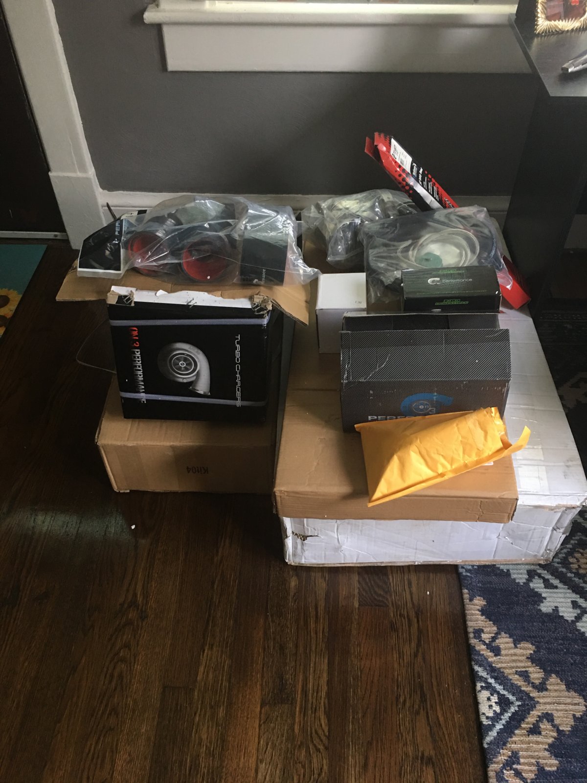

I'm going to piece it together but I'm going to purchase the hotside from kbracing. I don't want to have to tear it down and keep pulling and putting parts back on to get everything to fit the way I want. Don't really want it to turn into a project. If I purchase everything the way I plan to I can have it all on in a weekend and it'll cost me probably just a little over 3k which I'm fine with.
