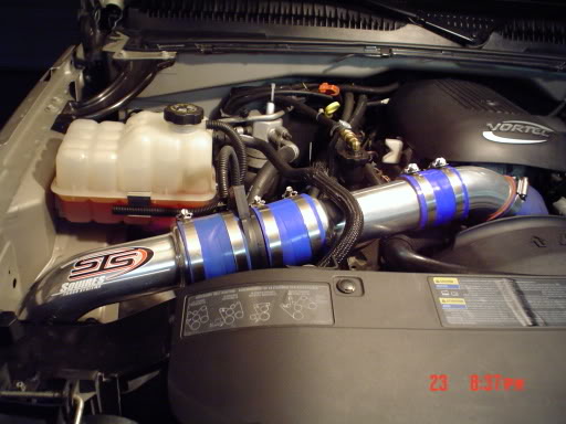

On the other hand STS has a universal turbo kit for around 2 grand. I'm sure there is more to it though.
Yeah, Im an STS dealer, became one to get a good deal for the one one my old truck.
But It just wouldnt work with the TBI i dont think due to lack of fuel.
So i guess im going to have to swap in a 5.3 or 6.0 to get the power i want and be able to add a turbo kit easier.
I mught just put another STS kit on this one, but want to try a front mount this time for something different, but im not sure which way i'll go.
BTW heres an old pic of my STS turbo Z71
