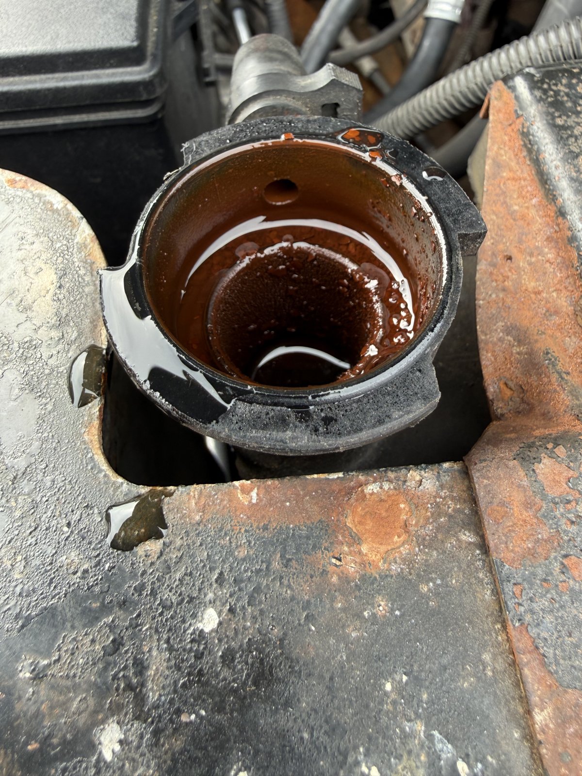

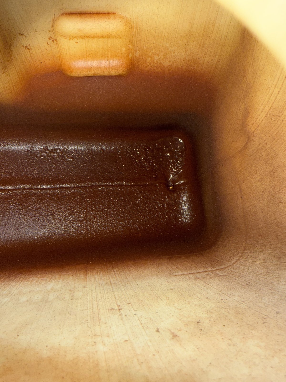

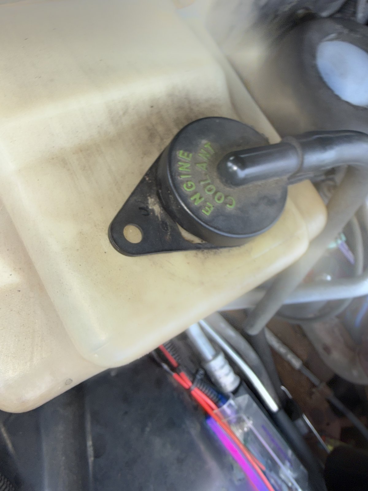

Dex cool or just rust top of the overflow lettering is in green unsure if that means anything
