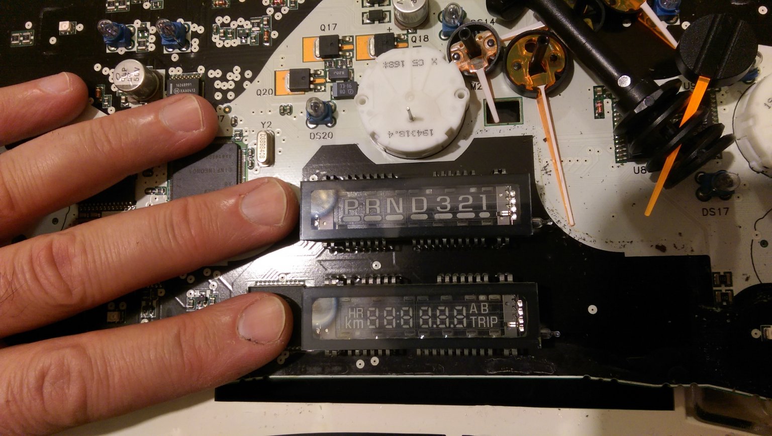

I have a spare Gm cluster that looks similar to ours and it has the display that shows mileage-odometer-need it? If not, I'm trashing it.
33,344
51,835
Yours if you want it. Let me know what you want me to do to get it out or whatever you need. You can have the entire cluster or I could try to snap them off or something.
