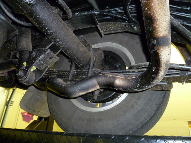

When I bought my 2 door 2 wheel drive Tahoe it had a "dual exhaust" on it all the way to the rear, with a 4"/6" drop. It was run underneath the rear axle, because if your Tahoe is lowered there is virtually no room for dual exhausts. I took it off and went with a Gibson cat back system that sounds good in combination with a shorty Edelbrock header.

Here is the dual exhaust configuration the original owner installed on my two door two wheel drive Tahoe. I ultimately removed it and installed a Gibson cat-back exhaust setup. It sounded bad IMHO and the rear axle clearance was not good. I'd stick with an over axle setup; there is no free lunch on clearance if you lower it.

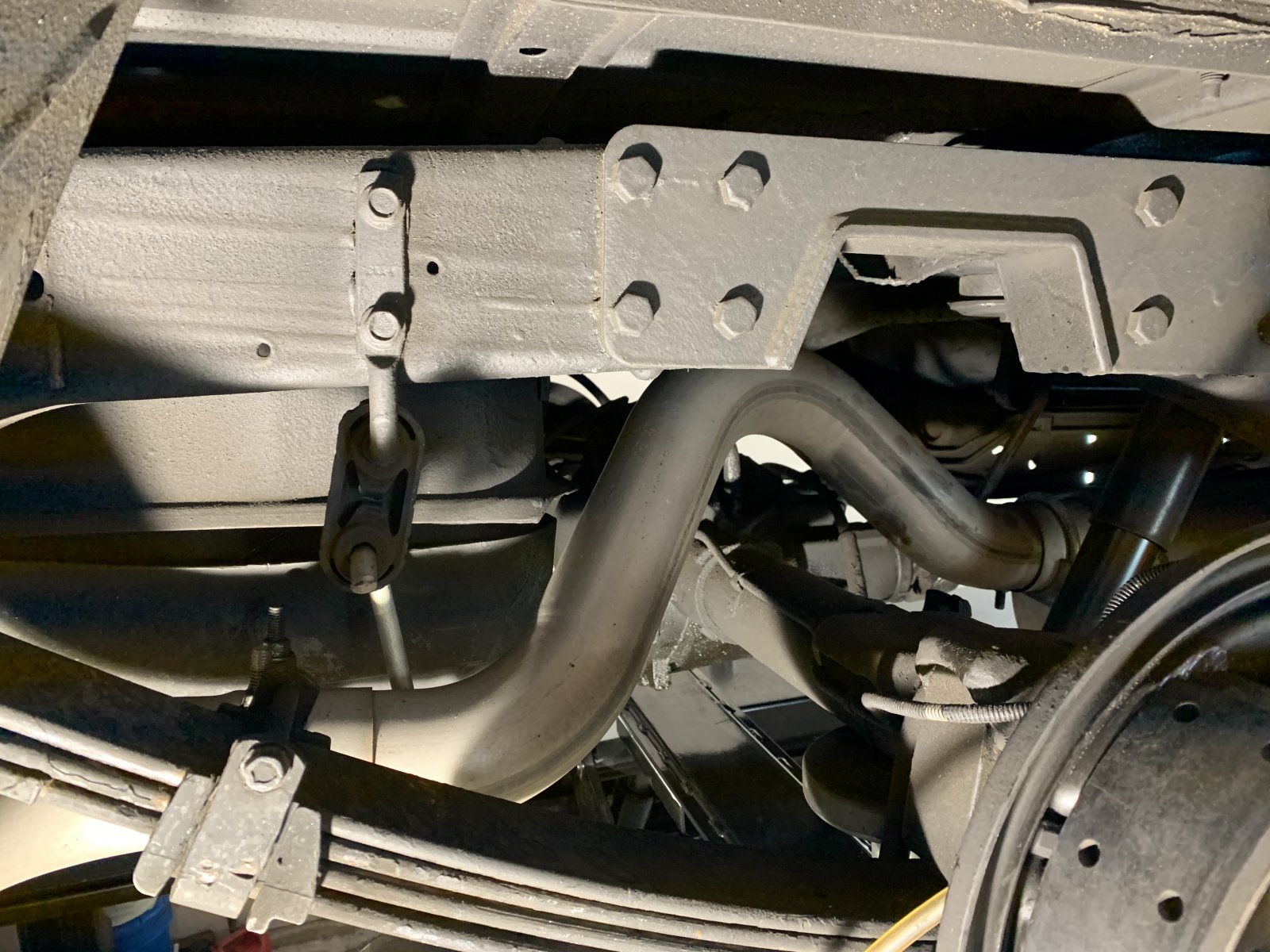

Much better setup with the single sideout exhaust. Sounds better-less drone- and there is more clearance, although it's not great.
