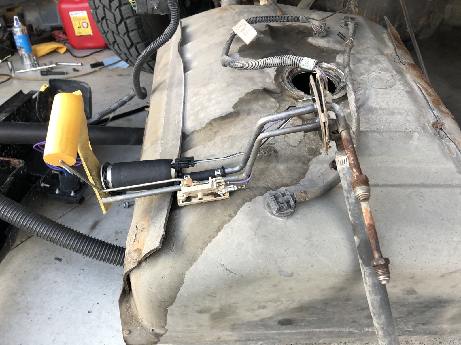

Finally got around to dropping the tank, again, and pulling the fuel pump. I have a new ACdelco on hand to Go in. But first I wanted to verify that it wasn’t working so I tried to start the truck, didn’t hear it prime, the tried to start, cranks, nothing.
So out cane the gas tank, got the fuel pump out, everyone looks good, wiring looks fine, ground is good.
so I decide to check the pump directly, I attached 2 alligator clips to the prongs on the pump and the others to a full battery.... THE DAMN PUMP WORKS!!
the hell is going on?? I checked alll the fuses again, the ECM-B which controls the fuel pump power, that’s all good, remember I also changed the relay too, everything is good...

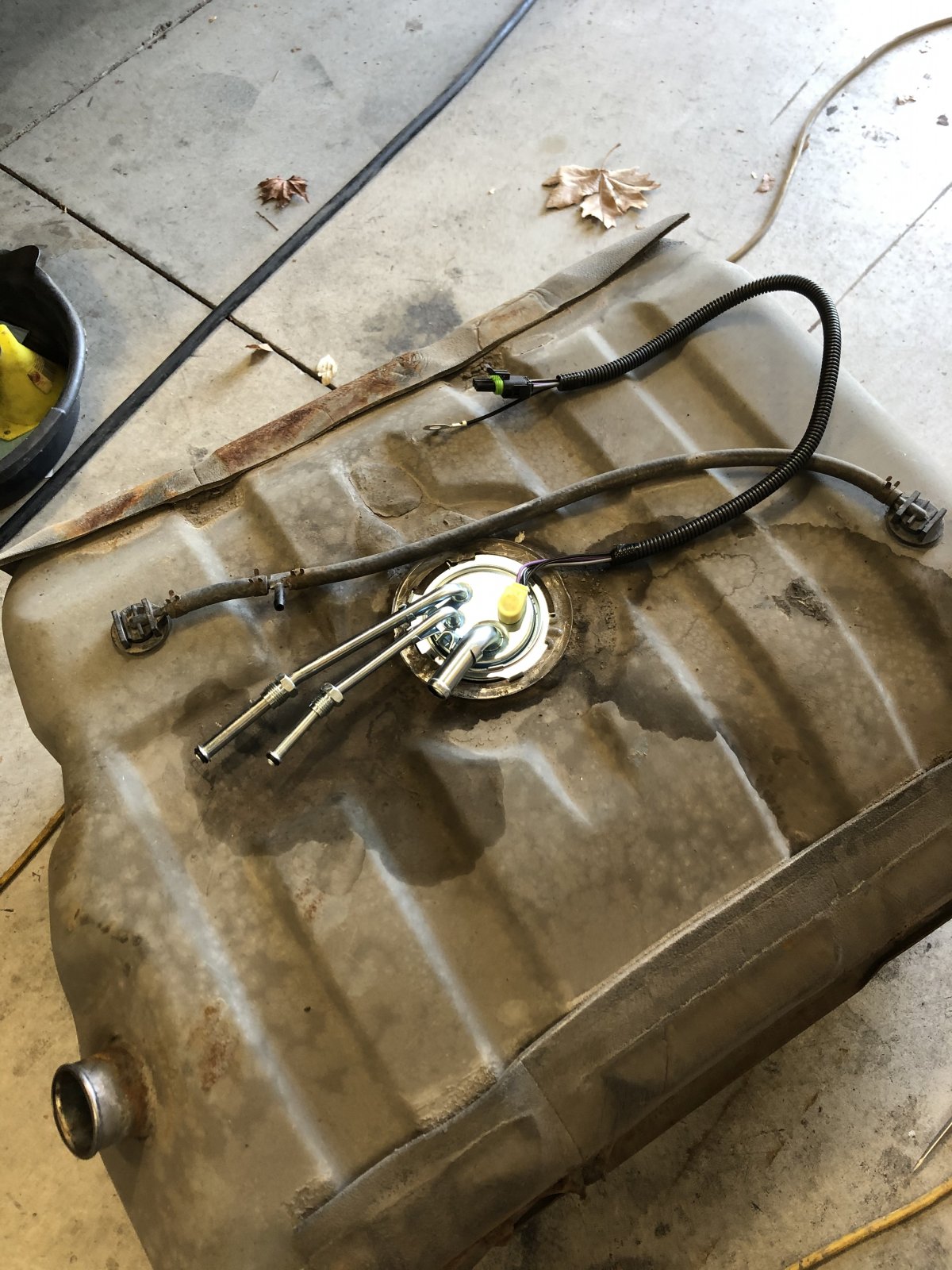

New pump in, no change, tried to jump pins 30 and 87 on the relay, that didn’t work either

Ok, so wiggled connection, no change, unhooked weather pack, and reconnected, no change, decided to remove the ground wire, connected the ground wire directly to a separate ground and BINGO, bad ground
