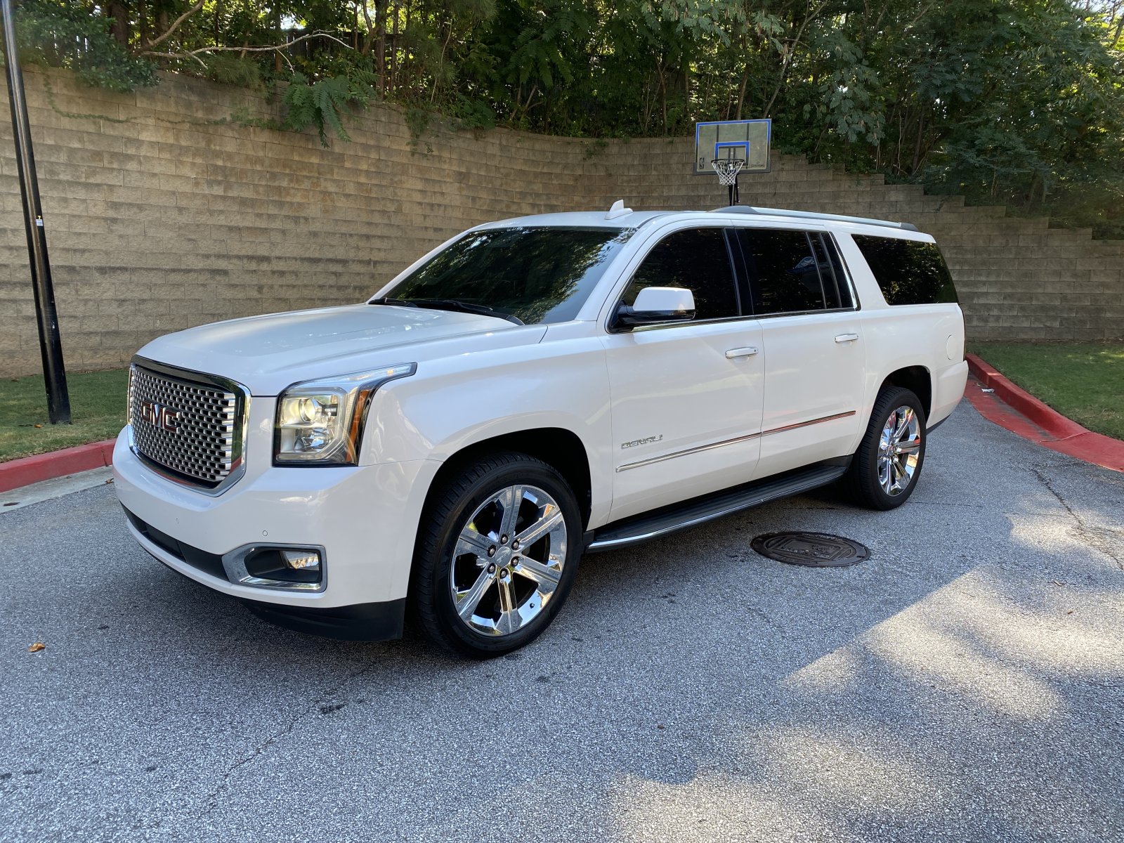

Welcome to the Forum from NH.
Pics of the truck, please.

Nice looking Yukon OP, partial to the Frost White myself.
Find a reputable transmission shop that can rebuild using quality hard parts and an upgraded torque converter, they should be able to tune the TCM as well.
