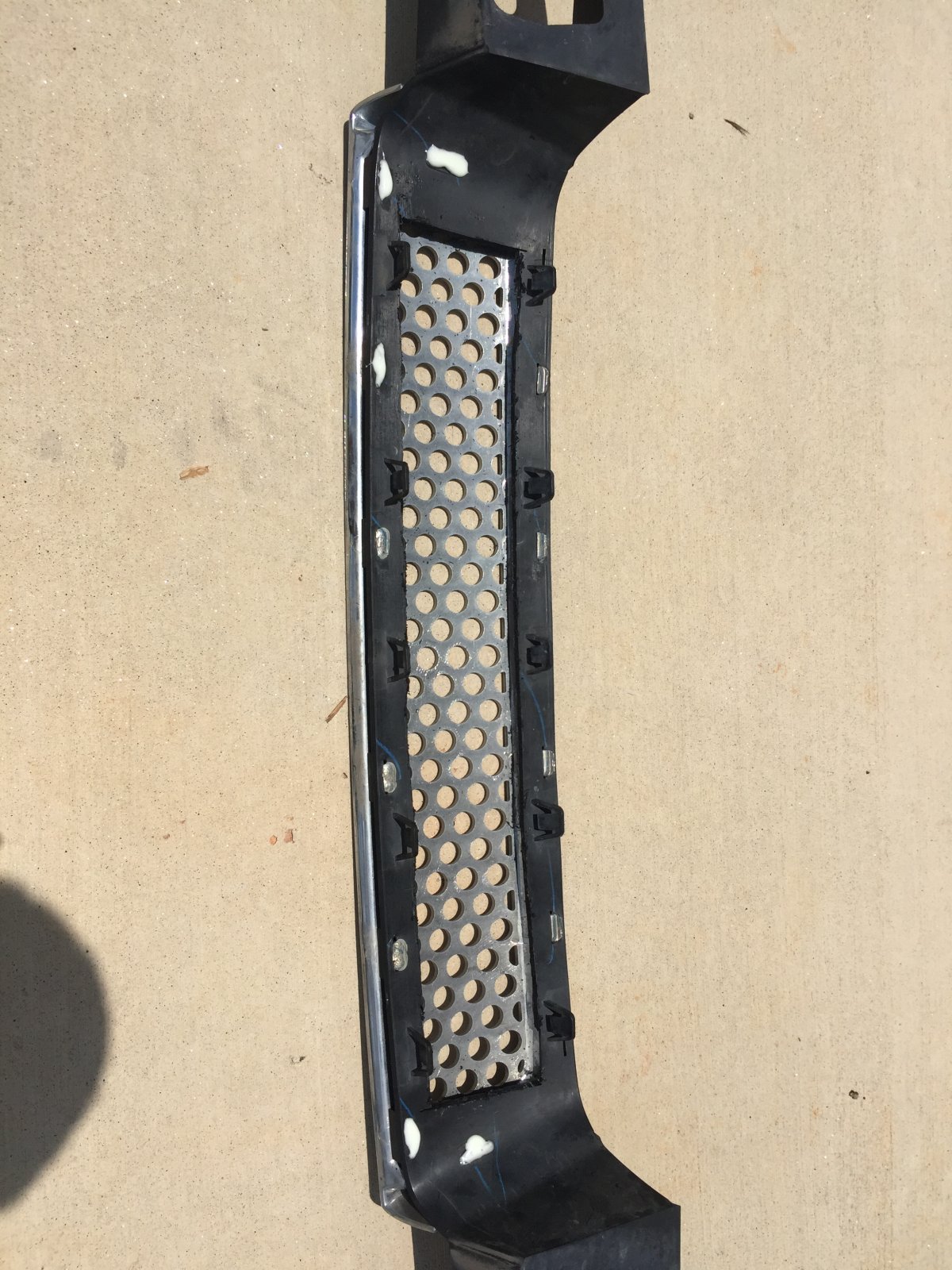

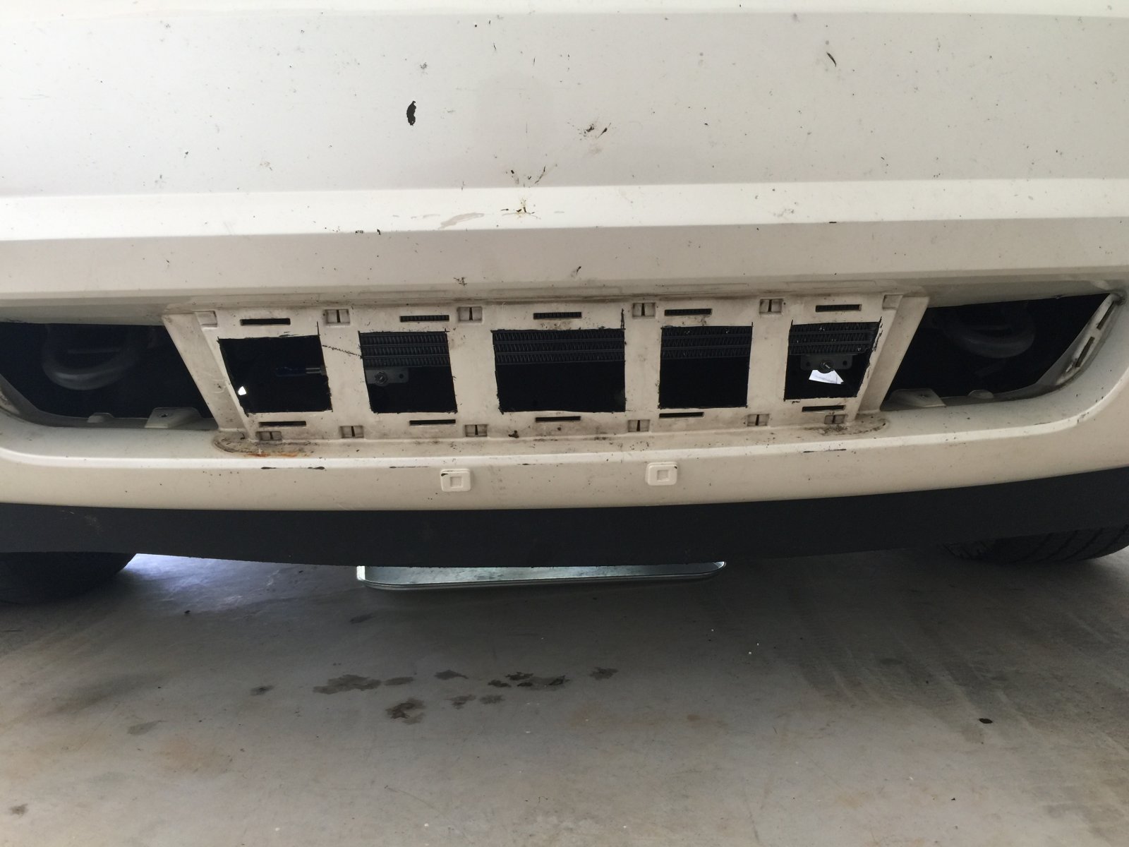

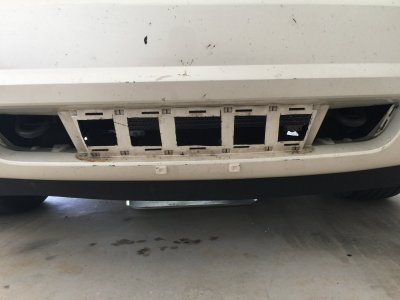

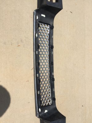

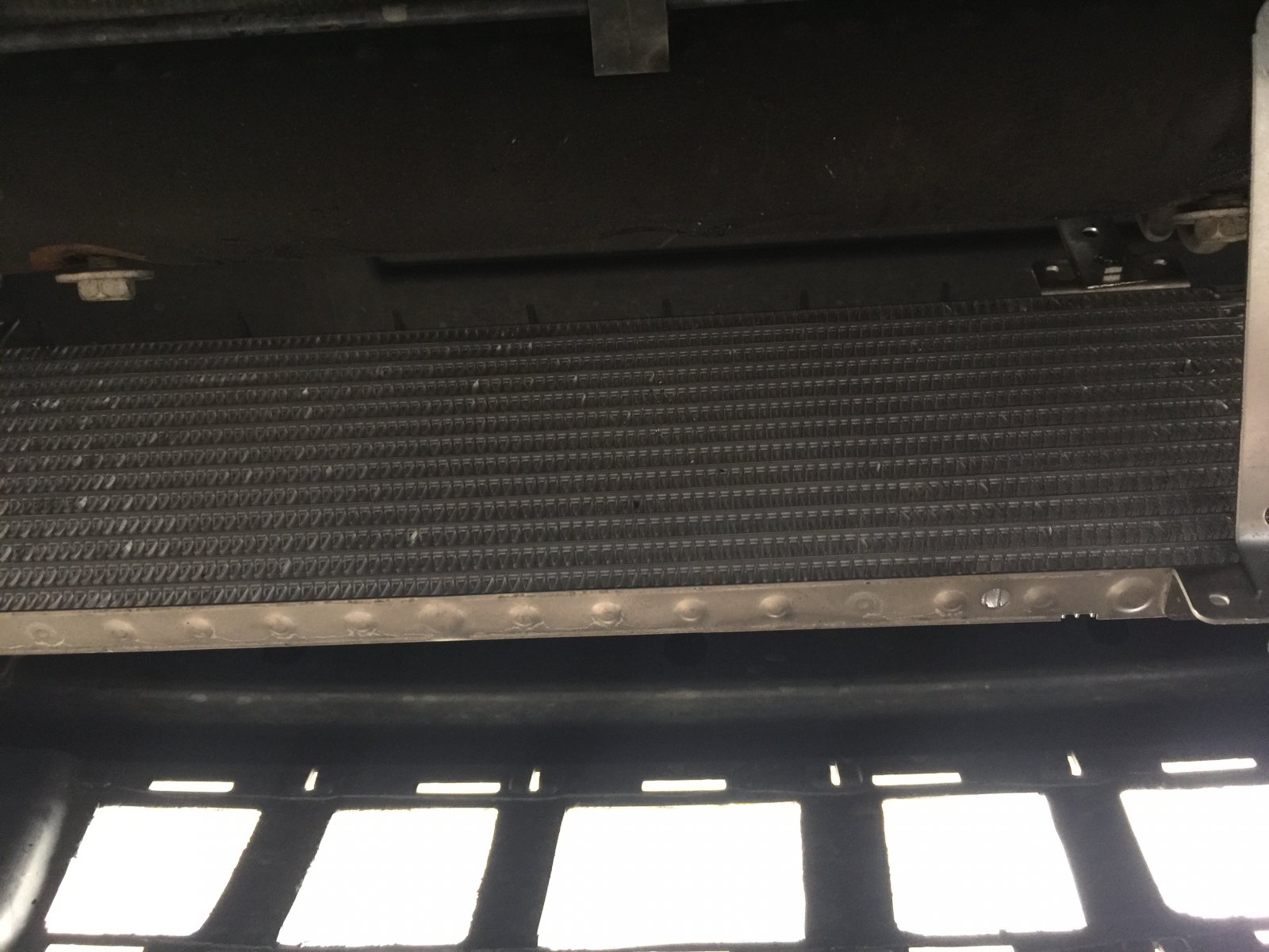

Just an update; here's some pics of the installation. I cut through the plastic fascia behind the lower grill, and the lower bumper extension to create airflow. The cooler (tru cool 30k) mounted behind that. It's not plumbed in yet, as I didn't have any trans. fluid, but will be getting some today.
