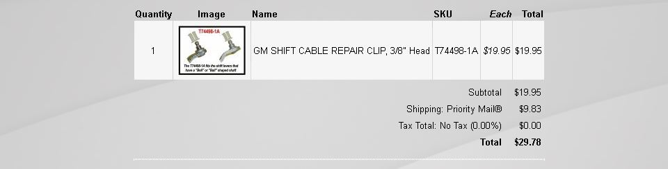

the fitzall works fine the bushing fix one will fail because the material they use is subject to heat degradation
I have had the fitzall on mine for over 3 years i also drilled a small hole in the nipple and added a washer and cotter pin.
