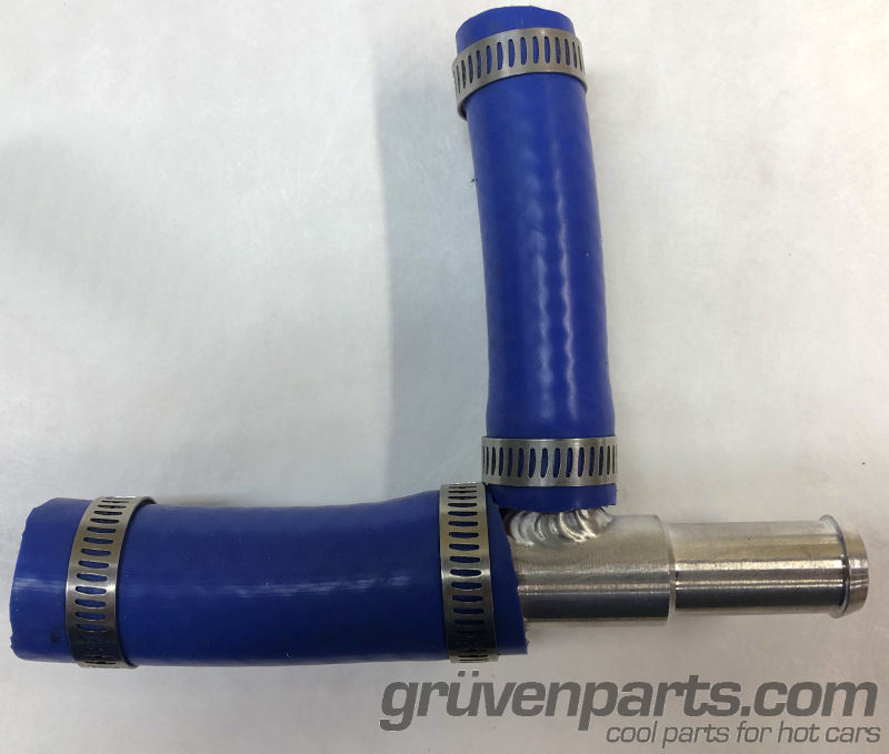

When my heater hose T-fitting broke, replaced both with www. gruvenparts.com metal Ts.
