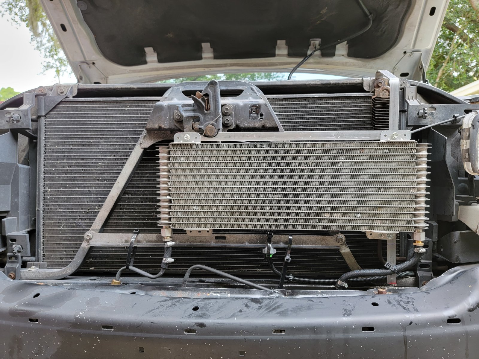

I installed a 40K Trucool transmission cooler about a year ago. Easy install and very happy with the performance.

The photo looks like you replaced the OEM cooler rather than adding the Trucool 40 in series. Is that correct? Can you give me an idea of what temps you see in the summer, in traffic, not towing?

Yes I replaced the very small OEM cooler. I installed this because I do tow a camper on a regular basis and the OEM cooler just wasn't cutting it. However, there is a huge benefit on a day to day basis. For example today was around 95 and humid as hell. Without the new cooler I would average 170+ in traffic. Today the temp sat around 135 to 140. While towing I see even bigger improvements.

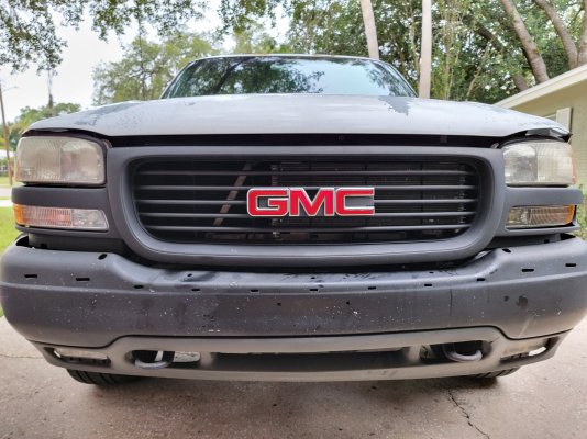

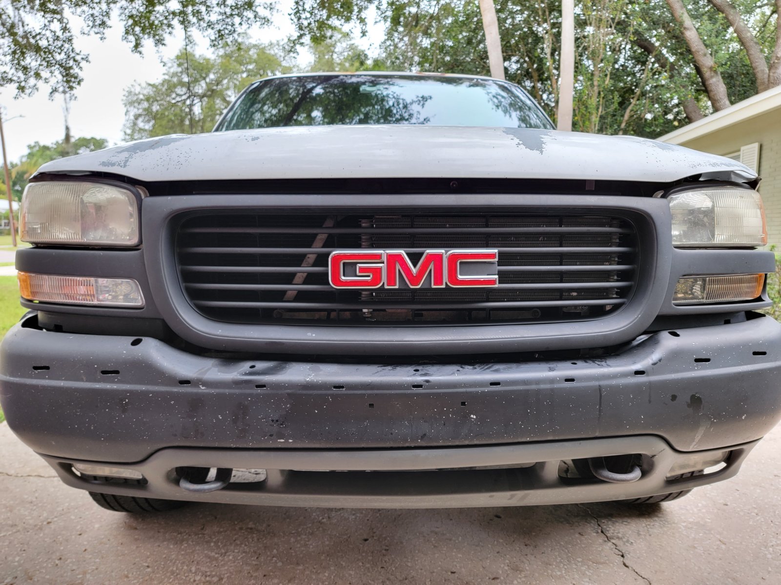

Installed TruCool 40k with PT Bracket Kit.
Ended up moving everything over as far to the Driver's Side as possible so that I could install a pusher fan for the front of my condenser on the passenger side. With an electric transmission temperature gauge, I haven't seen temperatures go over 160 here in Florida.
