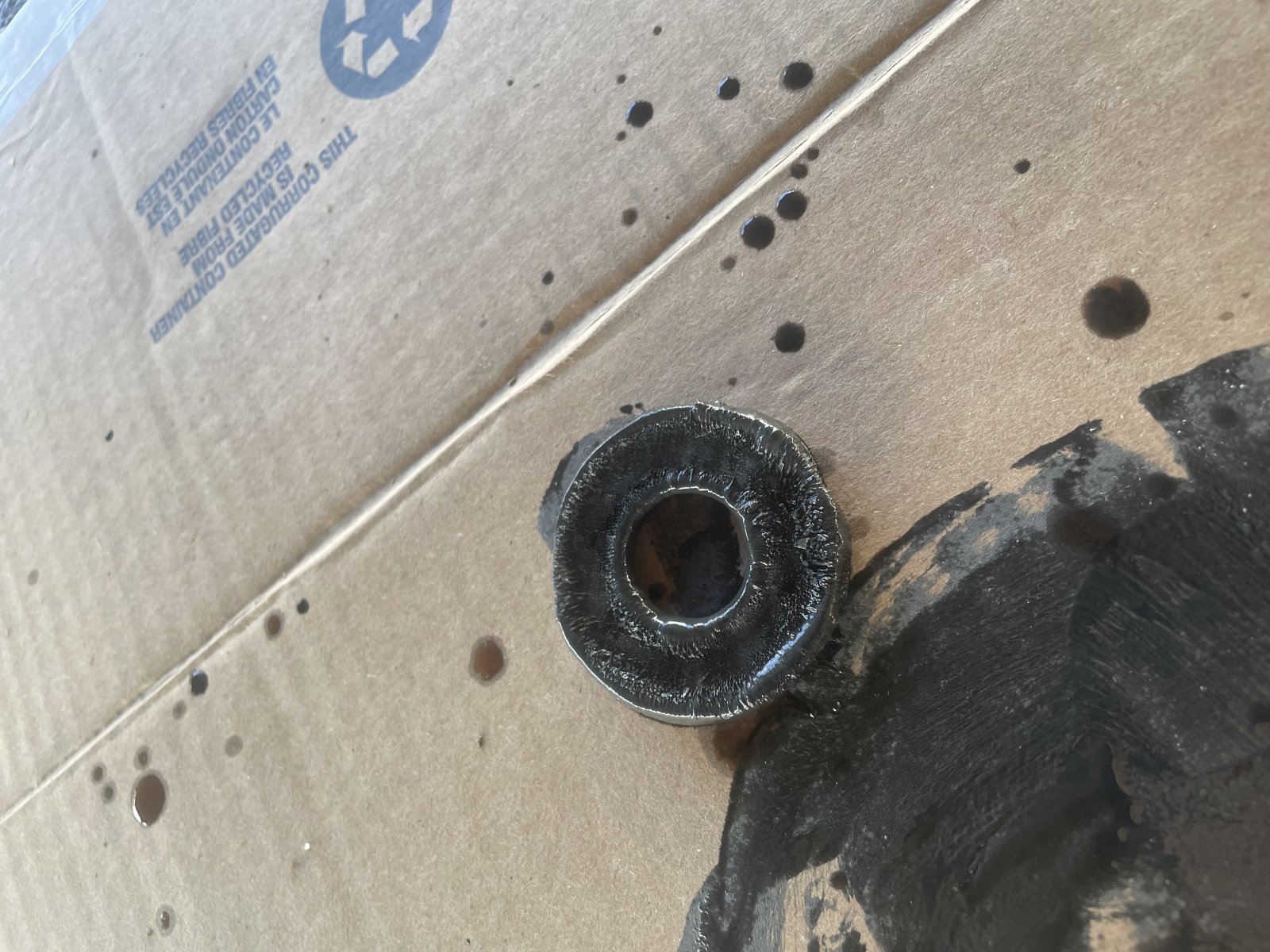

Looking for some input on the sludge from most recent trans flush. Replaced the filter this time and cleaned the pan. Normal or not?
2013 Yukon Denali 6.2L 265k.

50k between, thanks for the input. No bigger chunks or anything. Cheers!

...that doesn't look too good to me. Some residue is okay, but that looks like metal shards.
Is that the original transmission? If so, it definitely lasted for a 6 speed unit!
