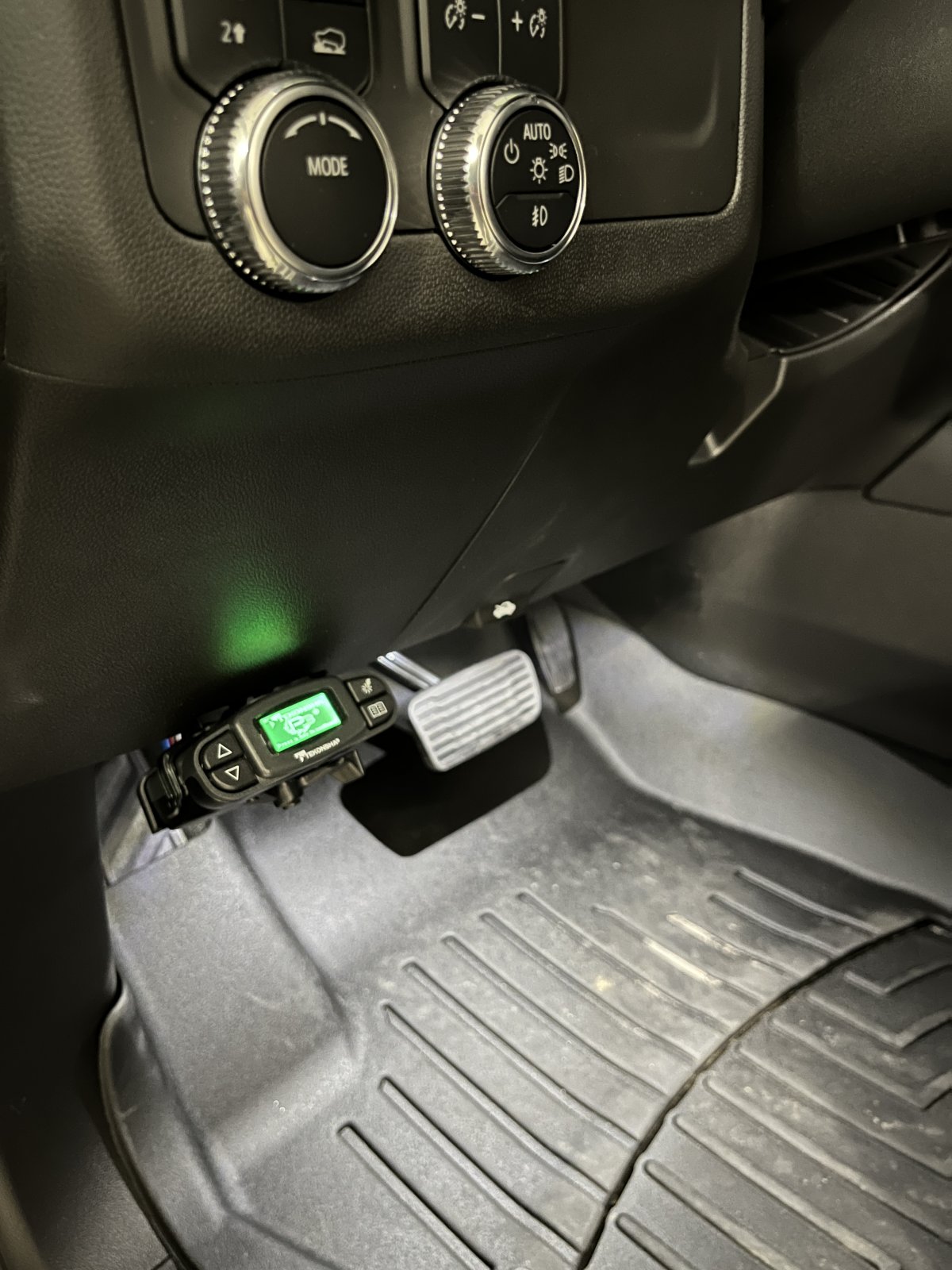

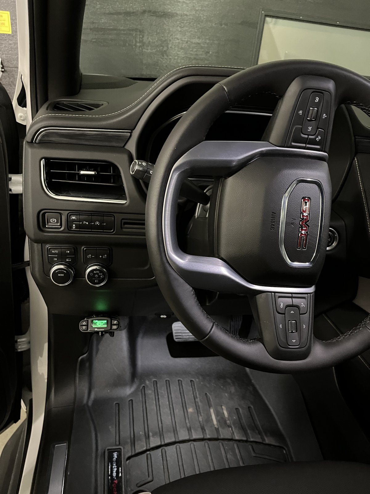

Tekonsha P3 Installed - About an hour into it.
