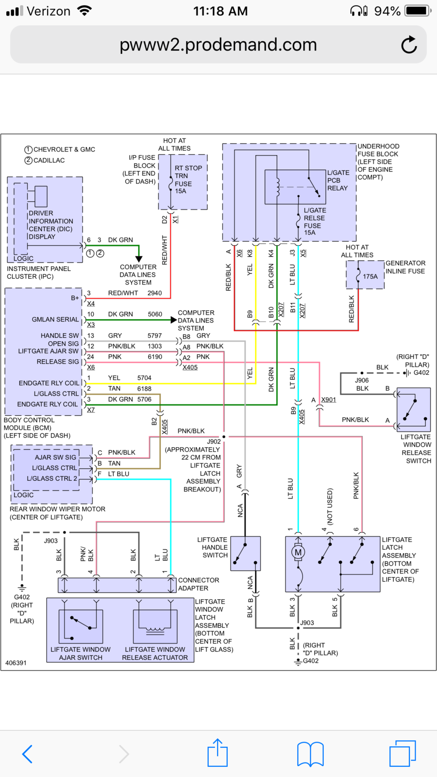

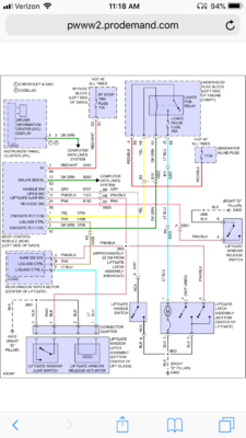

Here’s a schematic
Also check where the wiring harness leaves the body and entires the lift gate at the top near the 3rd brake light. That harness is known to to get chaffed and possibly severed due to sharp edges as it is opened closed.

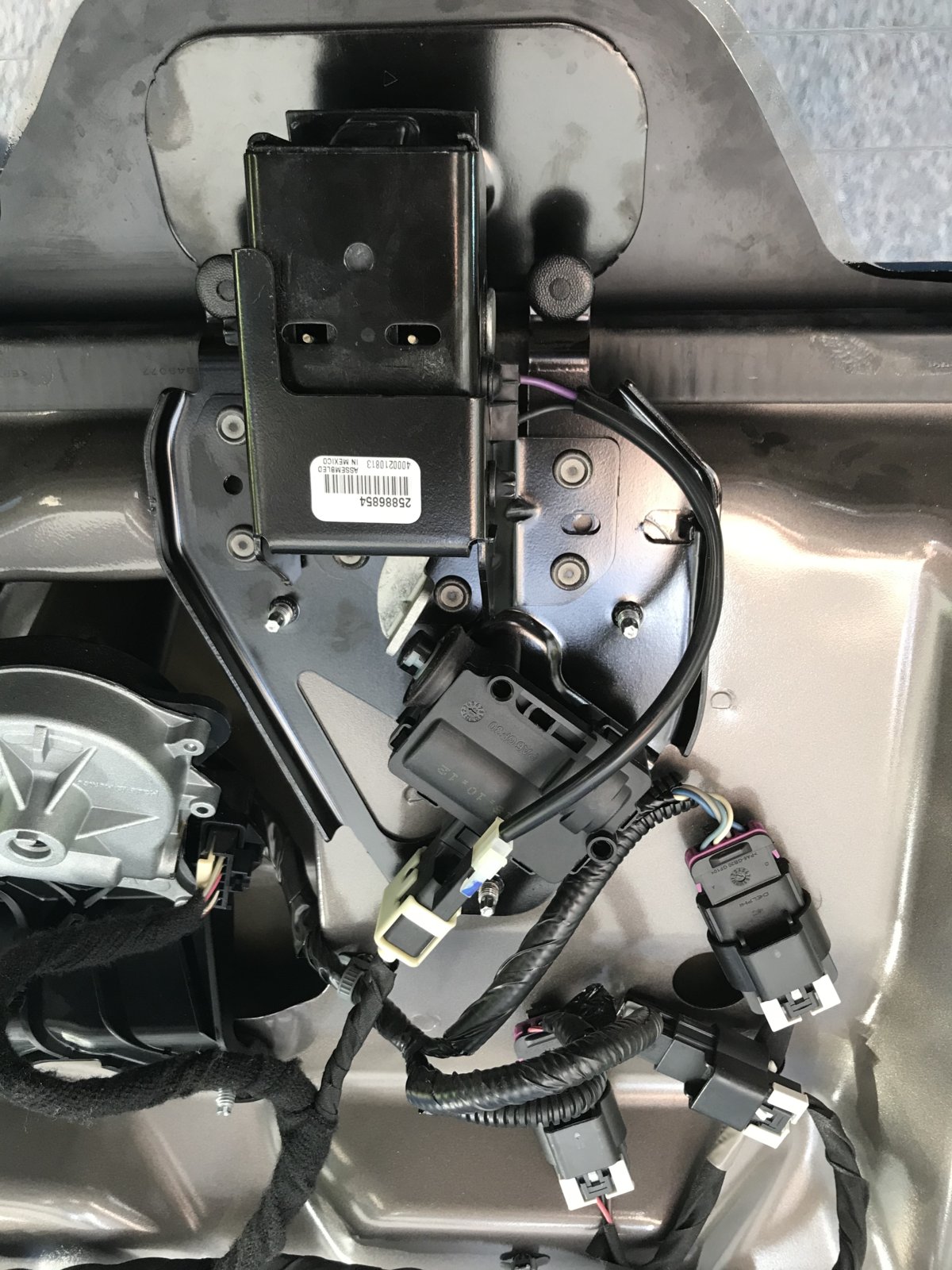

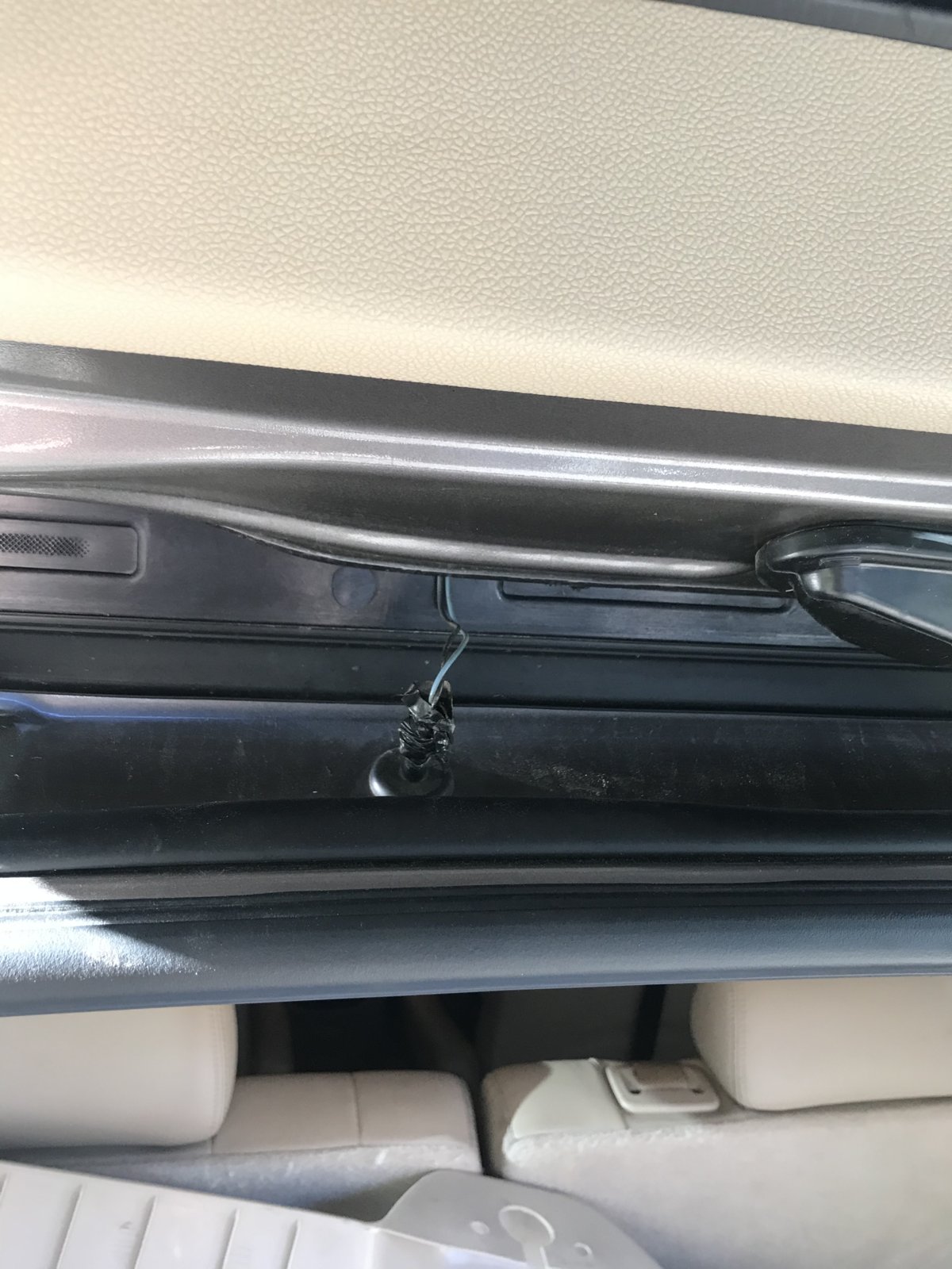

I took it all apart. I am assuming it is the little actuator but I’m not really sure how to get that portion off. It looks like it may have to come with the whole lock assembly ??? Also anyone have any idea what the two single blue and black wires are that are above the gate but not part of the harness?

Do you trouble code B3265? You need a good scan tool that can read BCM codes.
The BCM controls the liftgate actuator through the rear wiper motor control module.
It's probably just the actuator going bad. but could be short in wiring of some kind, a bad BCM (unlikely) or a bad rear wiper control module. If all the wires look good, are you good with a test lamp?

Thanks....is anyone familiar with how you take that whole assembly off? or is this done with the 3 that are some type of star tool and screw in backward?
I have never done it, but I would test from the actuator back to be sure that is indeed the problem, when you press the button the actuator should be getting power, if it is getting power then you know it is bad, if it is not getting power then keep going backwards until you find the source of the problem. once you are sure the actuator is bad order the replacement then that should give you a better idea of how it comes off.
