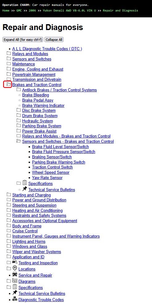

Are all four tires the same mfr. and size, and with the same tread depth? A scanner that can read -- ideally graph -- the wheel speeds would be helpful to rule out any differences in wheel speed.
If you can acquire a DTC while the Traction Control is disabled, that might help point you in the right direction. The scanner needs to be good enough to read the ABS codes, and brake codes should be "Cxxxx" codes. The DTC might also have snapshot data to list the various conditions that happened when it was triggered.
If you're interested in some diagnostic help, the link below will take you to your vehicle's specific info:
When you're there, you can back up using the links at the top of your browser. But here I've expanded a couple of categories:
Note the last two items, TSBs and Diagnostic Trouble Codes, which can be helpful if you can pull a code or two.
Good luck with it, and keep us informed about what you find.
