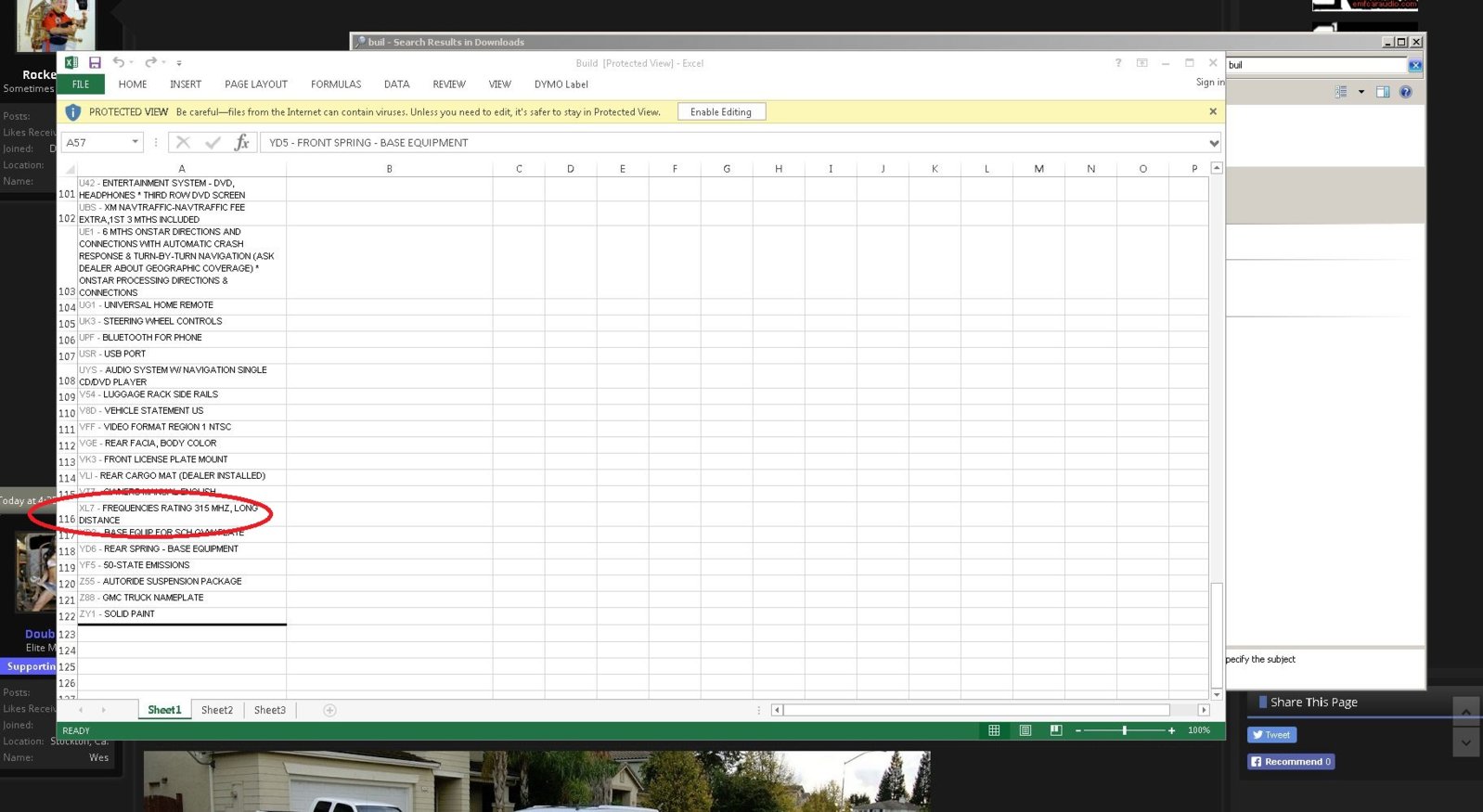

Hmmm my 08 Silverado has neither of those RPO’s. I just looked up the info on the new ones I just bought and it says they’re 315 MHz and the application chart says 08-18 Tahoe’s Silverados etc.

maybe its in your build sheet

The RPO on my '04 appears to be UJ6 (Low Tire Press Indicator), if I'm reading that right. 315 MHz.
uj6 I believe just means you have tpms, I think most of the older trucks are mostly 315mhz though anyway it probably would show in your build sheet the freq
