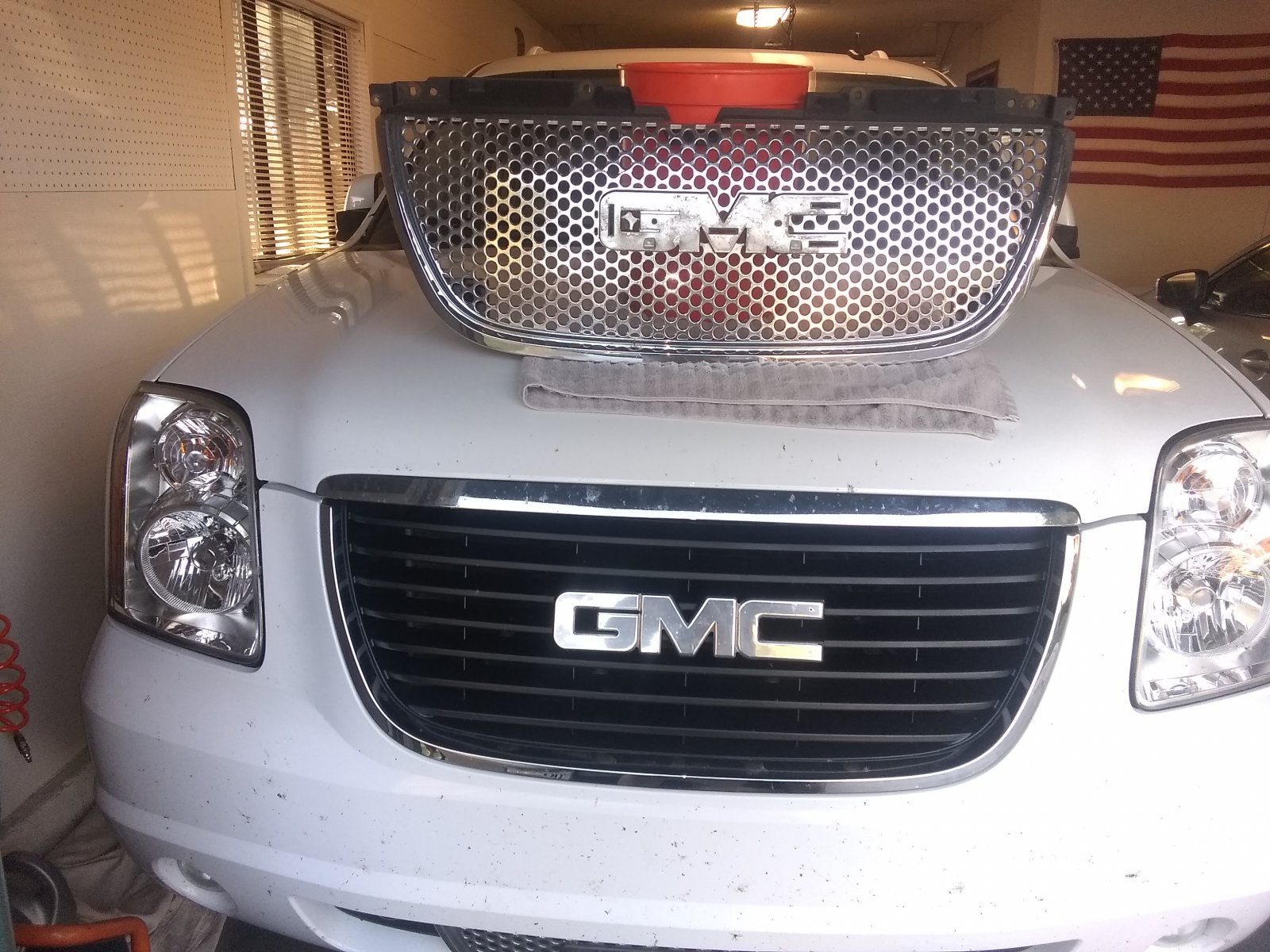

As for the grill, I'm guessing the Holy Grail grill has the round holes as mine has more of an oval hole in the chrome grill. Either way, my emblem is gone as yours was and I'm honestly thinking the black grill looks better. May give that a shot to see how temps do, but I likely won't tow my trailer again until Sep when I bring it back down from my property. By then temps will below the steady 95-100 that I was towing in last weekend and this weekend. Temps seem to climb when towing steady, even across relatively flat land, at higher speed, while once I drop into town it will quickly drop to the normal range I see when not towing.

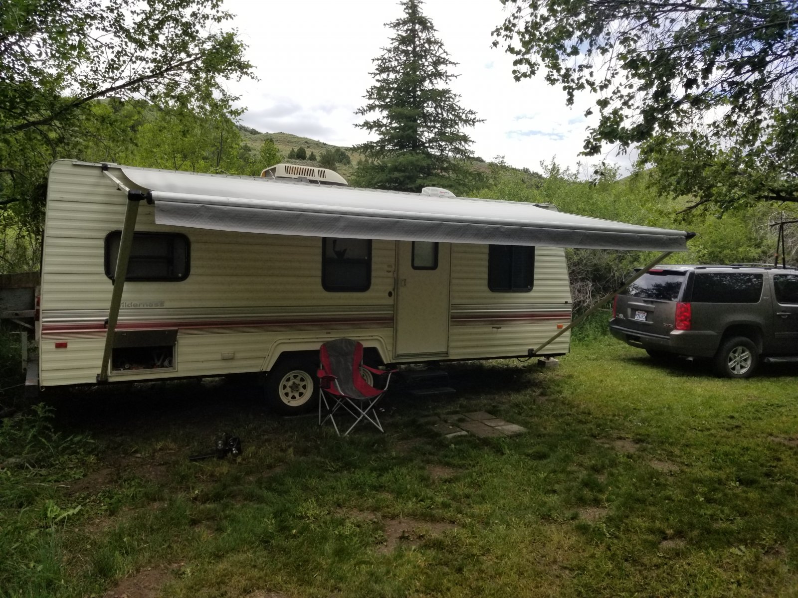

I managed to get a pic this weekend, not hooked up but gives a good idea.
Nice! You might just want to replace the radiator with those miles on it. DO NOT get an aftermarket radiator as they do not have the built in restrictors that keep the temperature in check.
