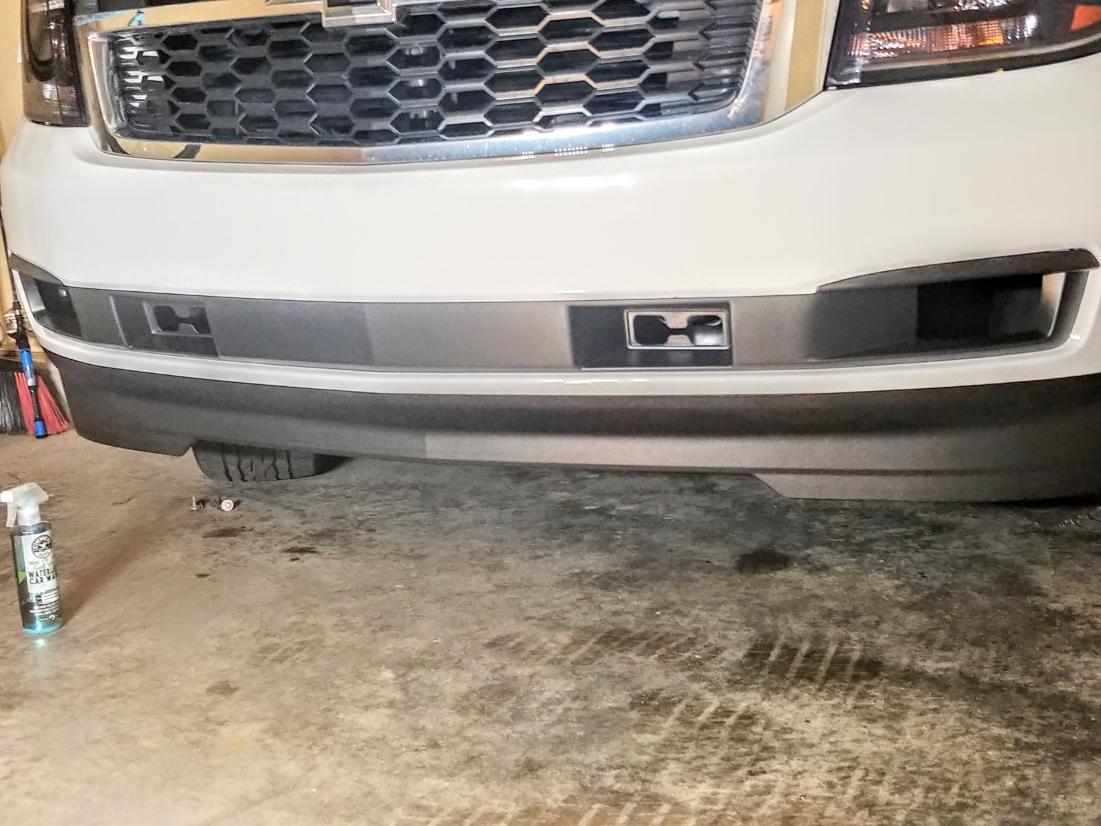

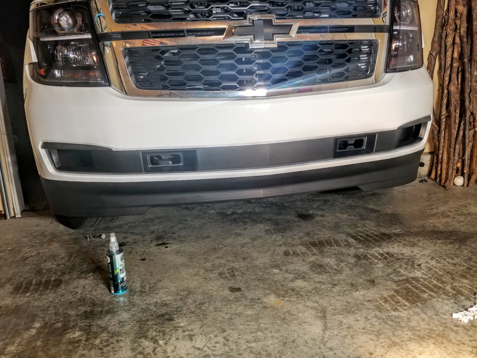

I'm sure this has been covered in previous threads, but wanted to share my experience installing the lower bumper fascia with the tow hook cut outs. My 2018 tahoe did not come with tow hooks or fog lights and I'd like to add both.
Fascia part number is 22936496
This was a pretty easy DIY once I figured out what needed to be done. There are 20 or so clips that must pop out on the under/back side. This is easily completed with your fingers and a flat head screw driver. Simply press in the tab and pry the clips out.
I found it necessary to release both front fender liners to access the left and right clips as well as remove the fog light delete brackets. I didn't completely remove the fender liner, I only removed the first five screws and two on the bottom so that I could pull them back enough to access the back of the fascia through the fender liner.
Once all the clips are removed and the fog delete panels (held on by four screws) the fascia can be pulled off with a little force.
All in all it took me about two hours. That was taking my time with a few beer breaks and ensuring I carefully removed all the clips to prevent breaking anything. If I had to do it again now, it would take me no longer than an hour.
Will be installing the fog lights and tow hooks next week.View attachment 214326 View attachment 214327
