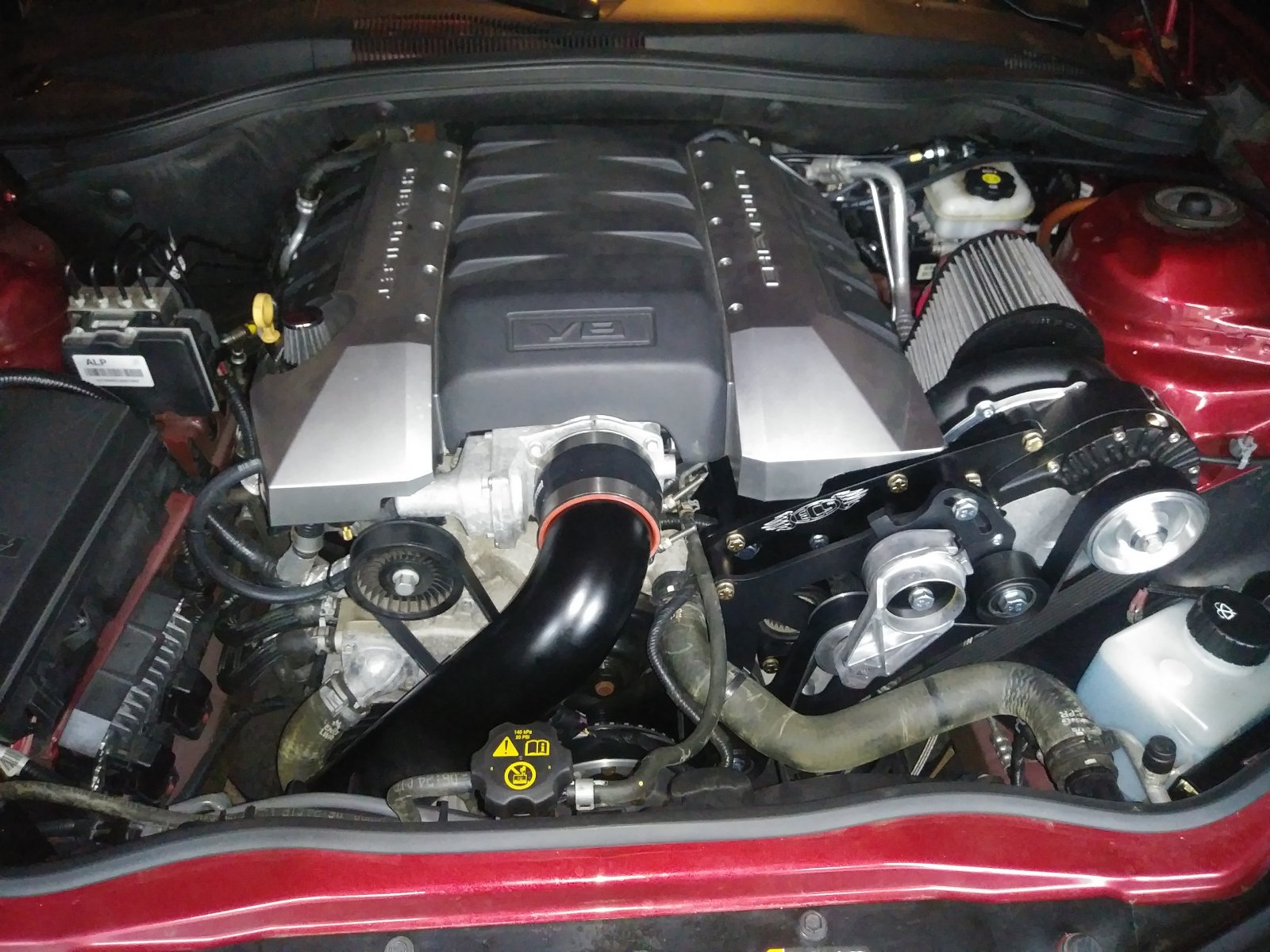

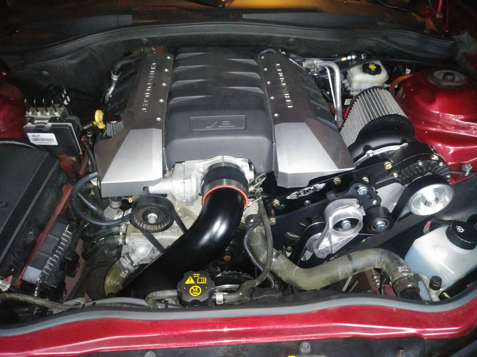

ive got the ECS procharger on my camaro. same deal just a different brand. ive also got a cam, and a 12% overdrive pulley for the blower. makes about 7 psi.
