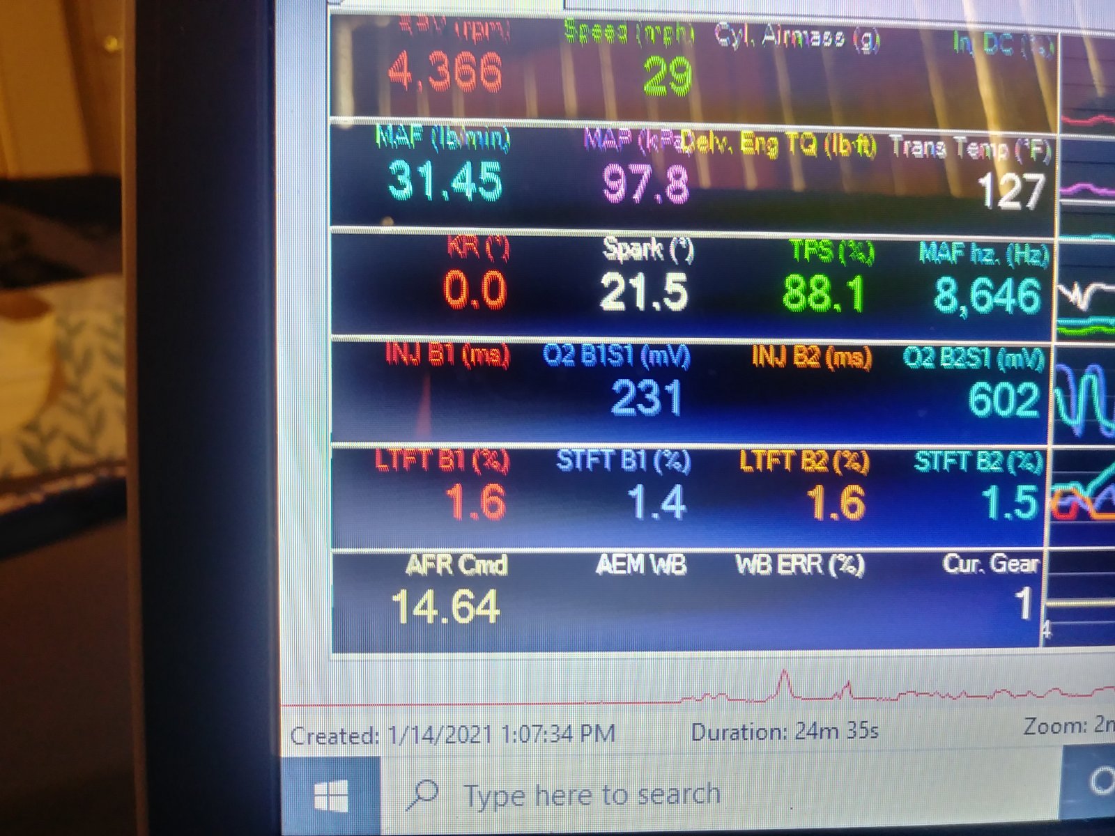

good lord im a dope let me see if i can find your scan it should show the commanded afr on it.
now what date was i there lol thats how they get saved, by date and time.....
Scottydoggs
Dec 16, 2017
2,760
4,216
NJ

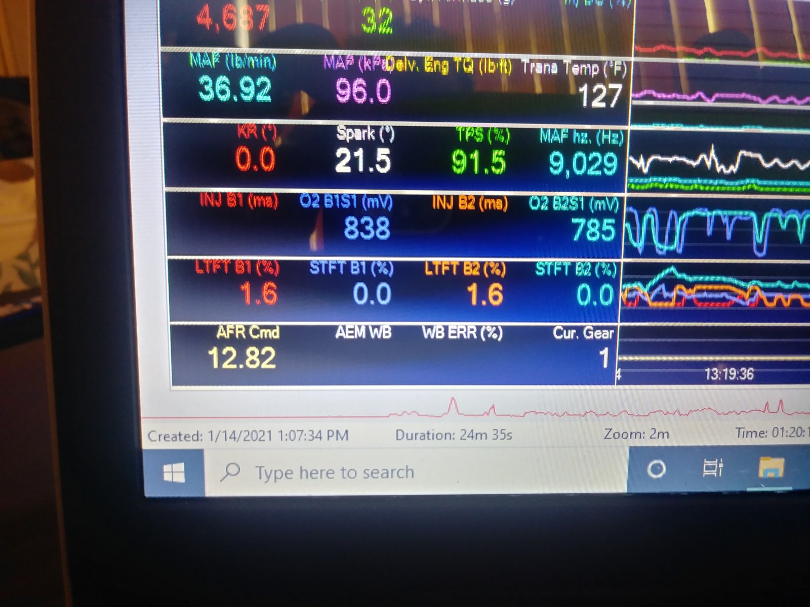

idle.
88 tp% still 14.6
dont drop till 91.5 tp% then it held there to 6000 rpm.
so in short, your tuner ****** you on a bit of performance. but pe is working as it should.
