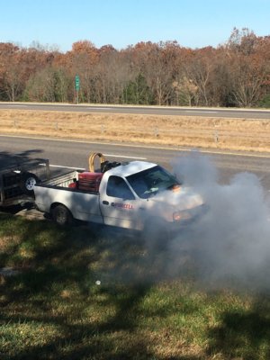

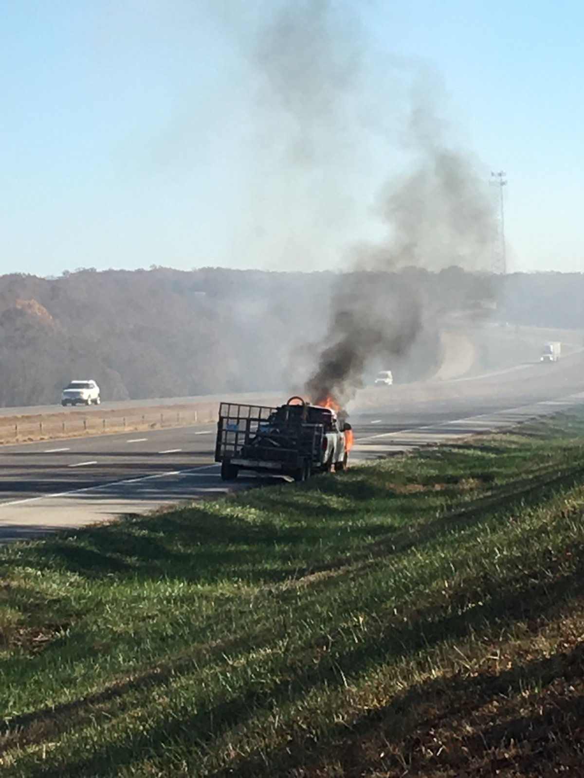

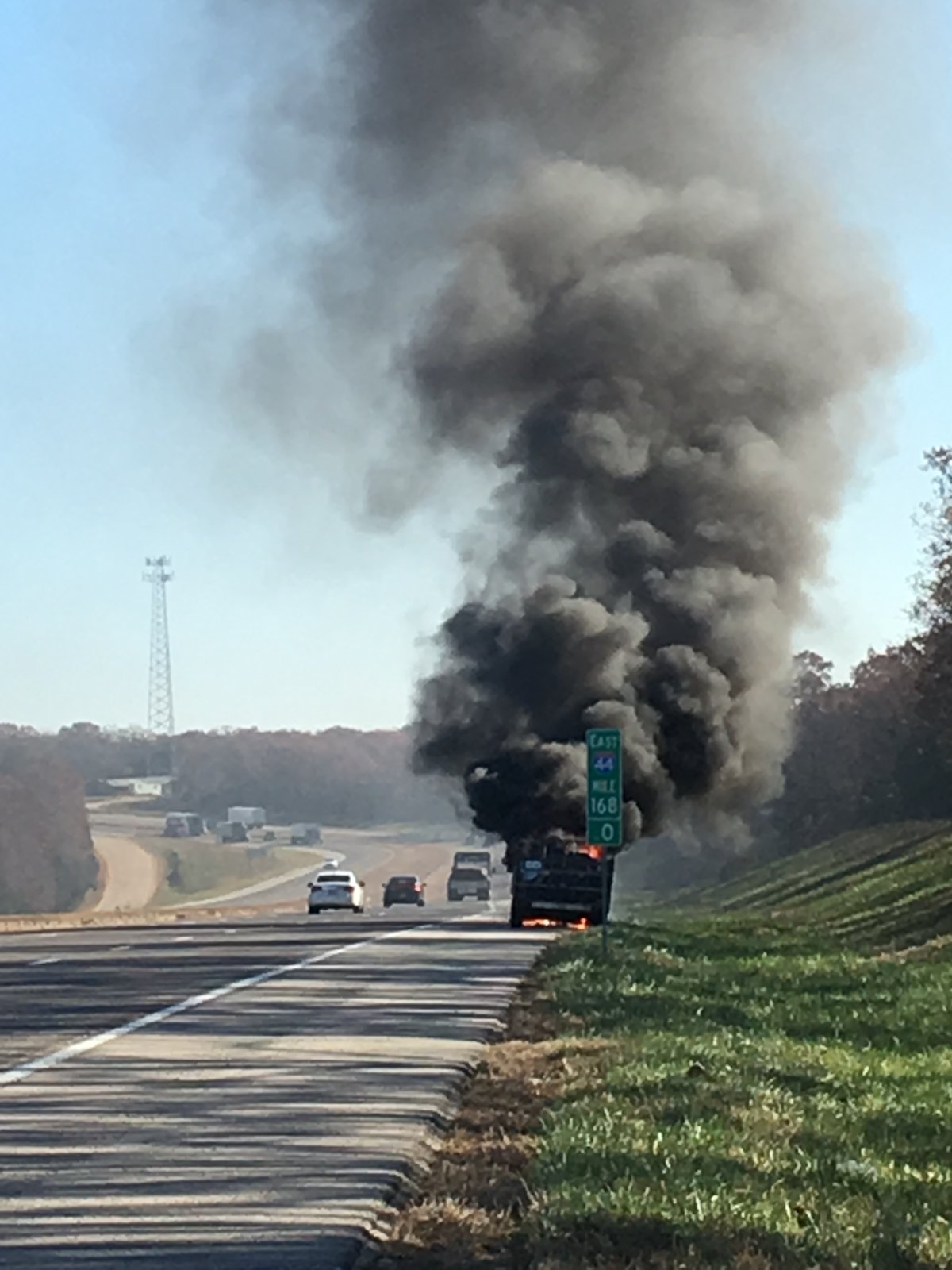

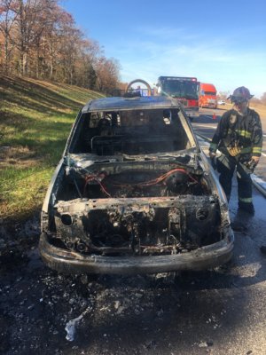

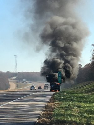

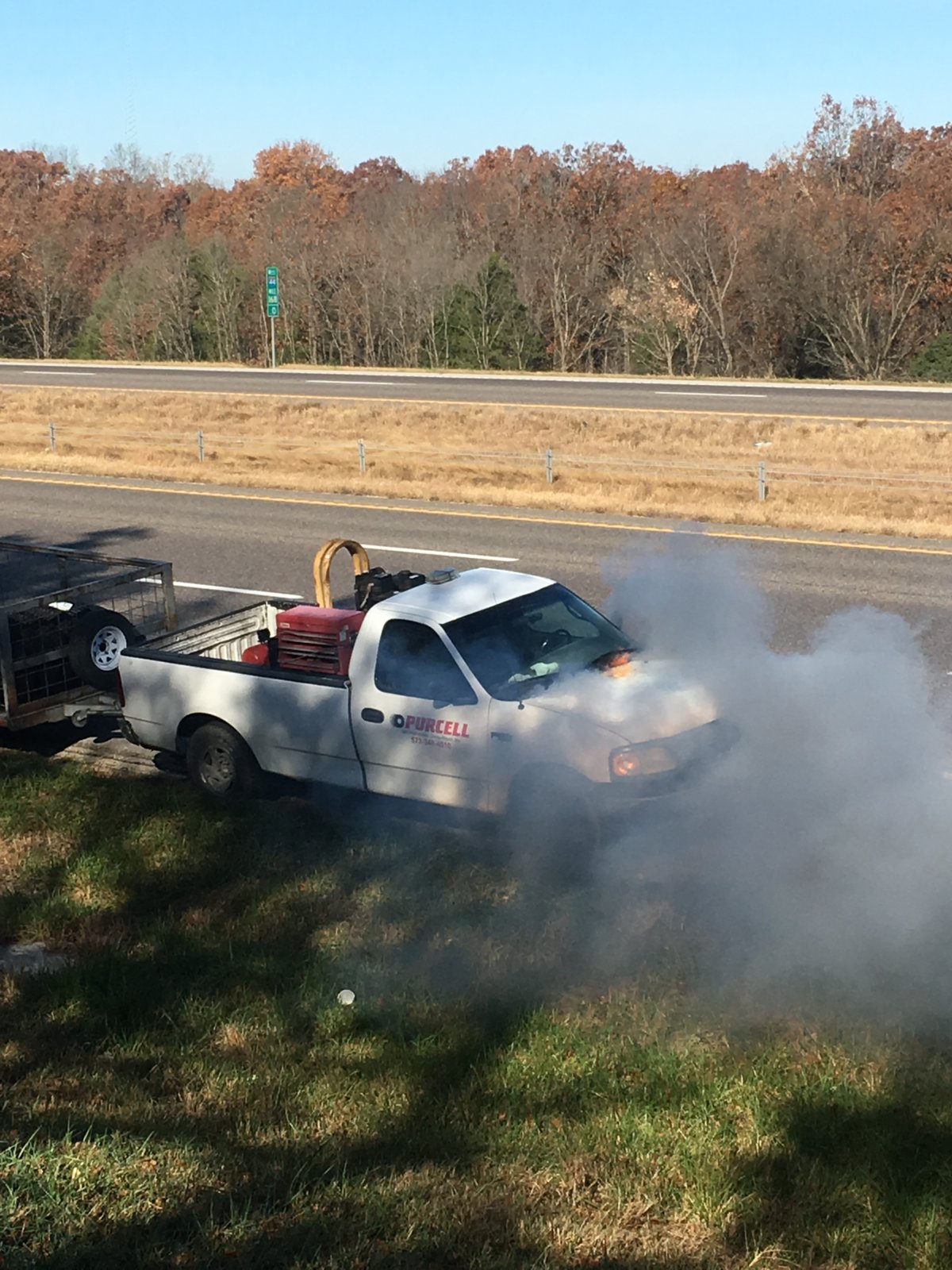

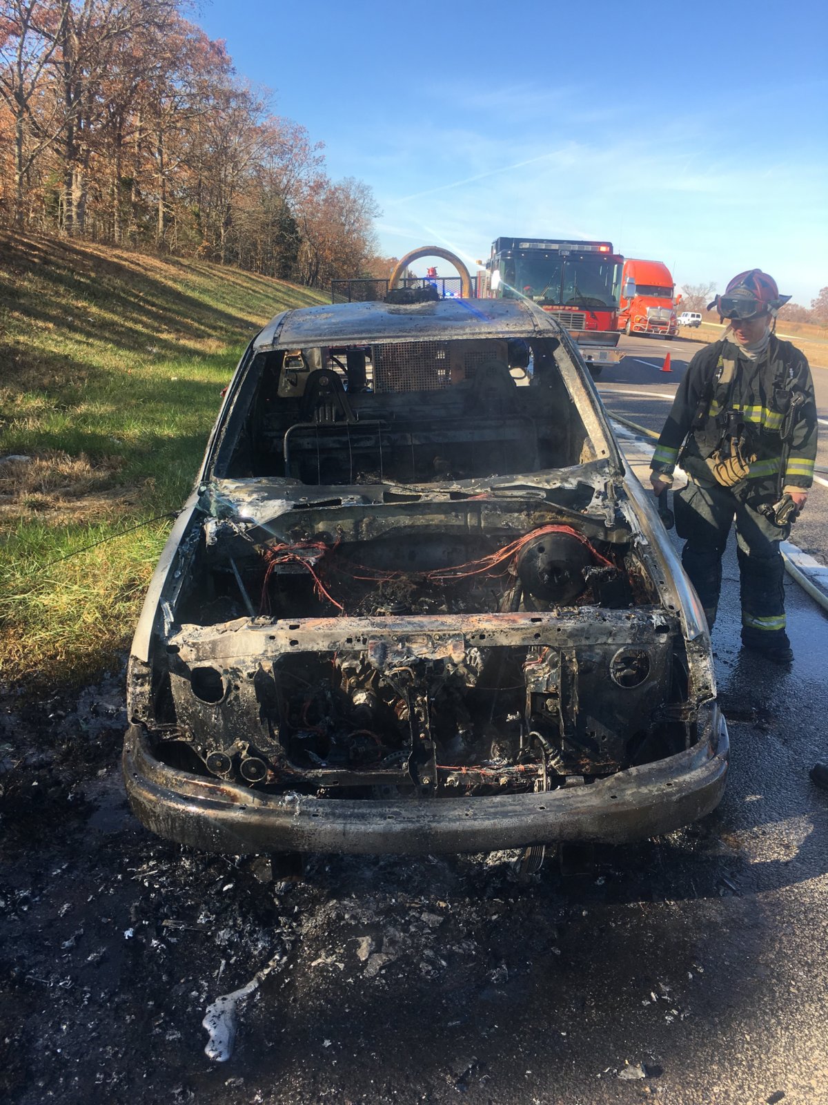

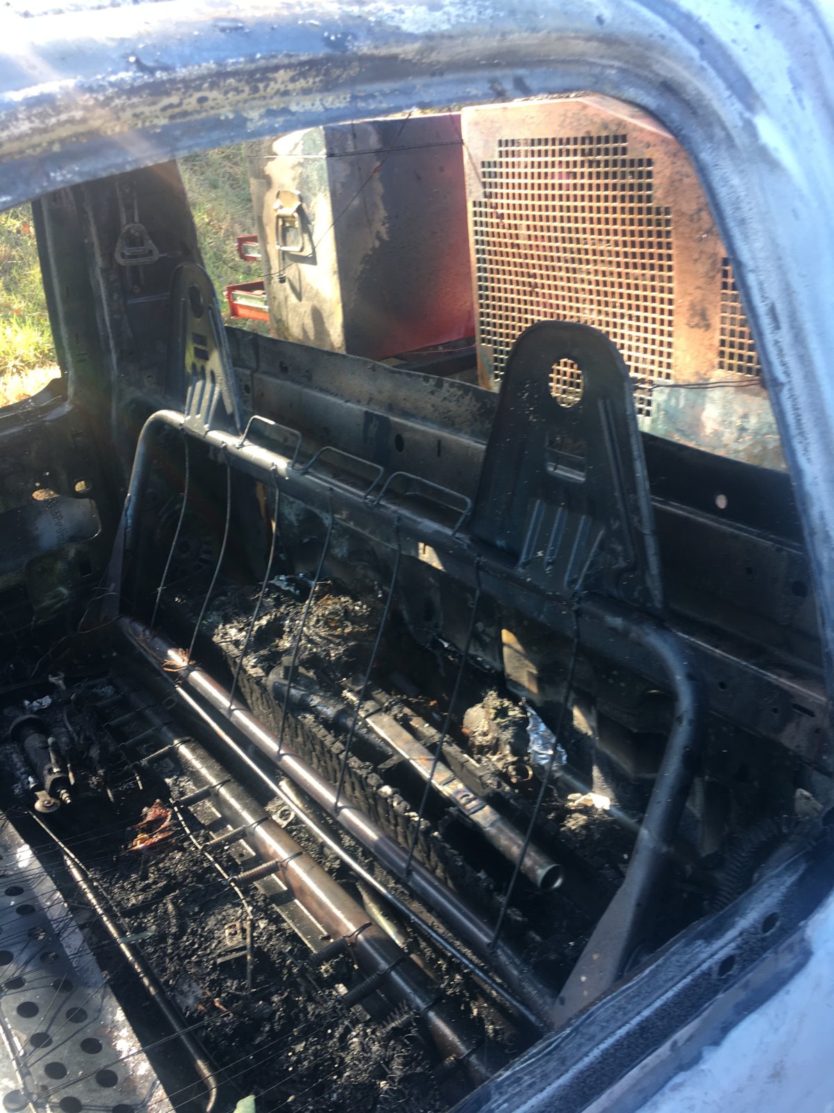

97 f-150 burnt to the ground after trans line blew while pulling a long hill. I'm sure manifolds were cherry red from overworking the little v6, lost all power, noticed the smoke, then upon pulling over it caught fire worse and ended up with just a shell. I have pics and vids....wanna see? ;)

B8607C43-C936-48CB-9D63-4F25A2606E87.jpeg 19C93CAB-ACF3-41B5-A9AD-92E7413BD2FE.jpeg AC993395-E1AA-4B3A-A794-450C01FF227A.jpeg 041B4994-C622-40F5-87F1-B333DFB70E54.jpeg C1C290D4-551B-4CBA-9162-2C414C636099.jpeg
Might have been something other than tranny fluid catching on fire. I'm telling you, I couldn't get it to burn using a torch so until a forensic tech shows me a report that a vehicle burned down because tranny fluid caught on fire, I'm not buying it.

hard to dispute when you pop the hood of a car on fire and see the trans line pissing all over and the flames getting higher.
be a non believer, its your right.

I stand corrected. You're right, pretty much anything will burn under the right conditions. I just read that even antifreeze mixed 50/50 will burn when vaporized by a hot 1000 degree manifold.
"Next tested was automatic transmission fluid. In the early 1990s General Motors experienced numerous fires in its full-sized trucks. Fires usually did not occur in normal usage, but under heavy loads, such as pulling trailers up hills, some transmissions expelled their fluid out onto hot exhaust components and caused fires. As a result, General Motors mailed new dipsticks to owners of these trucks. The new dipsticks had a plastic locking device designed to prevent the internal transmission fluid pressure from ejecting fluid up the dipstick tube and onto the right hand exhaust manifold directly below. Flammability of automatic transmission fluid was demonstrated in the tests by spraying transmission fluid onto the steel tubing, heated to approximately 1,000°F. The transmission fluid immediately flashed."
