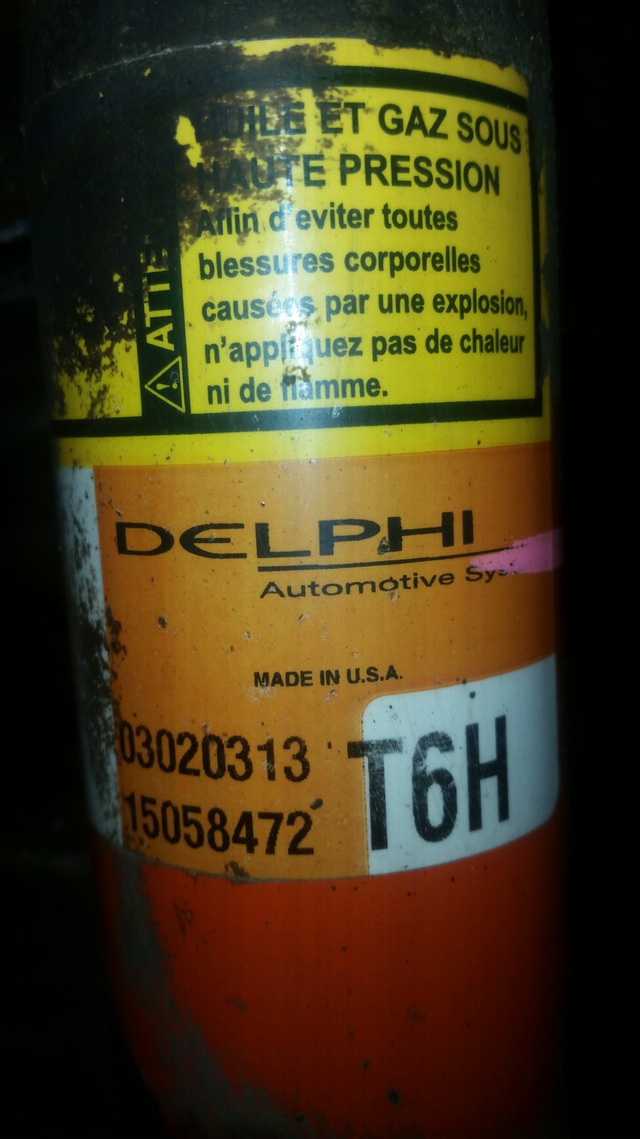

Swapped out my wheels. Checked under for bushings wear, any loose or damaged components. All checked out as I has assumed (hoped, previous 1 owner was pretty meticulous with this thing).
Front seemed to be getting a little rough lately as far as ride quality.
Wiped the struts to find oem gas shocks. Never replaced or rebuilt.
Question is rebuild them or buy some bilsteins? Monroe's? Belltechs?

Do you have autoride? If so then you could stay with acdelco oem (pricey) or Arnott equivalent reman'd shocks (less pricey) . Otherwise you could overide the autoride sensors and use Bilstein HD aftermarket shocks which seem to be popular. Sachs also makes a premium aftermarket shock. I have my front autoride sensors bypassed and use Monroe reflex monotubes

If you have auto ride Monroe makes the cheapest auto ride shocks if you want them to function like the factory setup, or ditch the auto ride and get Bilsteins but if you do that and you have auto ride you might want to swap out the rear springs if you have non auto ride I'd still say Bilstein

On my 01, non autoride hoe I remember swapping factory to bilstiens but to be honest.... i didnt feel any difference.... guess im not that sensitive to that stuff...i know the fronts were shot though, plowing and keys cranked all the way.... still rode pretty damn good tho....even lugging my plow around....

Anyway I do have autoride. I wasn't aware that it's all connected up front too. But the plan has always been to rip out the autoride (rear) anyway.
