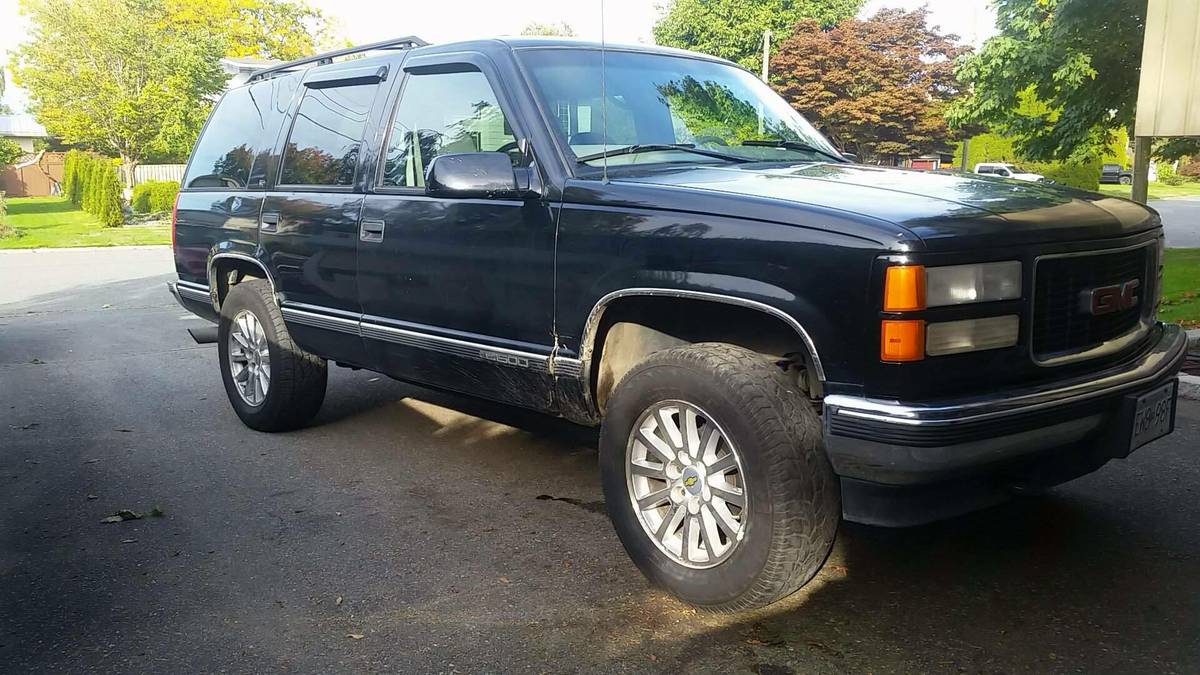

I recently bought a 1997 Yukon with a 2" lift. Someone threw on some Chev 18" wheels at some point, and currently there's 265/65/18s on them. No rub at all and full wheel lock is fine. The tires are fairly bald and it's snow time, so I found a great deal on some used BFG KOs with 80% left. They are 285/65/18. I don't know what offset the wheels are and same with any spacer. I did find an example of the wheel online, but it was just a photo with no specs. I assume it's off a later model Chev. Think the 285s will fit?

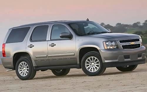

they look like 2007-14 Tahoe Hybrid wheels

I think you are probably correct. Thanks.
Picked off the info for them here:
https://www.wheel-size.com/size/chevrolet/tahoe/2007/
8" width with a 31 offset
Seems like my year of Yukon came with a 265/65/17 7.5" width and a 31 offset. I can see how the current 265/65/18s could easily fit, even with no lift.
With my 2" lift and 8" width wheel, would going to a 285 tire cause rub etc?

A side note is I crawled under it today and took a look. Just 2" blocks on the back, and no cranking up front. Guess it looks lifted because of the 18" wheels. Took some measurements when fully turned each way. Could probably just make the 285s fit with no surgery. But my go to lift shop said bring him a coffee and he'll crank the forks for free.
