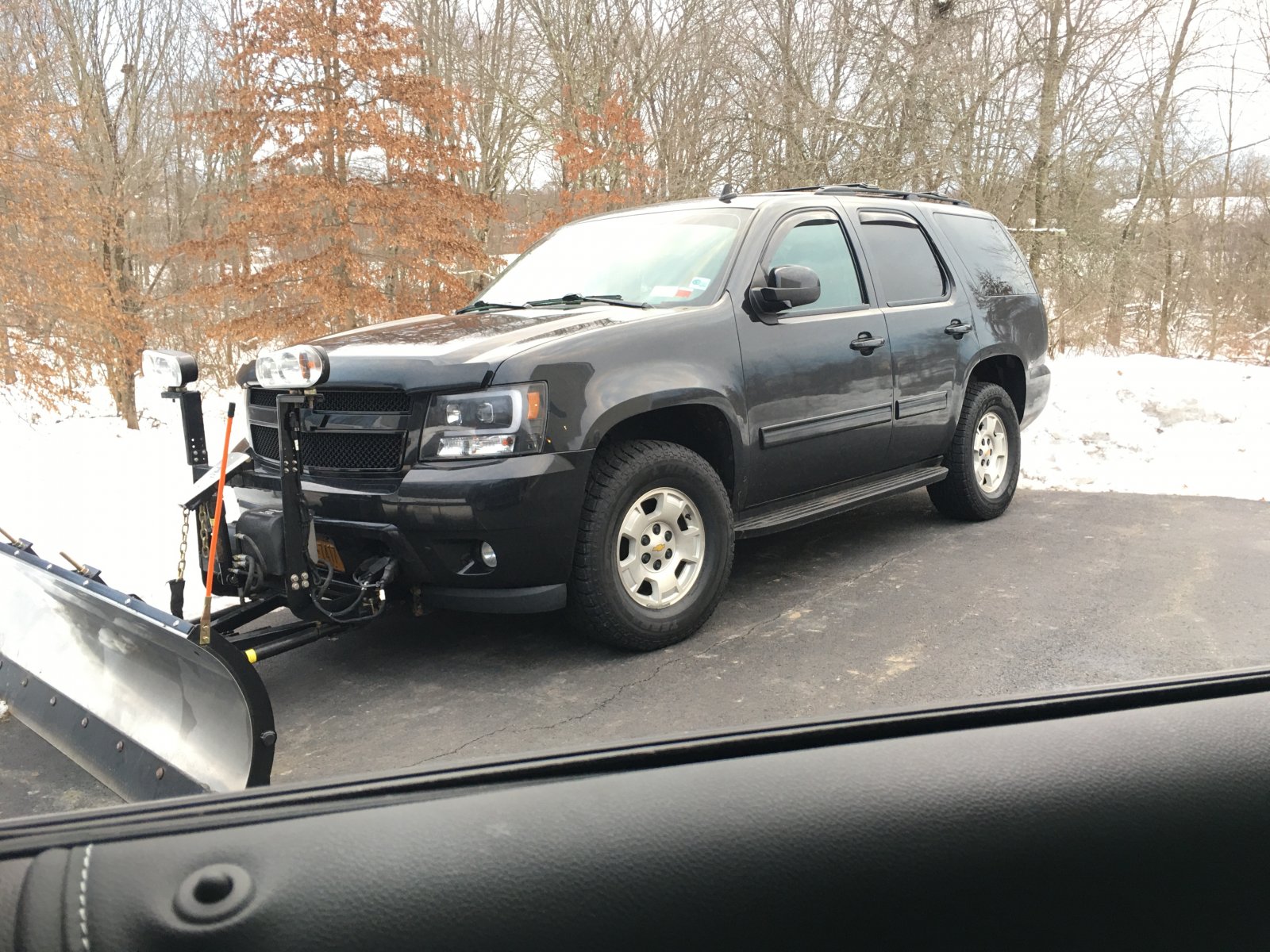

I did get 285/70/17 and a leveling kit but that’s probably about as big as I would go...

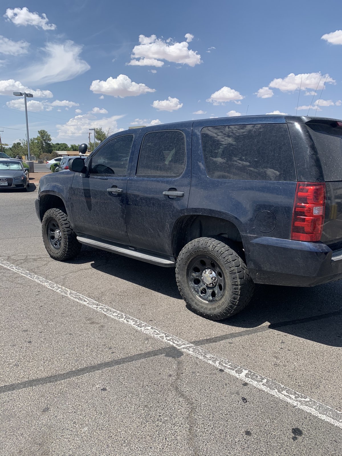

285/70/17
2” level
Rub on passenger side, full lock, in reverse only.
Nitto’s have a more aggressive tread than the tires I have so you may need more than just a level.
