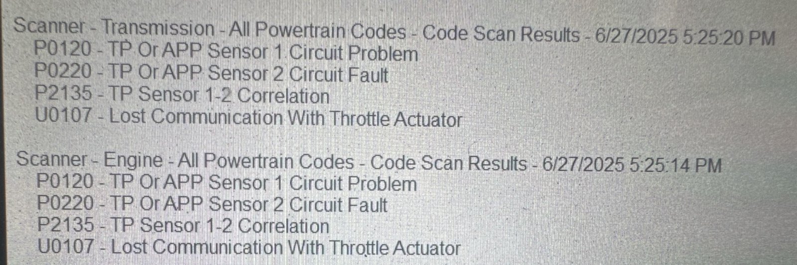

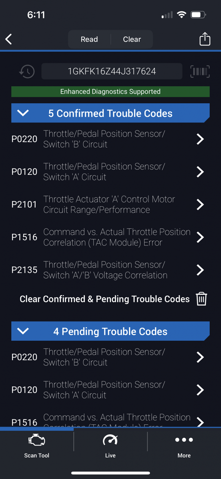

2004 Yukon 5.3
I have attached a picture with the codes. I will have a scan tool with live data tomorrow, but for now I only have a code reader.
